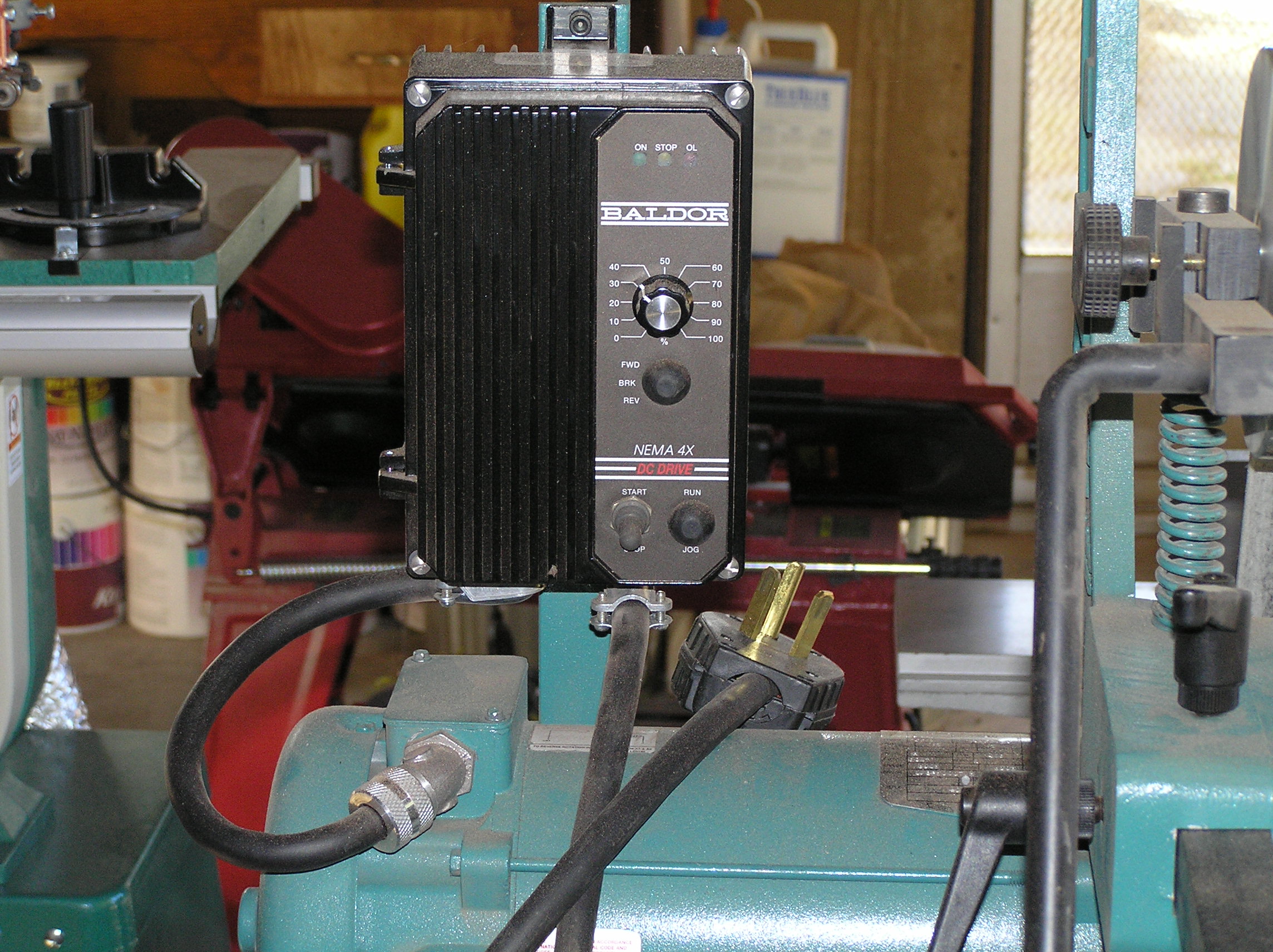

I'm kinda partial to my Bader III, 220v 2hp with the DC variable speed control. It may be pricey but that variable speed control is a real nice thing to have whatever brand you have. I have 2 flat platens, 14, 10, 8, 6, and 4 inch wheels, and a small wheel fork attachment. Pictures are of the large flat platen and one with the small wheel fork attachment with a 1/2 inch wheel on it. Also a picture of the DC variable speed control made by Baldor.
I have not used it much lately because of a couple medical issues but I'm hoping that those will clear up. ::paranoid:: ::paranoid::
