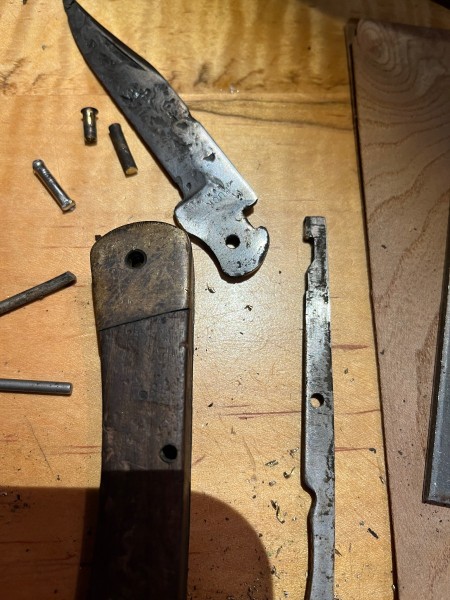

Made some good progress tonight. Donor knife is a 110 Lite.
I am amazed at how consistent Buck has been with these. While there are definite differences between the old spring and the new one, the pin placement has not really changed. The spring bars are both 3/32” thick rod, and they are almost the same length. Blade thicknesses are both just a hair shy of 1/8”.
The older spring is much flatter along the back side, slightly more shallow in profile, and doesn’t have as much of an overall curve.
The main rivet on the old knife is odd, not sure how they did these. On both sides of the bolsters, you could see an obvious 3/16” rivet profile. I center punched it and went all the way through with a 3/32”. Then, I came back on one side and drilled a 1/4” down (just to the blade) with an 11/64” drill. This effectively broke the pin, and I was able to shimmy the blade off the stud and then push the rest of the rivet out the other side. Oddly, the hole in the old blade tang is only 1/8”; no copper bushing. On the side I didn’t drill through, it appears to be countersunk with a roughly 3/16” wide head, but the rivet diameter where it goes through the blade is 1/8”. Would really like to know how they did this. Could have been a stepped tapered pin?
The blade pivot hole on the new blade is 7/32” without the bushing. I think what I’m going to need to do at this point is drill through the old frame at this point with a 7/32” in the drill press, and mount the new blade with no bushing. As long as I counter sink the hole a little and peen it over enough, it shouldn’t be too visible, esp after it tarnishes a bit.
I test fit everything with temporary rivets and the new blade and spring and lock bar seem to function fine. Lock up is fine. The new spring is a little proud of the frame along the back, so when it’s all peened back together I will have to hit it with the belt sander and level everything out. The newer frames have a wider butt end, so I will also need to monkey with the blade kick a little to get it sitting right in the frame. I may even need to shave the factory edge back 1/16” or so and regrind the main bevel. This wouldn’t hurt aesthetically as the newer blades are wider than the old ones anyway, a little more narrow from edge to spine won’t hurt it.
As much as I’d like to leave all the patina and grime, I’d really like to find out how to get the butt end apart and re-rivet the handle scales in place. All four pins are falling inwards towards the spring. I might try shimming the interior and re-peening these rivets as a work around for taking it fully apart, but I’d also like to have a closer look at the integral lock bar holder. I’m going to keep researching this, but if anyone else has ideas about the butt end let me know. It doesn’t appear to be pinned with two pins all the way through like the modern ones are.
I’m including some pictures below.

You are correct on the lock-up differences between the older ones and the newer ones. The old spring will not work with the new blade or viseversa. The older one’s lock profile is more rectangular and deeper than the newer ones. Even 110s from the 80’s look more like the modern ones; shorter and more square.dsutton24 wrote: ↑Thu Mar 16, 2023 12:22 am Some of those knives had posts that were cast as part of one of the butt halves, and the posts fit into holes in the other butt half. Some were pinned in the conventional manner. You can probably tell which you have if you polish the butt. If yours is one of those that has the posts cast into one of the butt halves you can always drill through and pin the knife back together.
As one of my colleagues mentioned above the blades in the Lites are tumbled, they and can vary some in dimension. If the Lite blade is a little thinner than the original blade it's an easy matter to adjust the thickness of the spacer, and just use the Lite lock bar.
I don't remember particulars, but I think the lock / tang / pivot geometry changed over the years. You may have to move the pivot to make it all work. I don't know if the tang on the Lites is the same as the 110.
Blade and spring thickness are identical in my calipers, hard to believe, right? I with have to check again tomorrow with my micrometer, but it’s close enough to work right.
Luckily, I won’t have to move the pivot holes, but I will have to compensate with a larger pivot pin and forgo the bushing when I put it back together. That doesn’t bother me too much.
I am leaning towards drilling the butt end apart, but I would prefer not to. However, if I have I can’t re-pin the scales with the knife semi-assembled, I will have to take it apart.
Thanks for the info - stay tuned -

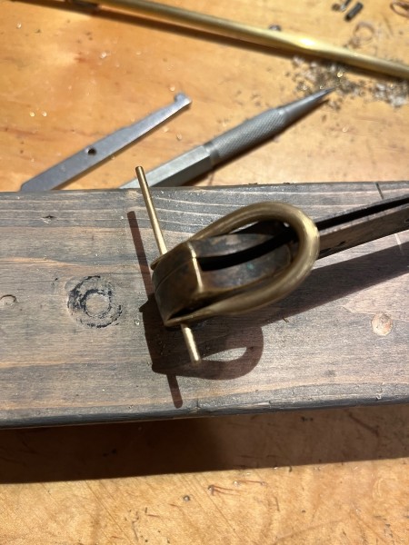

Here are some update photos. I’ve always wanted to see what these integral spring holders looked like.
Oddly the scales seemed original and were still pinned to the frames. I knocked the pins out because I want to re-pin them (they were loose). It looks like there was a thin epoxy used in the original assembly, can anyone confirm? It looks almost like JB Weld.
In the end, I plan to make a brass bail for this knife.
Walleye
- Posts: 93
- Joined: Thu Oct 13, 2022 3:38 am
Re: Repairing a badly beat up vintage Buck 110
I cleaned up the handle plates with a brass wire brush, and have reattached the original wood scales with JB Weld and brass pins.
I made a bail out of brass, and I drilled a 5/64” hole between the two bottom rivets and below the lock bar holder. The idea is that it could fold up against the back handle when in use and not interfere with the lock release.
I drilled out the pivot rivet to 7/32” to accommodate a modern blade without the copper bushing. I would have preferred to use the bushing, but after drilling out the original rivet the hole needed to be open wider than 1/8”, so I didn’t really have a choice. While brass on steel isn’t ideal, the thickness of this rivet should add some sturdiness at the least.
Waiting for 1/8” brass pin stock to come in the mail so I can reassemble it.

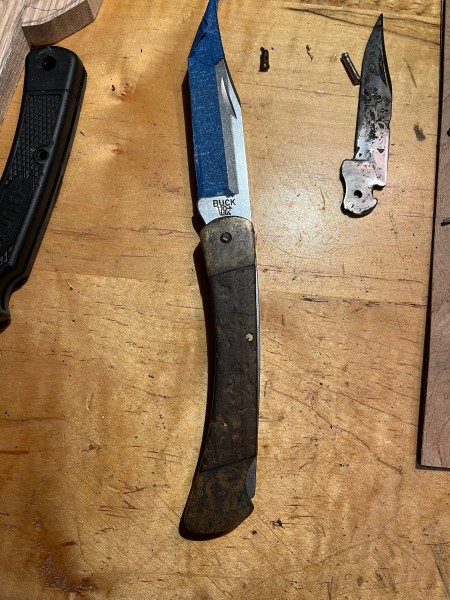

Here is an update on this project. I’ve got blade/spring modified to work with the older frame. Note the blade kick has more of a curved slip joint look to it, but it works fine.
I’ve got the handles pinned on and I’ve started to clean up the frame profiles. These older Buck castings were not as accurate as the modern ones. The insides surfaces are more rough, but it all still works. The handles still retain a lot of the original damage and wear but they have at least been cleaned up and oiled. I’m not going to try to get all the damage fixed, I like it the way it is.
I’ve got it test fit up with some 1/8” stainless screw bolts - a must have for anyone who plans to disassemble or customize Buck 110s.
At this point it’s ready for pinning and final finishing.

Finally wrapped this project up.
Here are some of the pre-assembly and post-polish photos:
