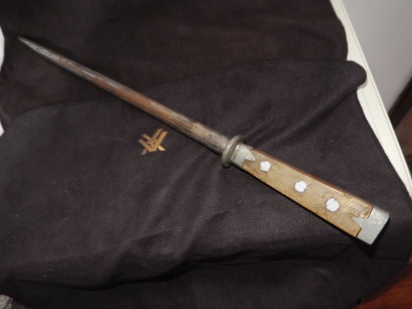

found this old steel
robpa
- Posts: 851
- Joined: Sat Mar 06, 2021 12:17 am
- Location: N.W. PA.
it appears to be pretty old? handles are bone, steel is not very round, lots of dips and swells, quite smooth. really does a nice job on a knife. felt good about the 8 bucks I gave for it.
- FRJ
- Posts: 17143
- Location: Ct.
- treefarmer
- Posts: 15167
Re: found this old steel
robpa, does it have a name on it? Seem like most steels have round handles, that one is really unique!

- philco
- Posts: 15546
I'll agree it looks old. Reminds me of some old time table ware I've seen. I have a no name steel my uncle gave me year ago. It works wonders on my kitchen cutlery. I've had it for years and wouldn't take a share in the railroad for it.

robpa
- Posts: 851
Not a mark on it anywhere. My grand dad was a butcher and in his meat shop were a lot of what Id call goodies today. I used to go one day a week and cut meat, mostly trimmed out parts to make ground beef or pork sausage. Used to go to the packing plants and watch the process from kill floor to finished products. What I recall most was the size of the cleavers used on the kill floor, HUGE. And all the steels hanging from the guys belts, which were in constant use.
- btrwtr
- Posts: 5486
Very cool old steel. Are you sure the handles are bone, they look like water buffalo horn.
Wayne
Wayne

robpa
- Posts: 851
The handles are bone, not horn. The butchers at the packing plants carried their steels on their belts and used them fast and often. Those guys could really weild a knife.My grand dad and uncle kept their steels in a notch in the butcher blocks and placed the end on the block and stroked down to whet. They used to take their knives to a guy for sharpening periodicly. I recall his name was Heinz Panzeroff who they called heinie Pants off! He had a nice side hustle sharpening lots of knives.
I use my truck window often to hone, roll the window down and stroke on the pane edge, works pretty good.
