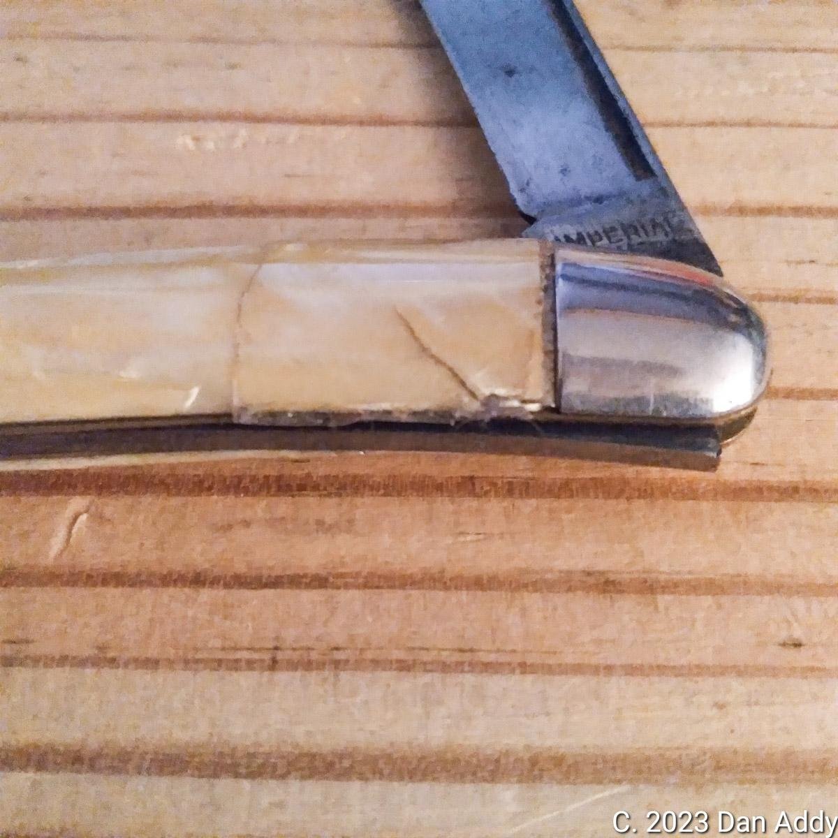

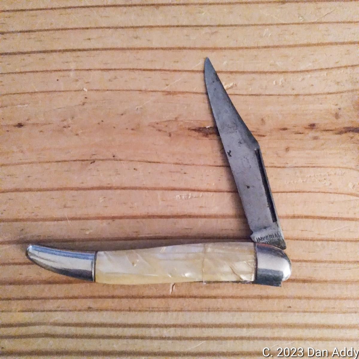

I did a search and didn't find any topics that 100% addressed my questions. That said, I have this Imperial toothpick:
A chunk of the mark side cover worked itself free. A better look:
I've wanted to put new covers on it from the moment I got it in-hand. Having given it a better look, the pins neither look nor feel like they were put through the covers. It looks like the only pin that would go through the covers is the one securing the spring. Hopefully the below photo does an okay job showing the pile side of the pin (the pin is much more well hidden on the mark side):
It looks like all I'd have to do is remove the old covers, cut and shape new ones, and epoxy them on. Or am I missing something? I know it's possible to convert them to more conventional construction, but I'll save that particular endeavor for a later time. Working with the existing covers would also be a viable option, provided they're not celluloid.
Thanks to all who provide help!

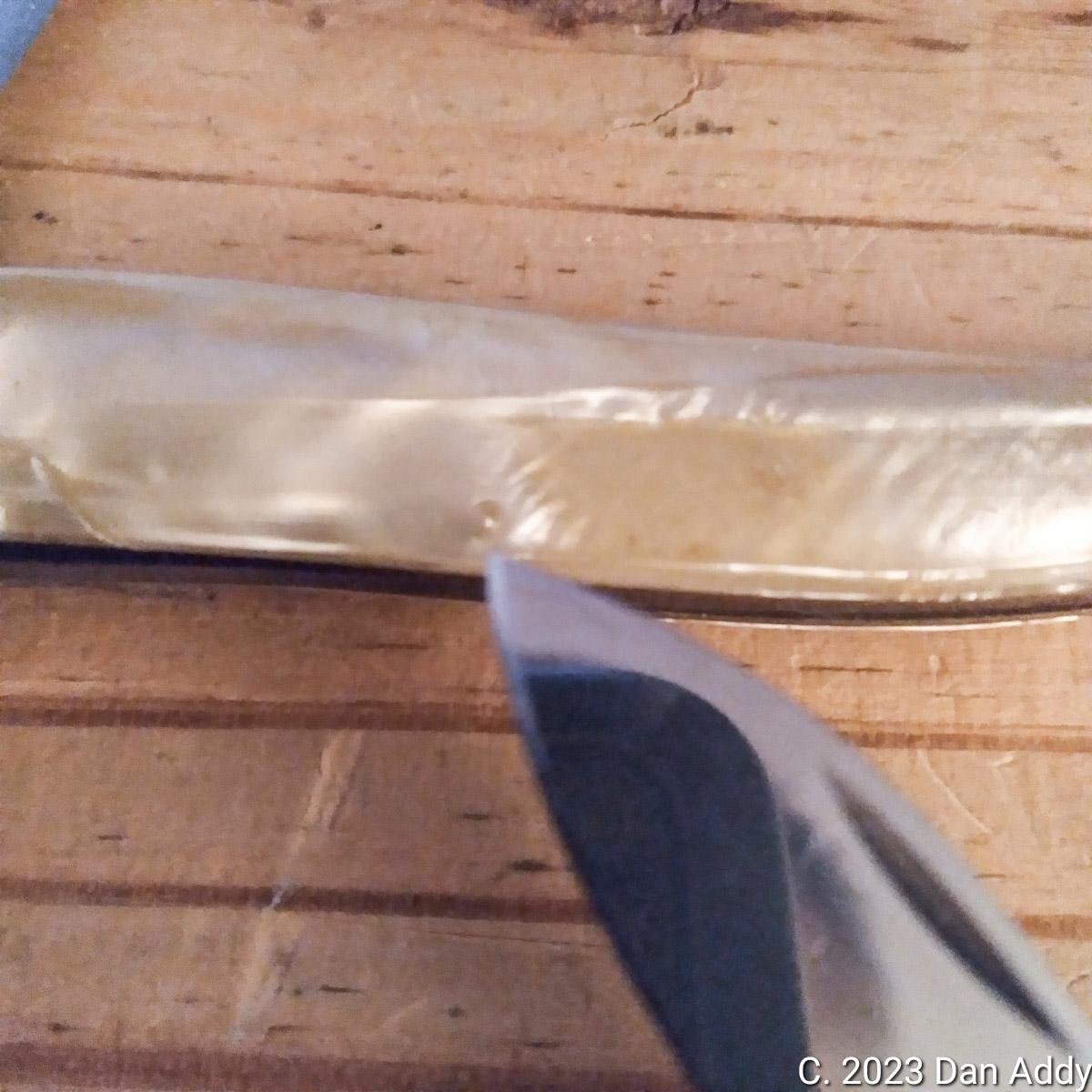

Dan I just did one not too long ago and I covered the pin through the spring and the end pins are just there for looks. They are not holding the scales on and the scales were epoxied in place.Dan In MI wrote: ↑Wed Jan 18, 2023 6:36 pm I did a search and didn't find any topics that 100% addressed my questions. That said, I have this Imperial toothpick:

If it is a shell handle knife, you should see tabs bent over to hold the shell covers on when looking at the ends of the knife on Imperials. Some Colonials used tabs inside the liners which were bent over to fasten the shell handles on. You wont be able to remove just the covers, the covers and bolsters are all one piece. Shell handle knives do not have pins coming thru the handle material, the pins are underneath the shell covers.

Olde Cutler is correct. There are no visible pins on that knife.
The shell covers are celluloid, and they were heat-fitted to the handles. I can replace them, but it's a very involved and expensive process.
If you must take them off, about your only option is to use paint to replace them.

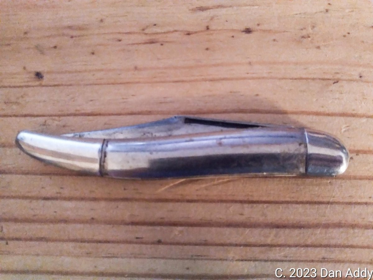

I went ahead and did the burn test. They were indeed celluloid. Being a potentially self-destructive material that wasn't in good condition, it's got to go.
Below is a photo of the mark side after I got most of the cover stripped off. Luckily there doesn't seem to be any serious damage.
Now I have to figure out how to best remove the old stuff (the wrap on the pile side is putting up a fight) and determine if celluloid was used on Imperial shell knives between 1956 and 1988.
