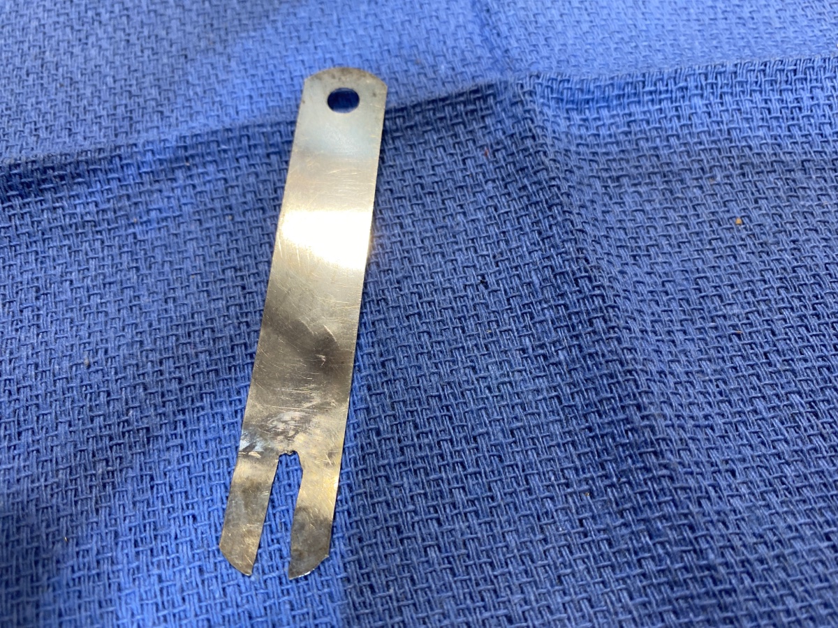

Ron, there are a number of factors involved with the problem you are asking about. But, first, what Jeff said. I find that you have to use slackeners when peening the bolster pins. The amount of peening required to get the pin heads to "squash out" to adequately and completely fill the bolster holes will create too much pressure on the blade tangs unless you use the slackeners. Second, make sure you are getting all the "mating" surfaces that will rub on each other clean, flush and very smooth. I use very fine sandpaper on all of the blade tang and liner surfaces that are going to be in touch with each other before you reassemble a knife. I like to think of it as "smooth on smooth". I hope this makes sense.

Sure. Here’s a post with some pictures and additional information. https://www.allaboutpocketknives.com/k ... er#p638182

Just buy a cheap set of feeler gauges and modify the ends with tinsnips to turn them into slackeners. I generally use the .007 and .008 on smaller and medium knives and the .009 and .010 ones on larger knives. Make sure that you taper the bolster holes and use the correct size pin stock for the knife that you are working on.Eelephant wrote: ↑Fri Dec 09, 2022 12:42 pmCould you provide further details on this “slackener”? What is it/are they? Where does one get one? Googling, searching on Janet’s, etc.., isn’t turning anything up. Thank you!Jeffinn wrote: ↑Thu Dec 08, 2022 6:26 pm If your new handle pieces aren’t perfectly flat you could be distorting the liners when putting the new scales on. I’m assuming that you’re installing the handles on an assembled knife (not disassembling the knife to install the handles).

Your feeler guage is too thin IMHO on a trapper I use either .007 or .008. Also if you leave too much pin material sticking out when yku peen it will warp that end of the knife slightly.RonP wrote: ↑Thu Dec 08, 2022 11:20 pm I only epoxy the scales on bolster are soldered on at Case factory I put tiny small dot sticker over the holes to try and prevent epoxy getting through holes usually does a good job. You have me pondering on flatness most of what I have issues with is stablized wood I flatten the back side by running through a drum sande or sometimes on a 12" disk sander so I think they are flat but worth re-checking. sometime I do take the knife apart and peen the handles and a .003 feeler gauge has worked well for spacing on the blade and liners. Thanks for the help.
Also if you peen the spring pin too tight it will cause your problem. I know sounds crazy but it will. Don’t ask how I know.

Instead of using a razor blade to open up the tight bolsters, I use a liner from an old pocket knife. I can sand it down if I need to to thin it a little bit, but being brass it doesn't tend to scratch the liner or the blade. I have even tapped the liner in between the blade and the outside liner. I will also close the blade with the extra liner wedged between the liner and the blade. That usually cures the problem. If you're having trouble with your pivot pins recessing when you do that, then adjust your walk and talk before you sand your pens flush. That way you're not pulling the pin down inside after you have the proper tension set.
I agree with the others, if you're using a slacker I almost always use an .008" slacker.
