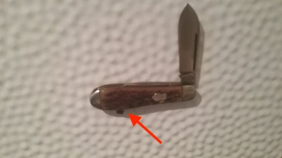

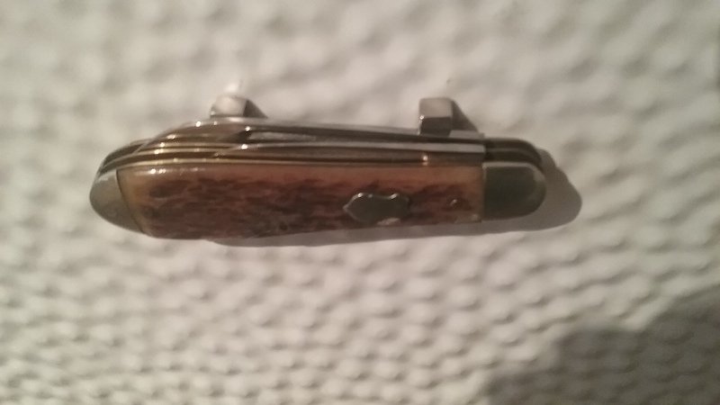

Those are relatively large for Neodymium magnets and the holding power would be overkill for a pocket knife. I used to display knives held by two 1/4" cube magnets. Perhaps get a few different sizes and experiment a bit.
I just grabbed two 1/4" cube magnets and tried it out. First photo shows two magnets attached to the portion of the main blade that protrudes above the frame with the knife closed. Second photo has one magnet attached to the back of the open blade and a second magnet underneath the knife that is attached to the back spring. Yours will hold even better because note that I have them on dimpled metal while your metal surface will be flat.
Dennis
