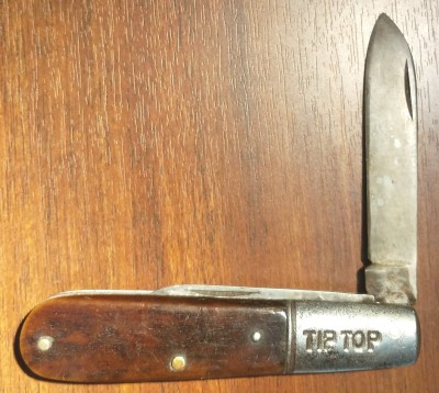

This blade came out of a ruined Camillus Stockman that someone had refinished with a Dremel sanding drum.
I sanded the blade smooth, polished it shiny, then installed it in this knife.
Then I used it. I kept the blade clean and oiled with food-grade mineral oil, and cut a lot of food with it. I used it on apples, tomatoes, and other acidic foods. Within weeks I had this smooth brown patina that protects the metal from rust.
There have been times that I washed it after supper and put it in my pocket wet, and it still has no rust.
I am sure that blueing would work as well or better, but I don't want that on a knife I use on my food.
On other knives I have started a patina by wetting a rag with vinegar, then twisting it around the blade. It begins the process in streaks (sort of tie-dyed pattern), which looks more natural than a solid patina, at first. But it never looks right until the knife has been used a while after that. I only use that to kick-start the process, so to speak.
THIS is what a carbon steel blade should look like on an EDC knife, in my opinion.
