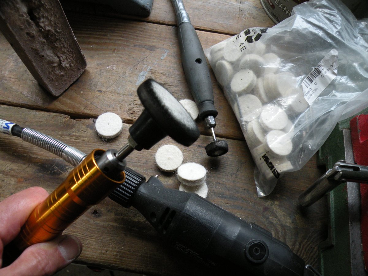

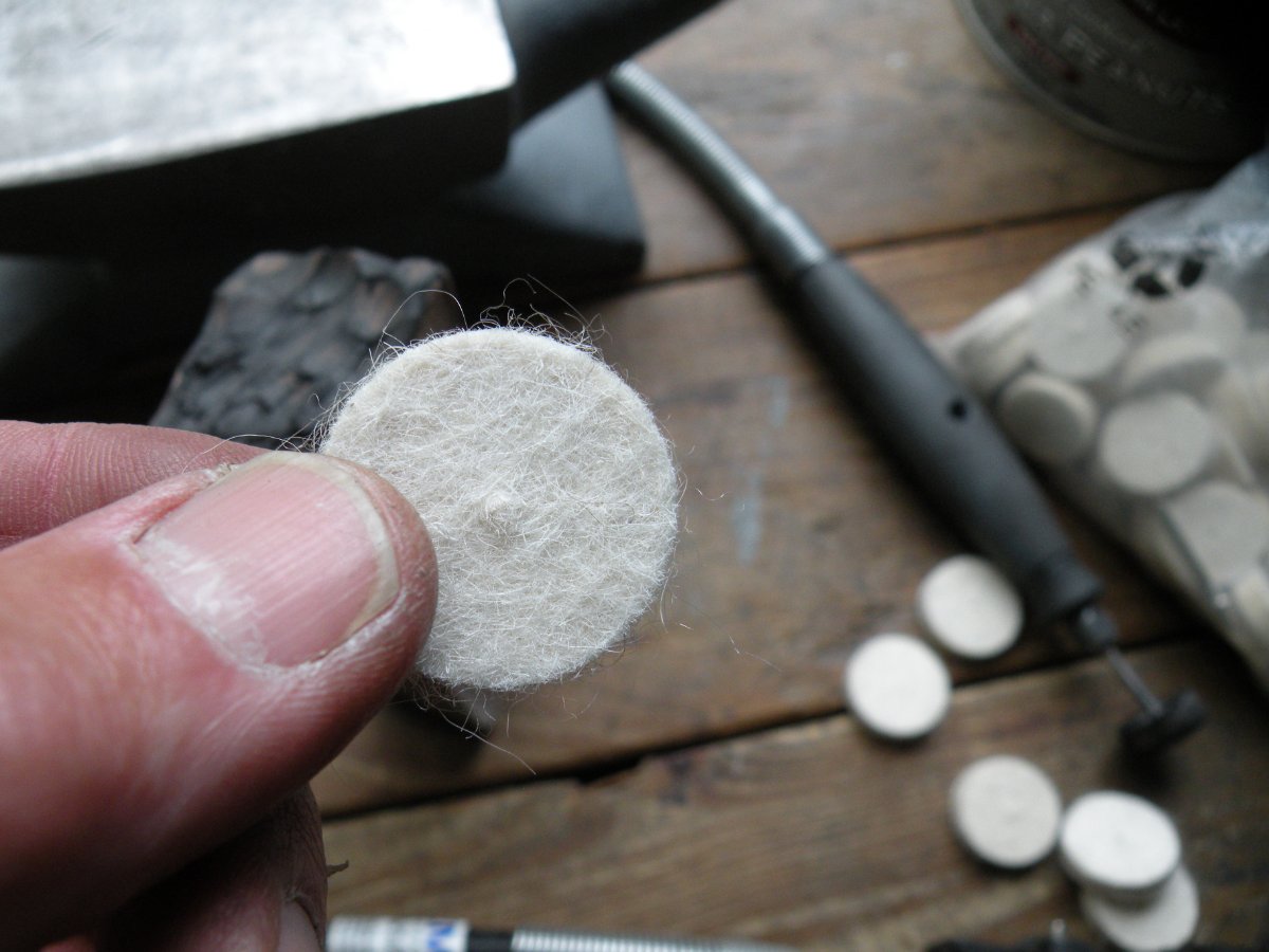

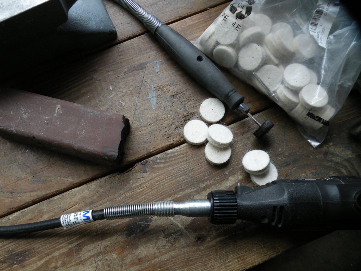

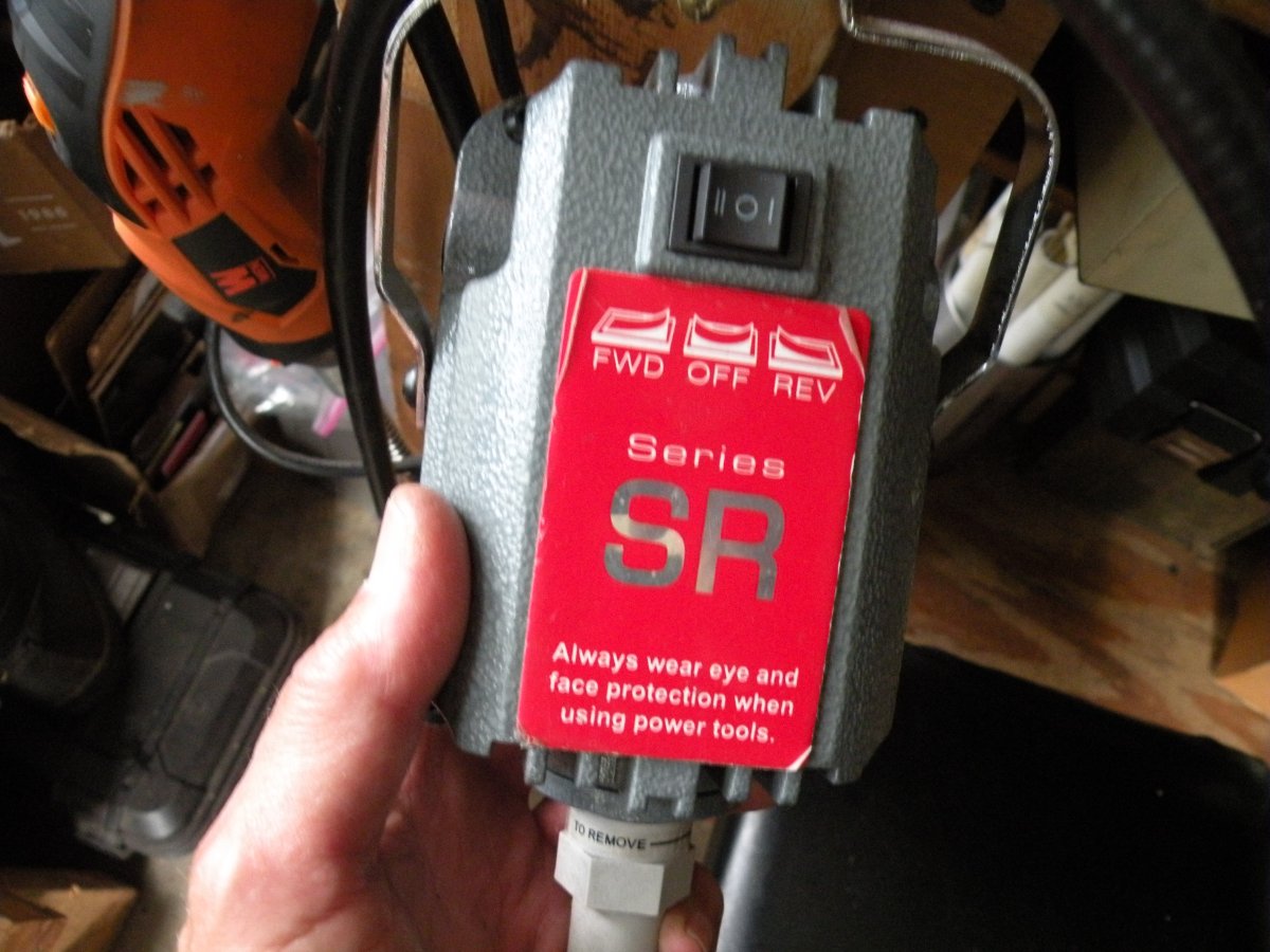

Nev, attached are some pics. For small objects like handle pin heads and bolsters and tight spaces I use the small 1" polishing wheels shown in the first picture, on my dremel, with tripoli (brown) compound. The bag of 1" wheels comes with a shank that is threaded on the business end with what looks like a wood screw. For larger areas I use a 3" wheel on a heavier motor shown in the last pic.
Herb

Thanks for the information Herb ::handshake:: I have that accessory. Never thought of using that ::dang:: Great Idea. ::tu::
I will give it a try.
