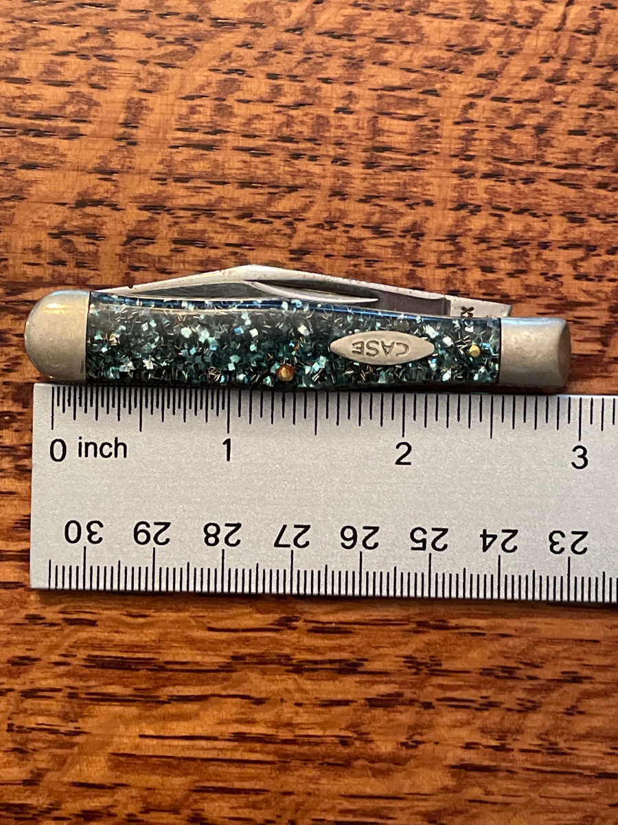

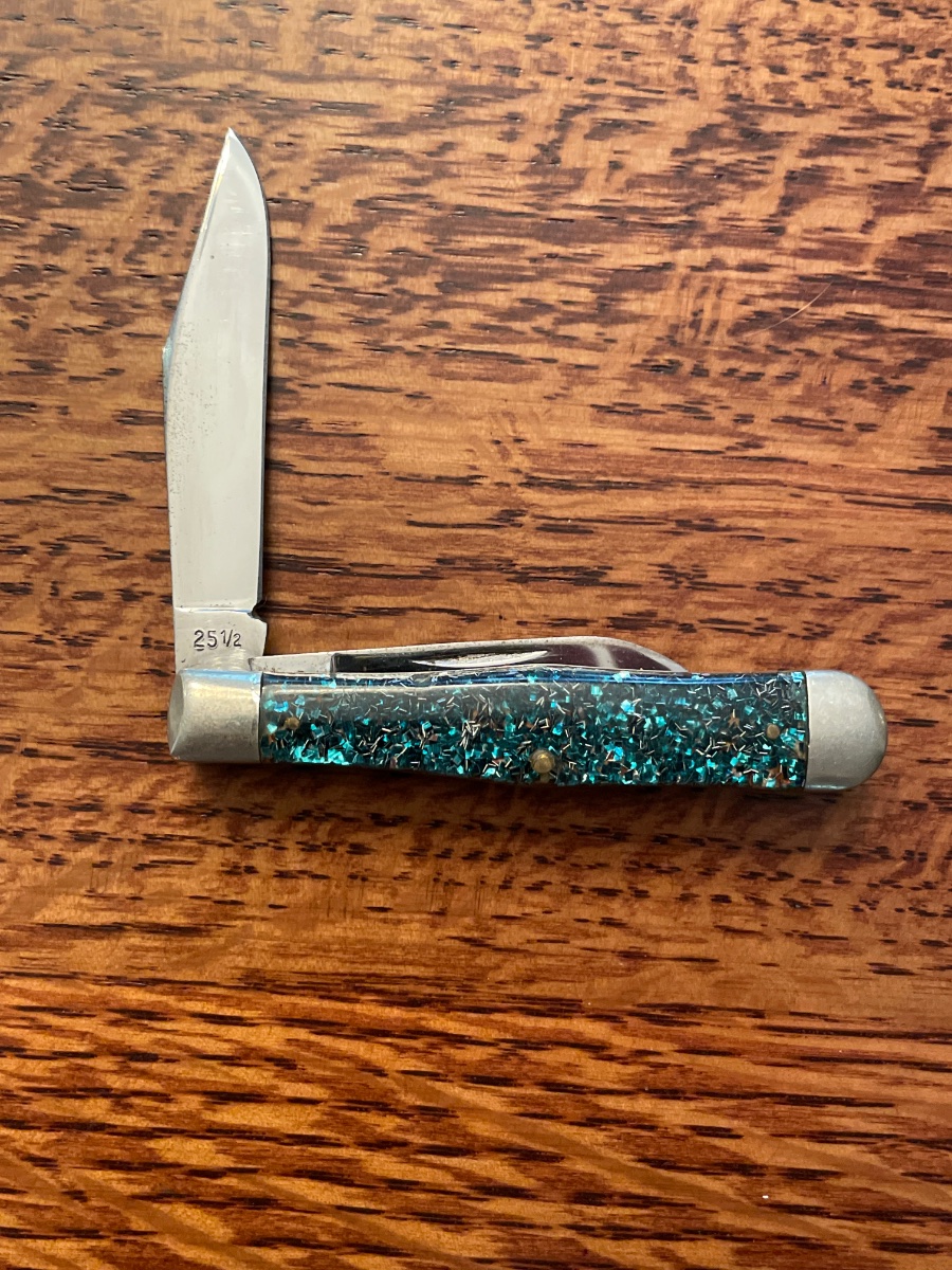

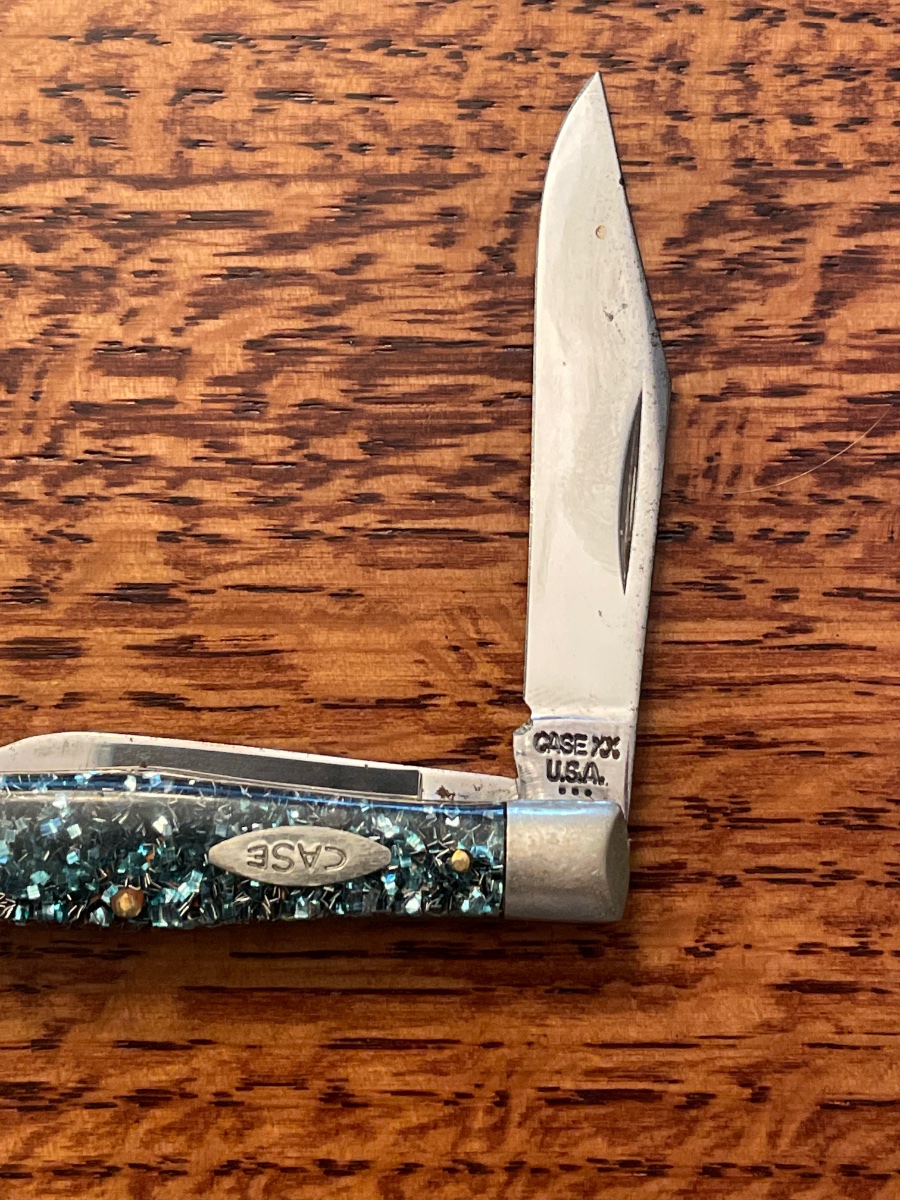

Good morning- this 1977 knife has handle material that I am needing some help on. What is the material used? Thanks for any input!
- Mumbleypeg
- Posts: 15709
- Location: Republic of Texas
Re: Case XX 25 1/2 Handle Material Question
Not sure, maybe Corelon.
But I am pretty sure the knife did not leave the Case factory in 1977 with those covers. At some point afterward it was re-handled. JMO

Did some Case knives have the shield upside down?
DMLEATH
- Posts: 269
- Joined: Sat Nov 14, 2020 6:41 pm
I noticed also that the shield was upside down- I couldn’t find any 25 1/2 knives sold with these handles on EBay. Makes sense that someone rehandled it
- Mumbleypeg
- Posts: 15709
Not intentionally. I’ve seen a very few that were possibly factory errors but most I have seen were re-handle jobs.
