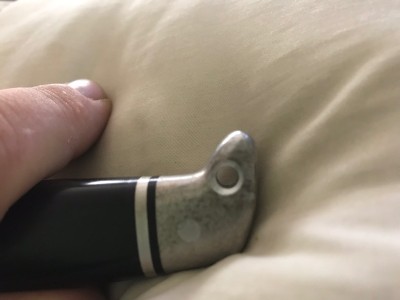

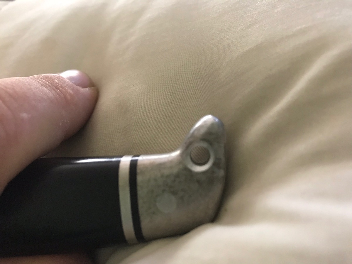

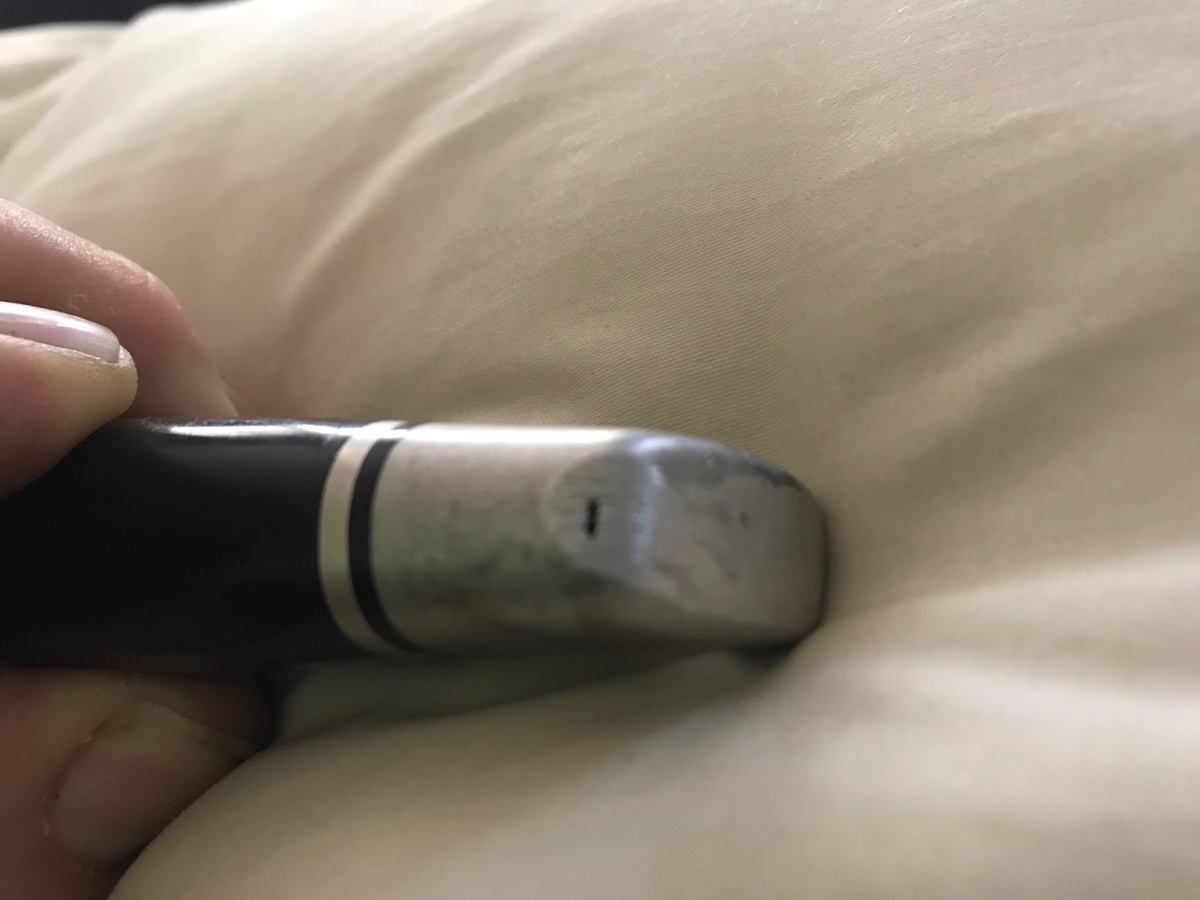

Second I always wondered if I could drill a lanyard hole in the birds beak?. It turned out I can!!
Then I tried to shape the pommel a little and broke into the void for the tang. Oh well. No big deal, but interesting.

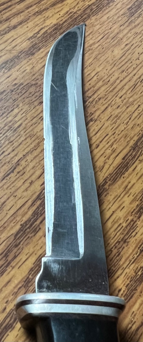

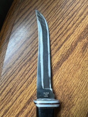

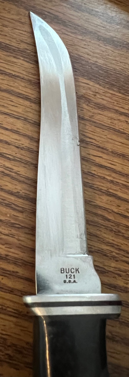

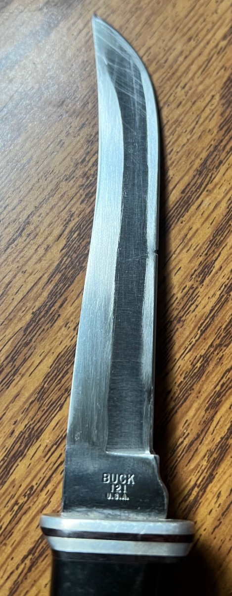

Then someone asked if a Buck with a hollow grind can be made into full flat grind? Only one way to find out.
I used sand paper on my diamond bench stone.
Its really strange because my scratches are actually much smoother than the factory finish. But the pictures make it look ugly.
Interesting how thick the blade was behind the edge. I always thought it would be thinnest behind the edge then get thicker as you move to the spine. Its really ground more like a fuller.
You’d have to sharpen it down quite a bit to get into the thin portion, so I’m not sure what advantage the hollow grind really gives.
I like that the scratches go length wise. I feel the blade slices better. Pretty much have to do it by hand to get lengthwise pattern

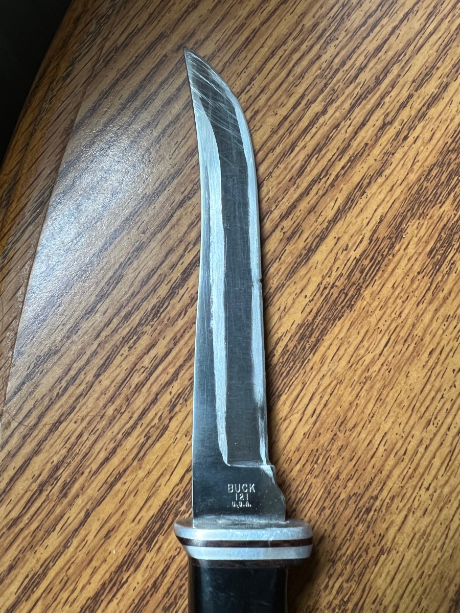

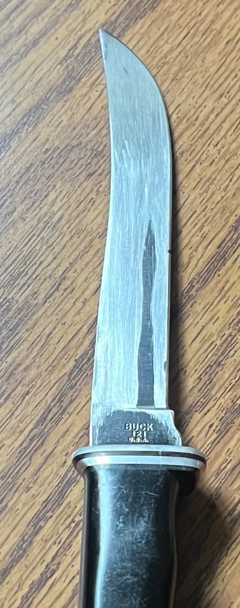

Here it is after some really fine wet dry paper. Not quite mirror but pretty nice.
Long and the short of it. The knife I didn’t really care about is now a favorite.

Looks good ::tu:: you could fill the void hole with JB weld ::tu::

I got a nice 124 (large bowie) in a pawnshop several years ago for cheap because someone had tried to drill through the pommel. This is a full tang knive, duh, when the bit hit the blade tang no further progress.
