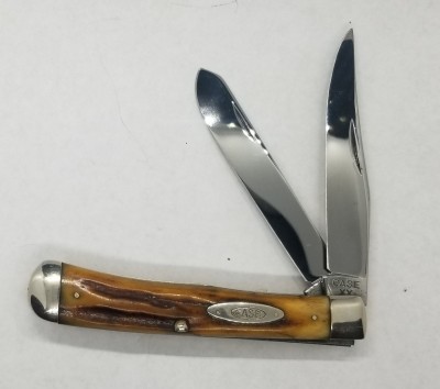

Just picked up this ole beauty this week. I am far from an expert but know just enough to spend a pocket full of money when the opportunity presents itself. I always turn to this forum when I need help with a knife. I have always been confused about the old Trappers. Which ones have the “Tested” frame, which have Muskrat blades and “first model” whatever that means. This one appears to me to have a muskrat blade. The front looks like second cut red stag maybe and the backside looks like red stag. Any and all opinions are really appreciated. Not for sale. Thanks in advance. [attachment=5]41C992E6-F079-4DC1-8207-0C4E5588AC23.jpeg[/attachment][attachment=4]814235F3-6ECE-4DD0-9DAD-1C6AD18C69C1.jpeg[/attachment][attachment=3]4C85F7DB-9F5C-4F29-9114-2C7567674E0F.jpeg[/attachment][attachment=2]C612EF21-A0F1-4CB5-BC72-14A4FFBF9BA7.jpeg[/attachment][attachment=1]785C9E6A-89E3-4A38-BBBF-A8DB729EA3E2.jpeg[/attachment][attachment=0]A49ECDE3-A592-4EC8-9EA3-4B2646428913.jpeg[/attachment]

Ctaylorman, I am by no means a Case expert, and I cannot tell one era Case from another just by looking at it, but there are a couple of things about that knife that do not look right to me.

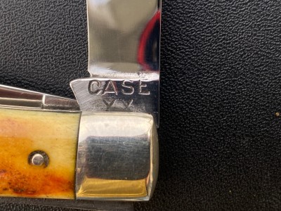

The tang stamp looks like it might have been cold stamped, and it looks like it is sitting up too high on the tang. It also looks strange where the blade meets the tang. Perhaps there was just some pitting from rust that was not polished away, but it looks almost like it could have been welded together.
Finally, the shield looks wrong for that era knife.
I hope that I am wrong on all of these points, but I would be uncomfortable owning that knife unless someone who knows more assured me of it's authenticity.

Possibly the blade has been welded on top of the tang. It doesn't look just right. Some amazing weld jobs popping up.

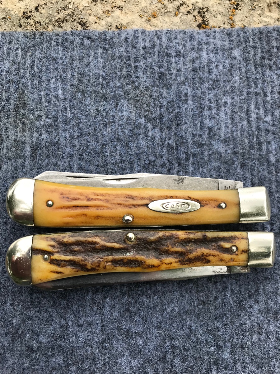

Don’t know about blade weld, shield and other things talked about, but looks to me to be a first model frame. The first model stag is fairly easy to find. Harold
- Posts: 3925
Re: Vintage CASE XX Trapper - Which one??
Bottom knife is 1st model. You can see longer handle material, and shorter bolster. Both knives XX. Harold

In my opinion the knife is fine, probably just over cleaned which might explain the top of the stamp. Shield and everything else looks ok to me. Nice knife in my opinion. I agree that it is a 1st model. It is not second cut stag on either side, but does appear to have quite a bit of red in it so you could call it Red Stag and a lot would in my opinion.

For what it's worth I just looked at dozens of CASE XX stamps. NONE had the little kick up on the bottom of the "E" like this one. NONE had the cross bar on the "A" sitting so low. That's two strikes. For what it's worth, your results may vary.

Tang stamp lettering looks to be somewhat different...The "C" seems to be located just a little too close to the A and has some problems as to shape also. But as with old knives and old men parts tend to become some what distorted after some years. Knife looks good enough for me...just one problem...I don't own it. Please ignore my sentence structure and grammar?

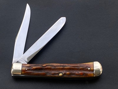

Here is a first model that I have for purpose of comparison.

The position of the stamp on the tang makes me think that either the knife was agressively cleaned to remove metal up to the stamp or that there has been some welding. The fact that the blade looks to have some corrosion or porosity in the shoulder on the mark side tang doesn't jive with the thought that metal has been removed to this point as you would expect the metal to been clean here. The back side of the master kick also looks like there could have been some metal added. Could be just a bad blade grind from the factory but unusual to see a stamp located into the blade grind like this.
