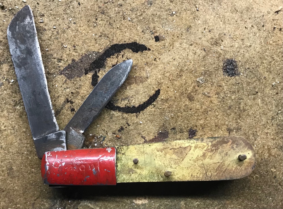

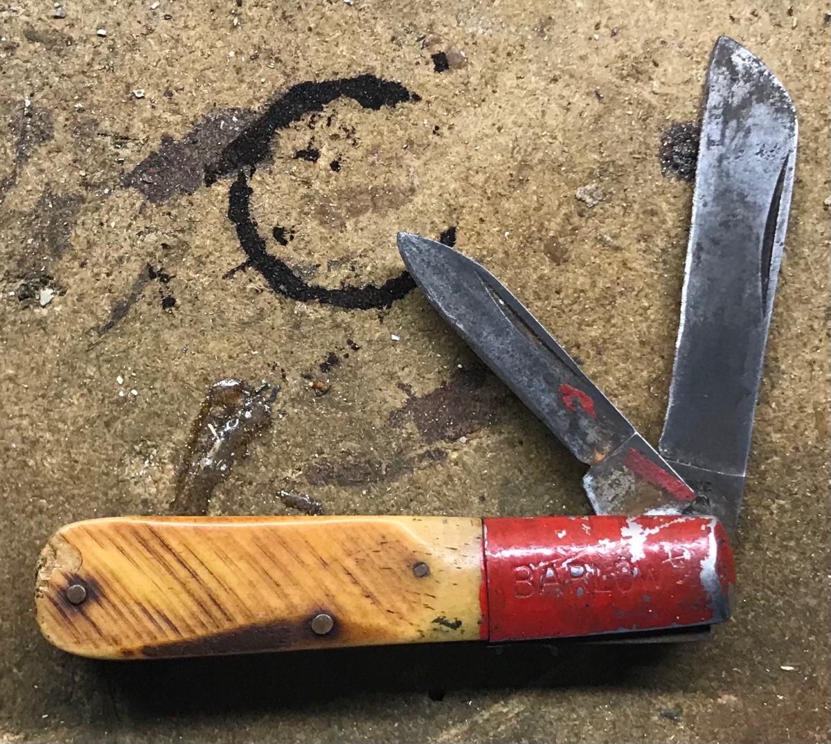

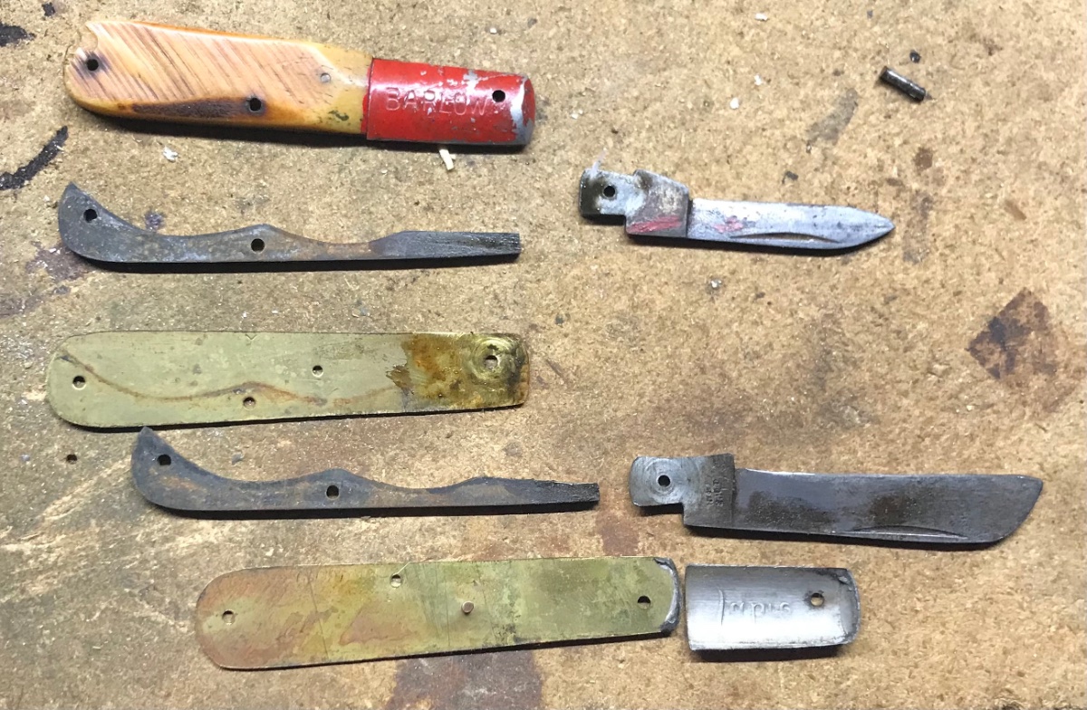

Here is another knife that I fished out of the 'Bay using pennies for bait. I think that the red bolsters made it really stand out in my Project Pile!
Before - mark side
Before - mark side
Before - Pile side
Before - Pile side
Taken apart
Taken apart

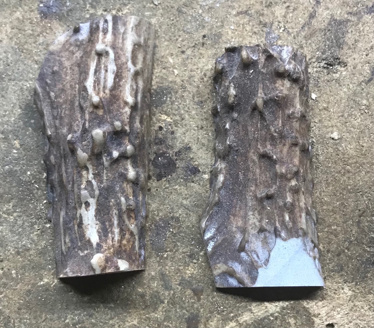

Those hollow bolsters had to go, first thing. I cut out some brass bolsters from some scrap, then sawed out some Whitetail antler for handles. These are the straightest, gnarliest Whitetail that I have seen, so I decided NOT to put them on a Sabre. I have an old Remington Barlow that might get these instead!

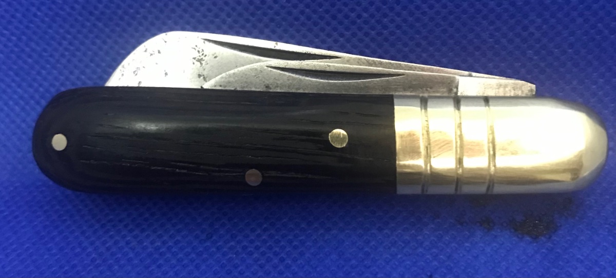

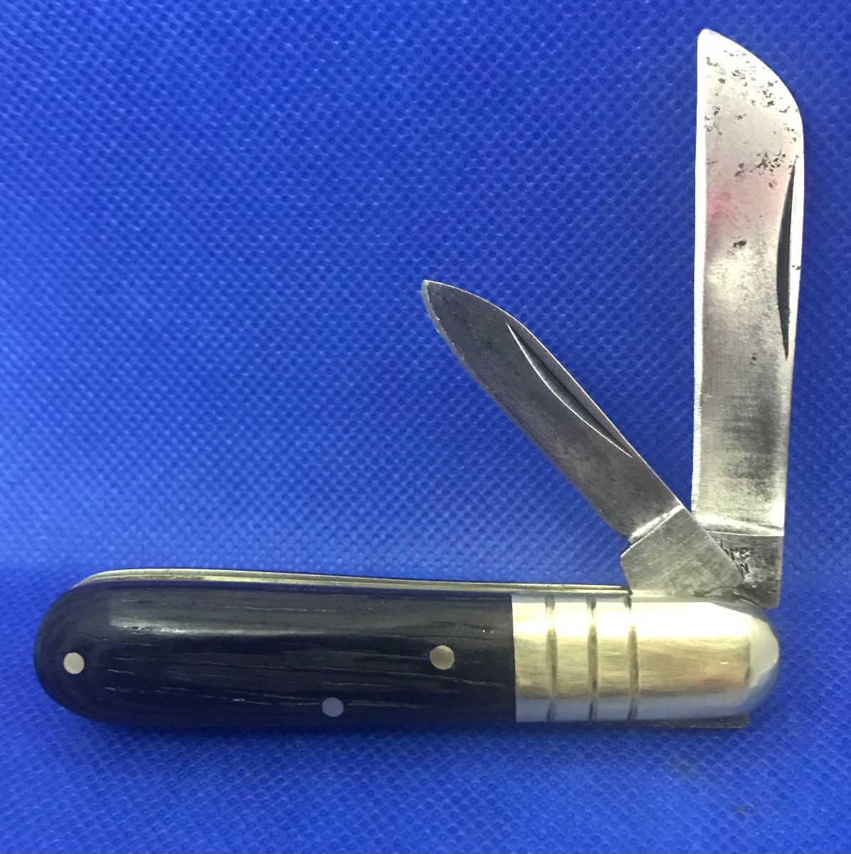

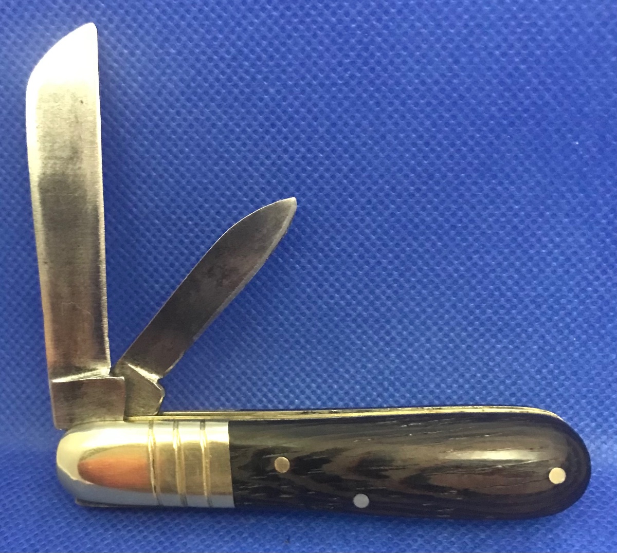

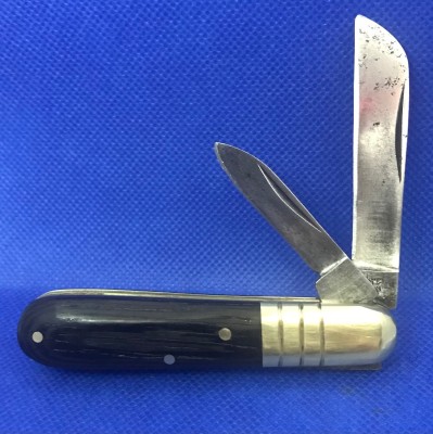

I went with wooden handles (I forget the species. It is from the Woodcraft scrap bin). These are my first threaded bolsters. They are far from perfect, but I am still very happy with this knife!
After
After
After Mark side
After Mark side
After Pile side
After Pile side

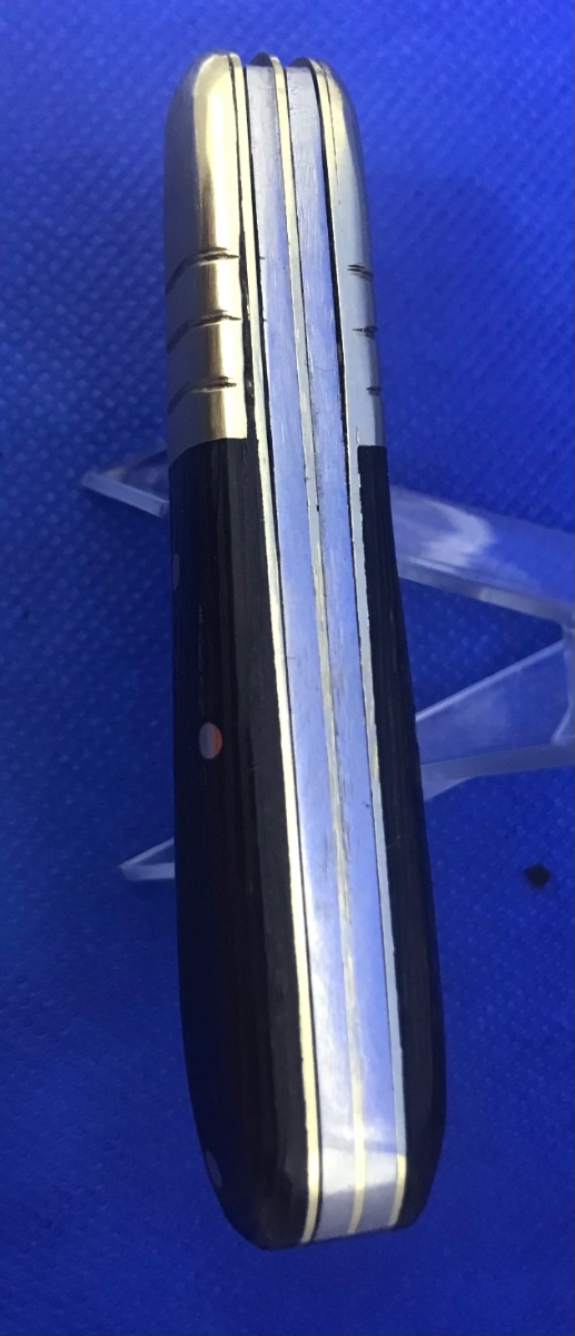

The Main did not quite center perfectly, but it doesn't rub. I think that I must have gotten a hole crooked in one bolster to cause it, because there is also a gap between the spring and the bolster on that side. (There is also a gap between the bolster and the liner on the same side - the solder just did not flow for me).
Still, overall, I am very happy with this one!

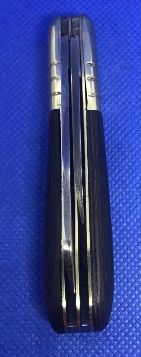

Blades closed
Blades closed
Backside springs
Backside springs
