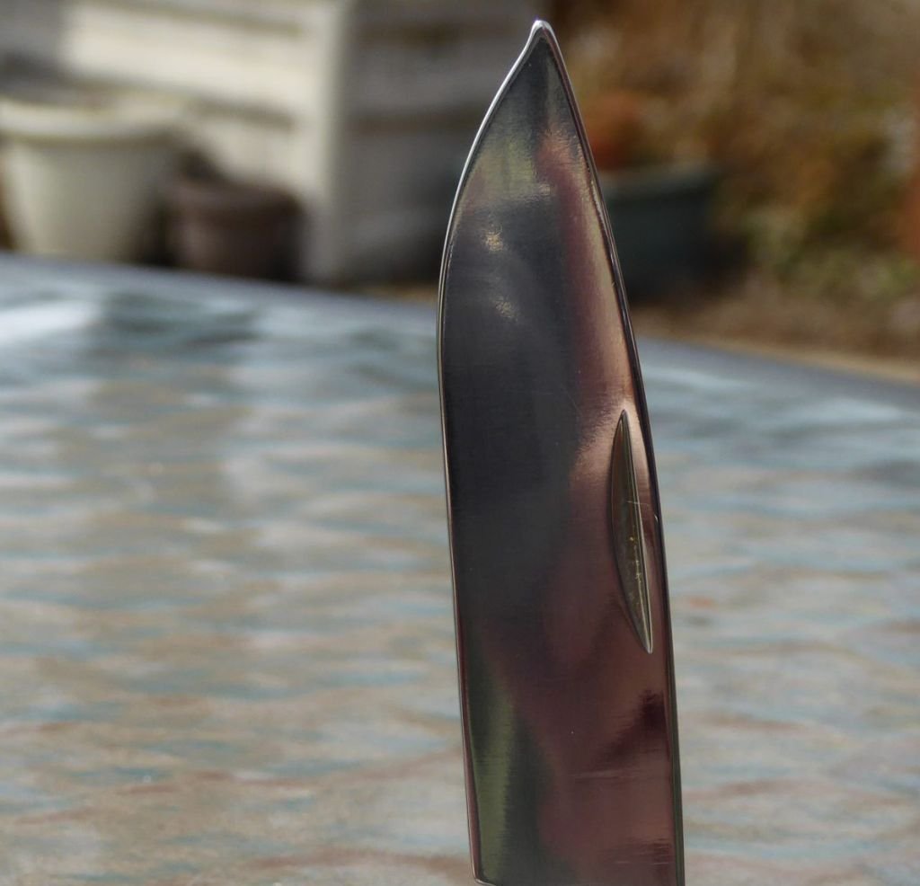

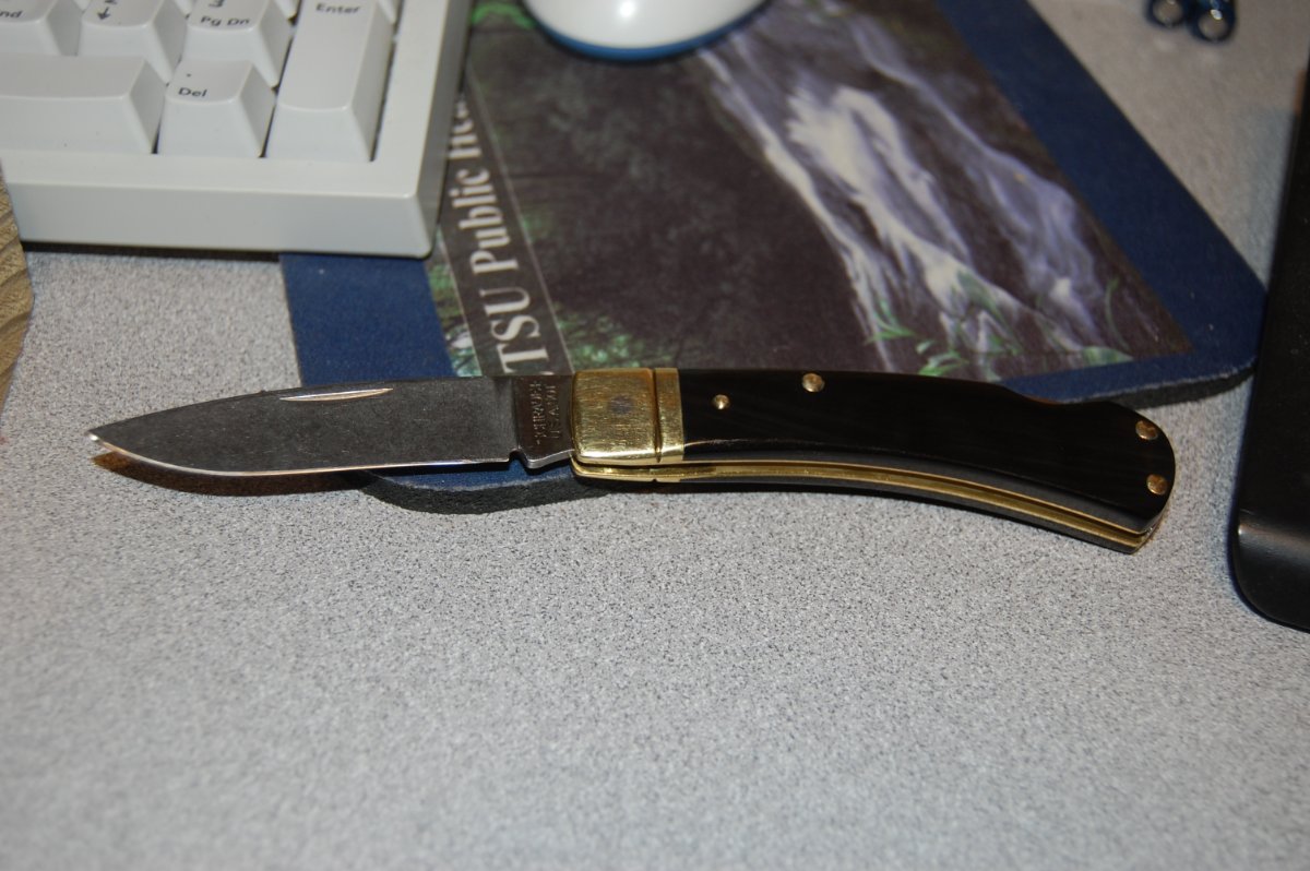

Received some Lansky diamond hones in the mail today so took a crack at creating a bevel on the unsharpened factory blade on the Old Timer 5OT that I got from Jeffin. The diamond stone made all the difference in getting the edge started. It still needs a little polishing but it is very sharp and I am fairly satisfied. By the way I knew the blade was unsharpened when I bought it and Jeff offered to sharpen it for free but it was something I wanted to learn to do. Water buffalo horn handles--Jeffin is awesome.

Nick ya did well. The problem you were having before the diamond was that those other stones just take a long time to cut a new bevel with.
I prefer freehand for sharpening personally and think it’s a skill most anyone can learn. I have a couple of the lansky systems, but I never get as good an edge with them. Especially on smaller blades or blades with a lot of curve. And be careful, it is easy to round over the tip with a lansky system. Been there and done that!
