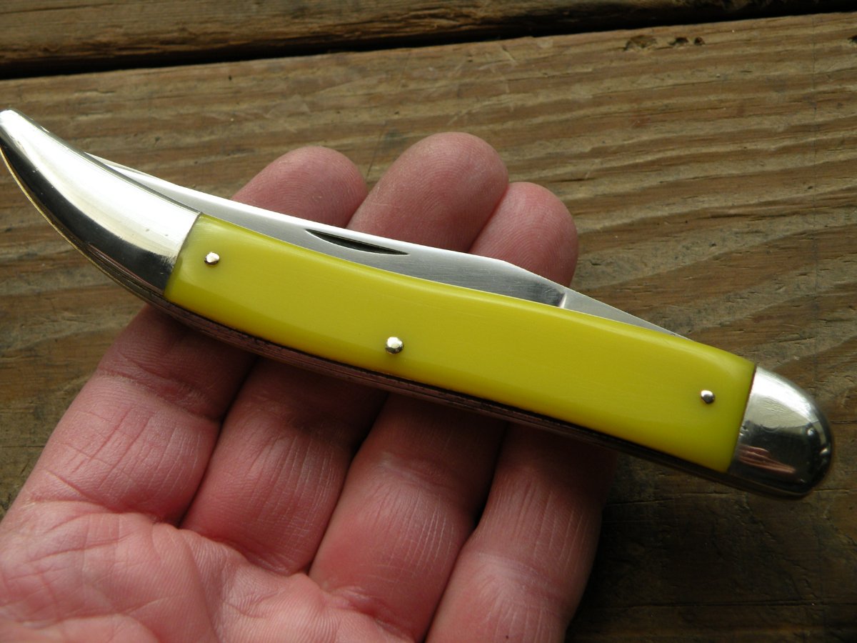

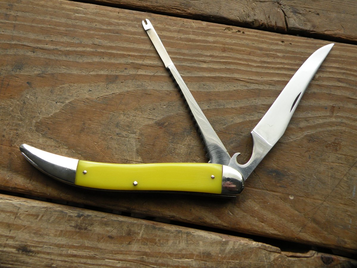

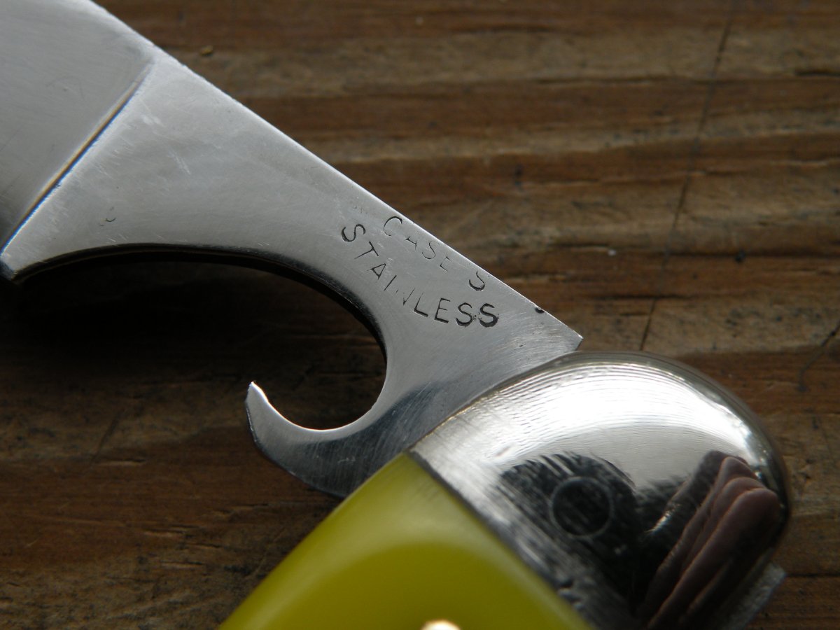

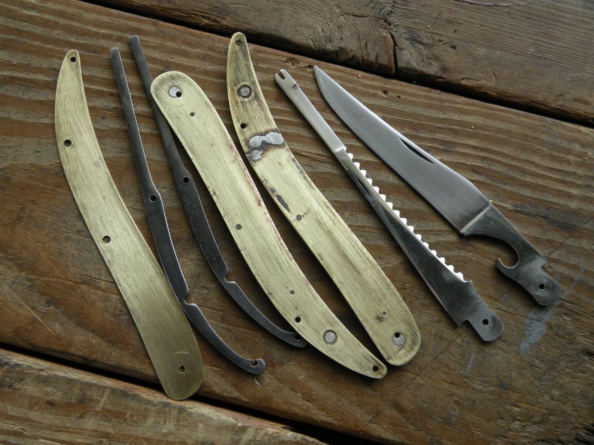

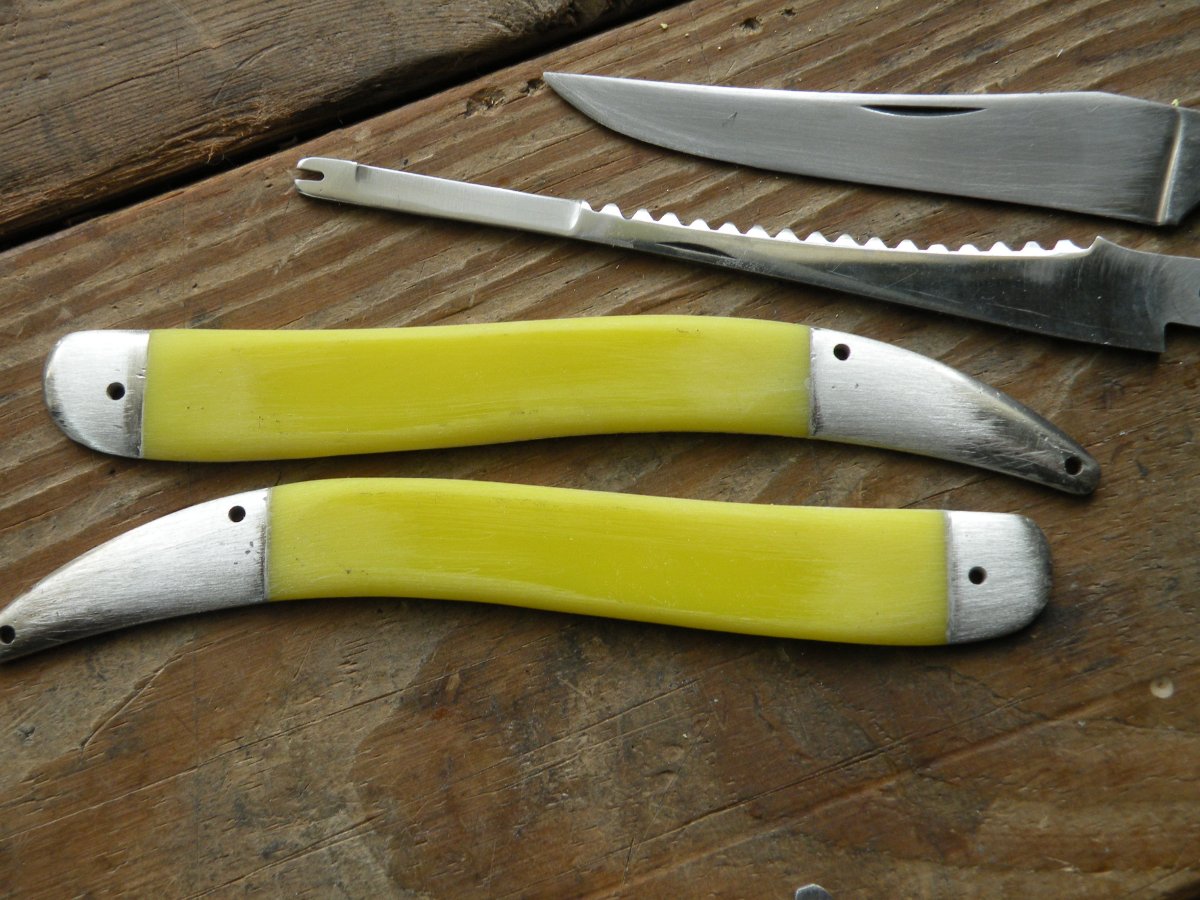

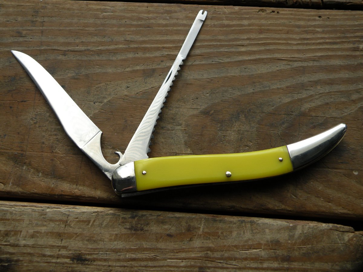

This beast has been in my "on deck" box for so long that I don't remember where I got it. I think I pried off the remains of the cracked up, outgassing cell immediately when it came in and it has rested peacefully since. I only recently noticed the tang stamp, which is quite weak (third pic), and I think this is a somewhat uncommon Case Sea Beast. Anyway, the first few pics are the knife apart, parts cleaned up, and the new scales attached and rough sanded. One of liners got munched on a bit by the outgassing cell, and I was going to make a new liner, but I was able to save it with some soldering which you can see in the first pic. The end of the scaler, which I believe is a hook remover, had one prong broken off. I sent the scaler to Gary Claxon and he did an incredible job of welding on a new hook remover prong for me. The new yellow covers are a synthetic material (maybe delrin?) that I got from Kaleb. I've done some other knives with this stuff and I really like it. The Case tang stamp chart in Steve's great book indicates that this tang stamp was used from 1916 to the 1920's. (I understand from another thread that this may or may not be a bit too early for stainless steel, but I don't want to get into that argument.) Finally, this beast was one of the few or maybe only knives that Case named and then engraved the name in the mark side scale (last pic from my copy of Sargent's). I would not dare to try engraving the "Sea Beast" name in the scale myself but would like to find someone who could do this for me. Any ideas?

Nice work on a very nice old knife, Herb. I always take a Case fish knife when I go fishing (I used one today to clean some fish) but I have never seen one of those old knives. At 5.5 inches that one is a bit larger than the current Case fish knife.

Man, did that turn out nice!
It looks like a brand new knife now that it’s done. Impressive work!
