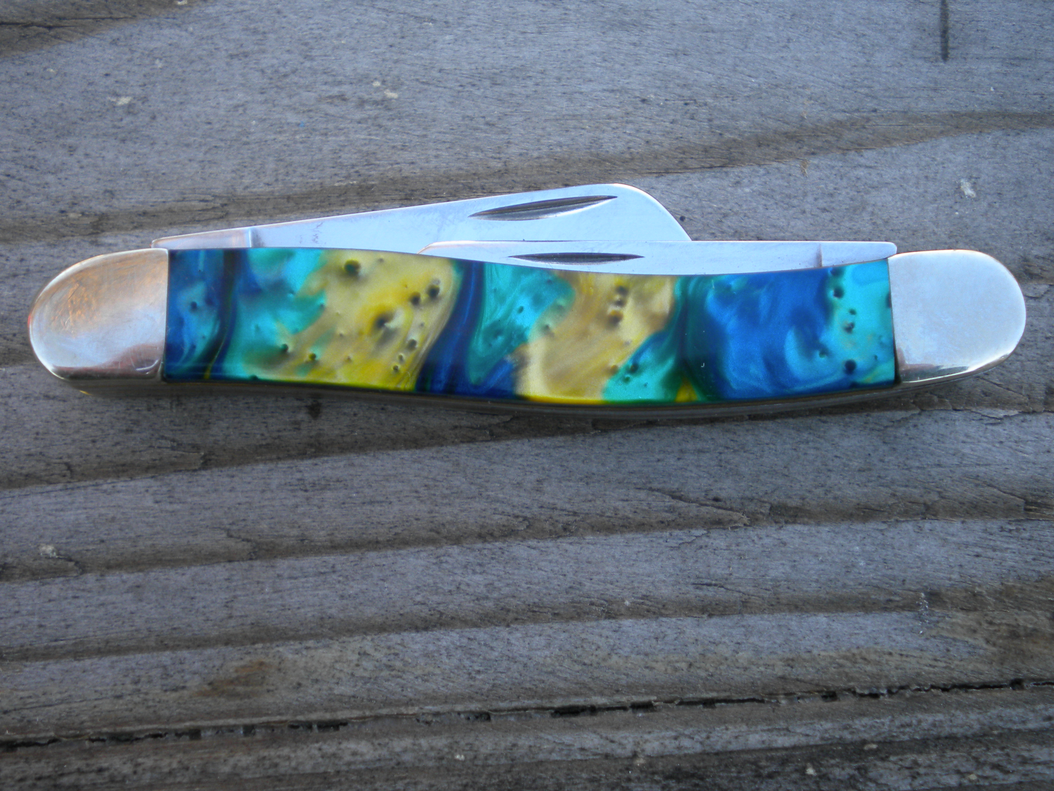

LIL BIT OF case corelon action 8) 8) 8)
- Junebug 2016

I've worked on and rehandled many knives and several of them have been Case knives done by Michael Prater. Those handles are nearly impossible to take off without applying heat. A LOT more heat than it would ever see in someone's pocket. The Corelon is poured in place right onto the knife the same way Case does their Delrin handles with the exception of some very strong adhesive applied underneath (no glue on the Case Delrin....just pins). In short, the Corelon is one handle material (without pins) that I wouldn't ever worry about them coming loose or falling off. Just my 2 cents.

Coloring on that knife reminds me of the liquid crystal fidget discs from the 70's. Whoa. I must learn this technique. ::hmm::
