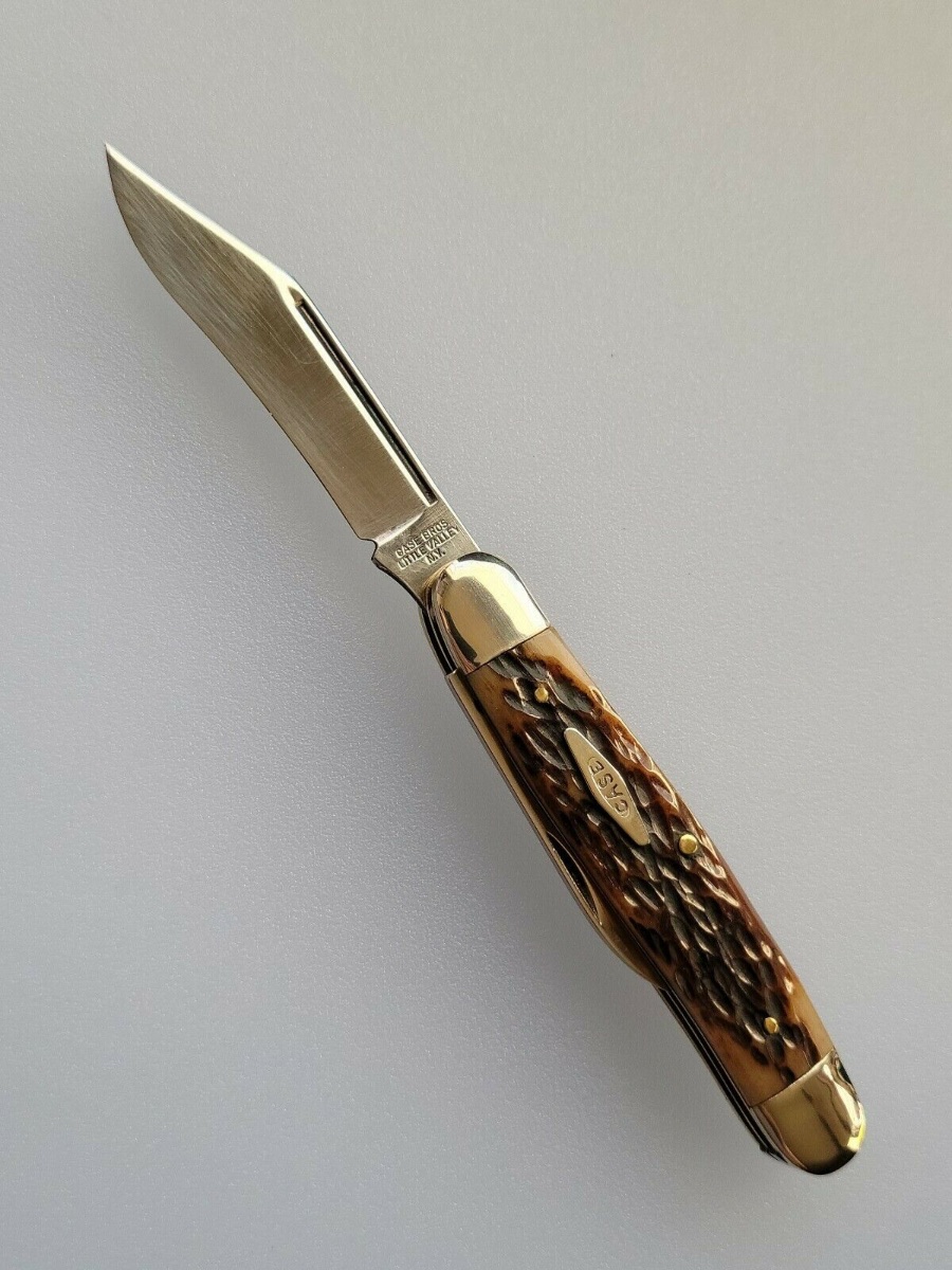

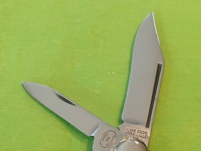

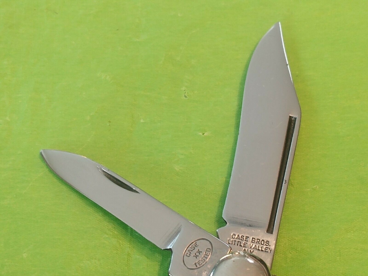

I don't think this one is good.

I agree. Cold stamped. Possibly made from a Utica jack.

Definitely not right. As Ken stated! Cold stamped. Also a genuine vintage Case Bros Knife will never have a shield that says Case.

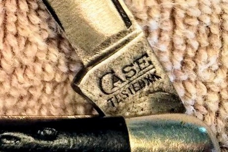

I am no expert but it seems to me there is warping of metal around the lettering
when the cold stamp process is used. The immediate surfaces next to the lettering
during a hot stamp are lying completely flat.
I think the intense pressure required for cold stamping causes the immediate
surrounding surface to "pucker".
Looking forward to a better explanation to follow.

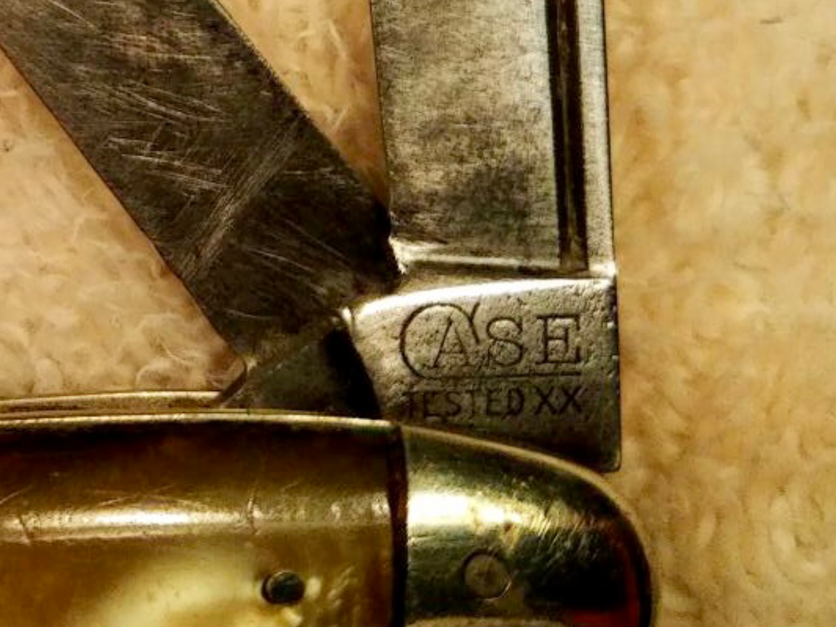

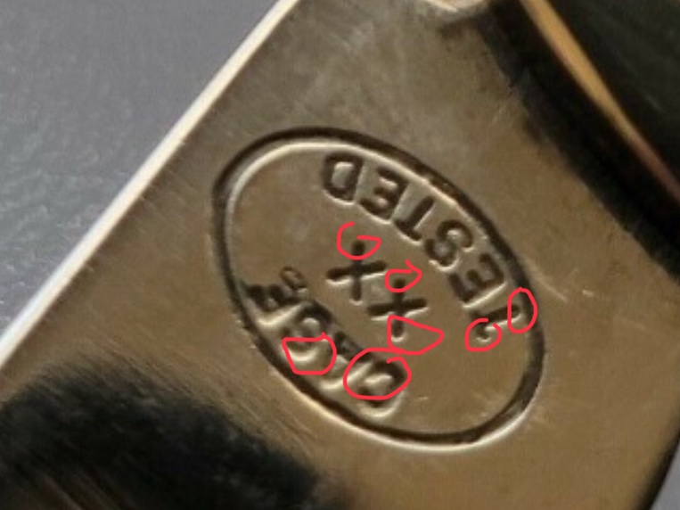

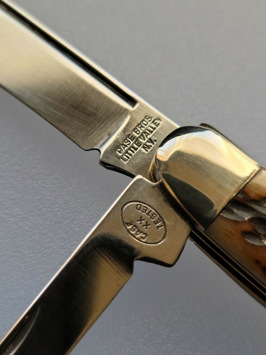

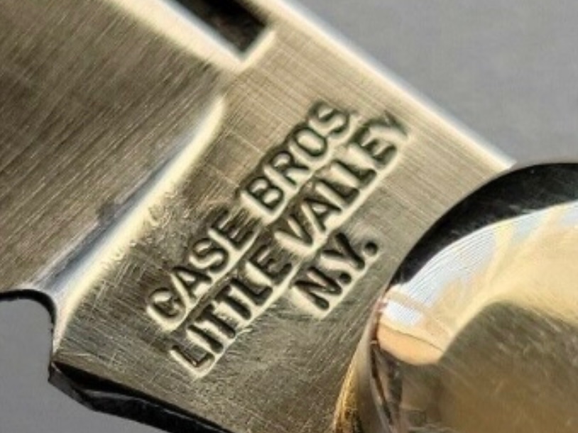

First let me emphasize the stamp is the last thing I look at when trying to determine a knife’s authenticity. You can usually spot a fake from other things, like in the case of the OP knife, having a shield it shouldn’t have, and the tang shaved. Stamps are often difficult if not impossible to tell, especially if the knife is worn. Look for other clues first, then if all else fails examine the stamps. IMHO too many people try to determine a knife’s authenticity from looking at its stamps first, when there are more obvious and easier clues available. Case used hundreds of different stamps - even the “same” stamp had to be made for different sizes of blades. Stamps wear down with use, so the exact same stamping tool left a slightly different impression the last time it was used versus the first time. When the stamp wore out or broke a new one was made - almost assuredly different than the prior one it replaced. I’ve seen folks on this forum say they thought a knife was fake because the stamp looked “different” than the one in the book - the “C” was too far over the “A” or came down too far, or……….
Having said all that, Bob is on the right track. When a cold stamp is applied there is metal “mashed out” and up around the letters. An authentic stamp appears cut into the metal, not mashed into it. Think of pushing a spoon round-side down into mashed potatoes - you’ll see mashed potatoes pushed up and outward around the edges of the spoon. Then turn the spoon so it goes in edge first and dip out some mashed potatoes - you’ll see a smooth divot cut out by the spoon.
I enlarged the seller’s pictures below, and also enlarged the stamp on a couple of authentic Tested era knives. If you look closely at the areas around letters the differences should be apparent. Note also the end corners of letters like “T”, “E”, and “X”. On a cold stamp the end corners are rounded, whereas on an authentic stamp the corners are squared.
Last but not least compare the shoulder grind lines where the grind meets the spine. Where the tang has been grinded down (shaved) to remove the original stamp, the shoulder grind line near the spine has been removed - a sign that metal was removed from the tang. The tang shoulder grind line should extend all the way from edge to spine.

Also Case Brothers NEVER stamped "Case Tested XX" in an oval on the tang.They did stamp"Tested XX" in a straight line on some.

Roger is correct. The Oval Tested Stamp wasn’t used until 1915 after W R Case & Sons purchased the XX trademark from Case Brothers shortly before Case Bros closed shop.
