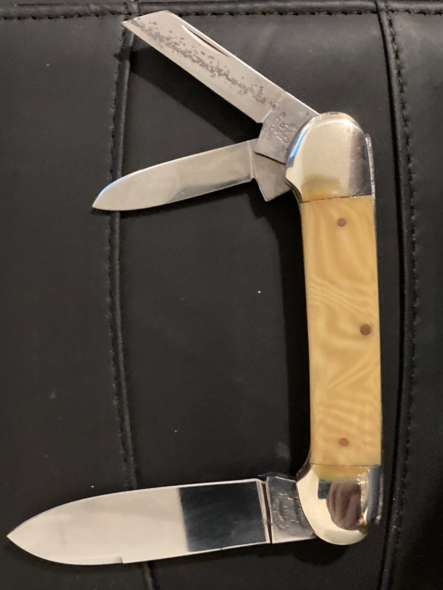

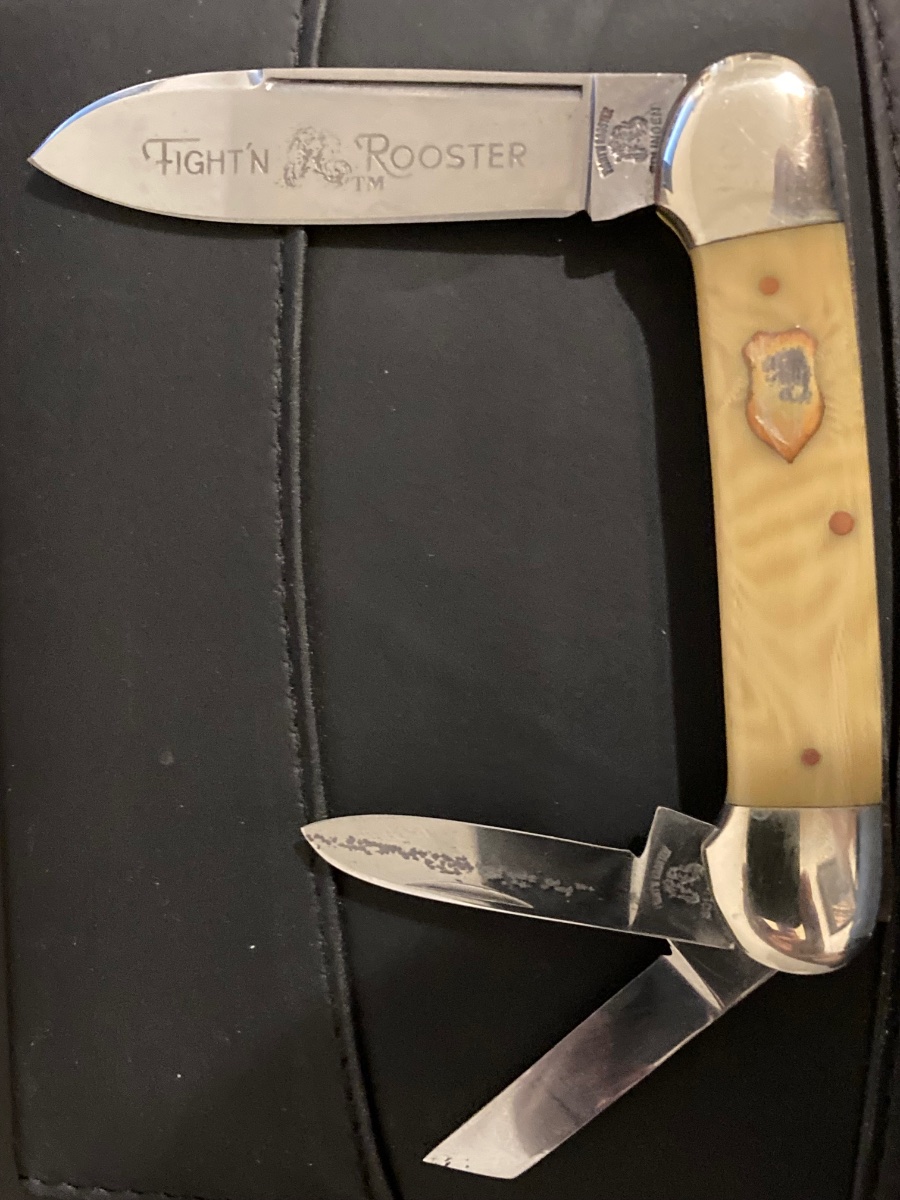

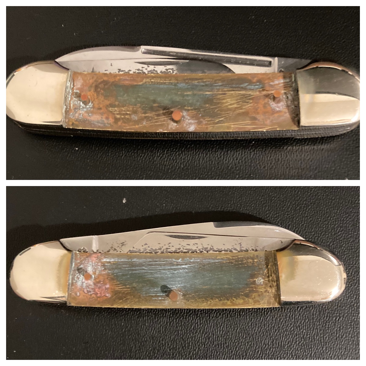

These are pictures of my Fight’n Rooster Waterfall Cannitler, produced between 1984 and 1992. I recently noticed some discoloration on the shield and back bolsters. Then I found pitting on both the pen and sheepsfoot blades. Does this appear to be “outgassing”, and if so, what can be done about it! Will silica gel packs slow or stop the process? Any advice will be greatly appreciated.

Definitely looks like outgassing, and to my knowledge (not an expert by any means) there is no stopping it. Do not store it around other knives and open air is better than in a box it seems like. Best thing to do in my opinion is to remove the covers and get it recovered by one of the knife mechanics on the forum here.

Definitely outgassing.
C-Wade7 is 100% correct.

Yes, that is an early sign of outgassing. Once it begins I know of no method to stop it, short of removing the offending covers. Fight’n Roosters and other German-made knives of the past 30-40 years are notorious for outgassing.
Whether they’re worse than older knives from other makers, I couldn’t say. It’s possible we just notice them more because most are in someone’s collection. Whereas a lot of the older ones just self-destructed and no one noticed, or were “used up” and disposed of by their owners. I’ve read the average lifespan of an EDC pocket knife pre-1960’s was around 3 to 4 years. (How they determined that I have no idea, but I wouldn’t argue with it. At that time they were mostly just simple inexpensive tools.)

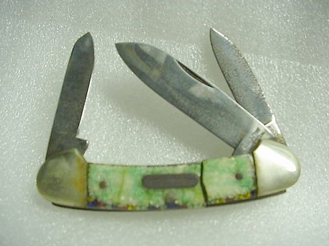

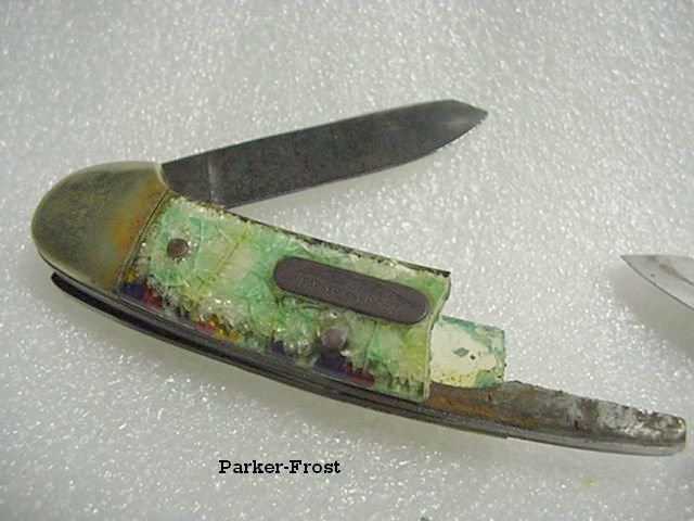

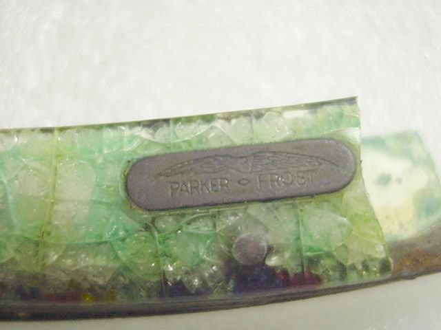

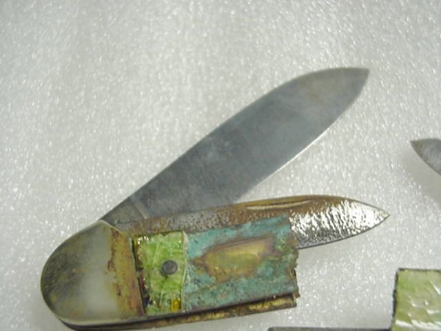

I googled "Sublimation of celliuloid" and found a very good article from the JAIC (Journal of the American Institute of Conservation). If you have a minimum of chemistry background it will help but reading the whole thing is self explanatory. The URL is: cool.culturalheritage.org/jaic/articles/jaic30-02-003.html
The section on prevention and collection maintenance is informative. Sadly the conclusion is, the sublimation ,(going from a solid directly to a gas, also called,"outgassing"), cannot be prevented or stopped, only retarded to the degree established by the relative amounts of camphor, nitrates, acids, alcohol, and proprietary chemicals in the original manufacture. Some are more or less stable than others.
There's a lot of info about this problem floating around. Most I've read is empirical. This article was written from scientific studies by chemists concerned with collecting and protection of collections. We all have and love our celluloid knives and have suffered the shock of finding them ruined.
Hope this article helps. J.O'.

Thanks to all who replied. I was afraid of the answer, but not surprised. Any recommendations for AAPK knife mechanics?

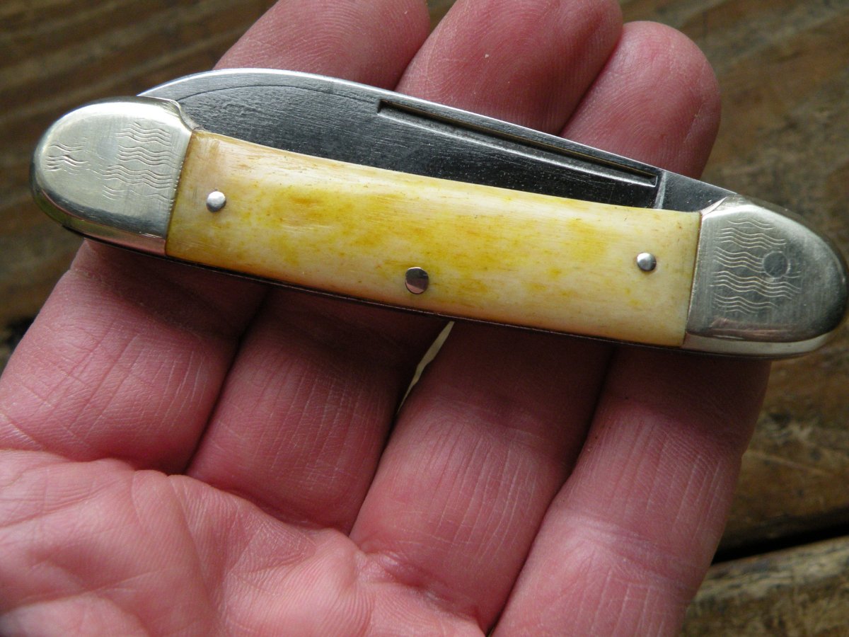

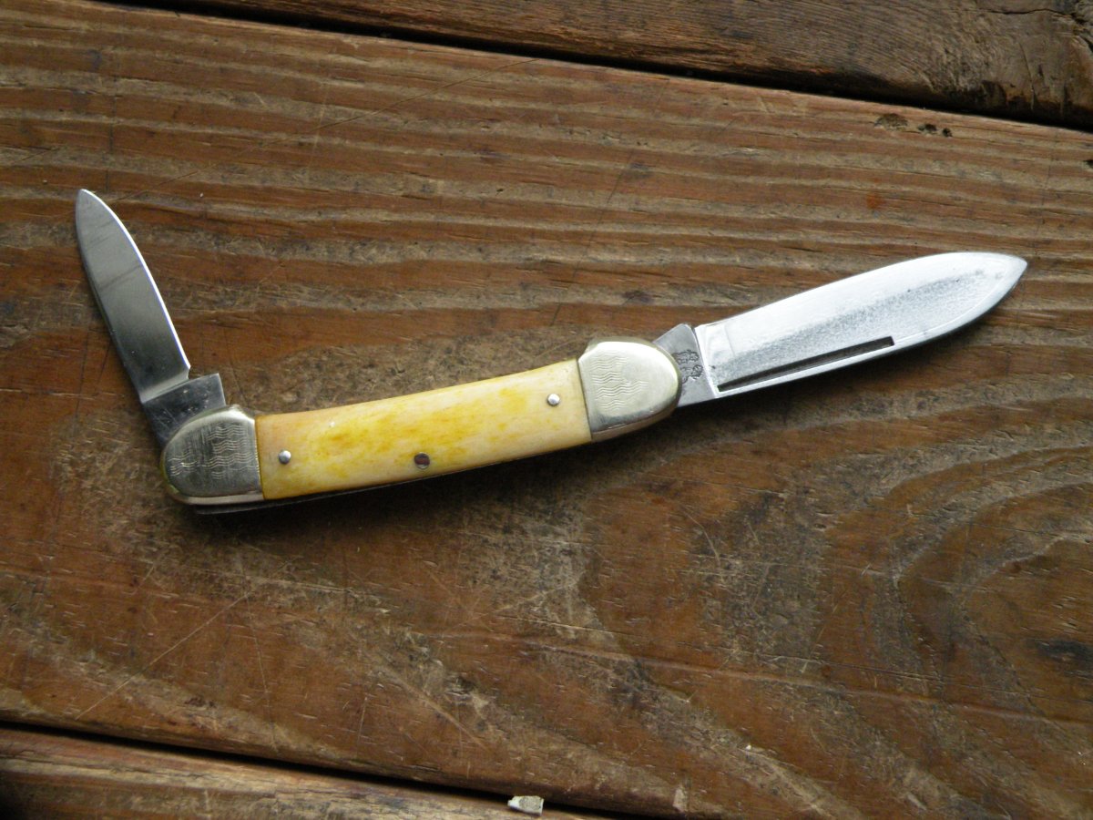

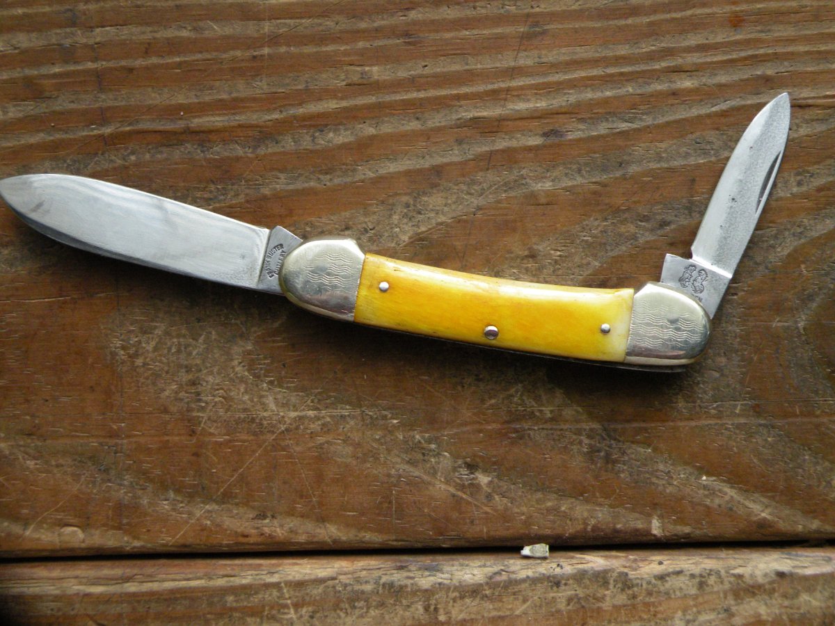

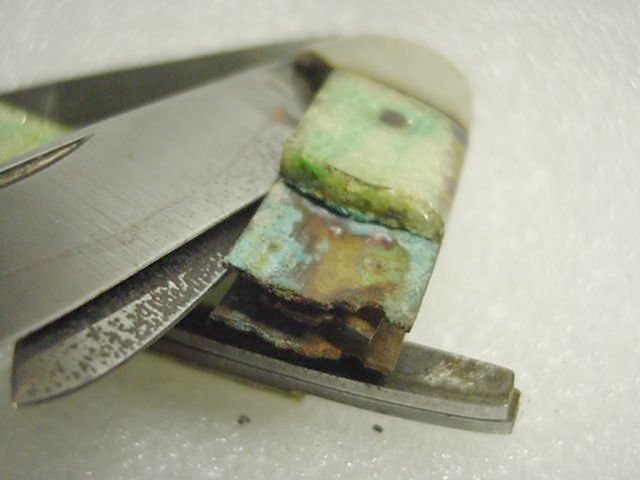

What everyone said is absolutely correct. Attached are pictures of a Buster canoe that I rehandled/restored a few years ago using smooth yellow bone. I didn't reattach the shield because it fell apart in pieces when I pried the covers off. Fortuantely, everything else was still usable. The celluloid used by Frank Buster and by some of the other German manufacturers seems to be quite prone to celluloid outgassing, which can suddenly happen with little or no warning, and will quickly destroy your knife and any others around it. I didn't do a lot of work on removing the residual pitting on this one because I decided to keep this one in my EDC stable. You do need to remove those covers on your knife in the pictures ASAP, disassemble the knife and thoroughly clean all parts, making sure that you remove the green residual outgassing crap (sand and /or use a stiff wire brush). Then, when you are ready, reassemble and rehandle with the material of your choice.Gtrclktr-351 wrote: ↑Thu May 16, 2024 7:41 pm Thanks to all who replied. I was afraid of the answer, but not surprised. Any recommendations for AAPK knife mechanics?
Herb
Herb

Again, thanks to everyone for sharing their knowledge and recommendations. I was able to remove the scales, with one broken pin. Was surprised how bad the liners looked, but after a little work it seems to be “surface damage. Now to decide if I want to tackle an amateur rehandle, or pay someone to do it right. You live and learn. Gonna have to give my two “end of day” Roosters a closer look.

Nice resto Herb
J.O'.

You did a nice job on the rehandle.herbva wrote: ↑Thu May 16, 2024 8:13 pmWhat everyone said is absolutely correct. Attached are pictures of a Buster canoe that I rehandled/restored a few years ago using smooth yellow bone. I didn't reattach the shield because it fell apart in pieces when I pried the covers off. Fortuantely, everything else was still usable. The celluloid used by Frank Buster and by some of the other German manufacturers seems to be quite prone to celluloid outgassing, which can suddenly happen with little or no warning, and will quickly destroy your knife and any others around it. I didn't do a lot of work on removing the residual pitting on this one because I decided to keep this one in my EDC stable. You do need to remove those covers on your knife in the pictures ASAP, disassemble the knife and thoroughly clean all parts, making sure that you remove the green residual outgassing crap (sand and /or use a stiff wire brush). Then, when you are ready, reassemble and rehandle with the material of your choice.Gtrclktr-351 wrote: ↑Thu May 16, 2024 7:41 pm Thanks to all who replied. I was afraid of the answer, but not surprised. Any recommendations for AAPK knife mechanics?
Bill

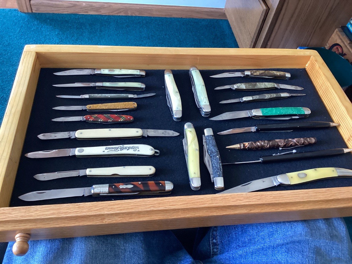

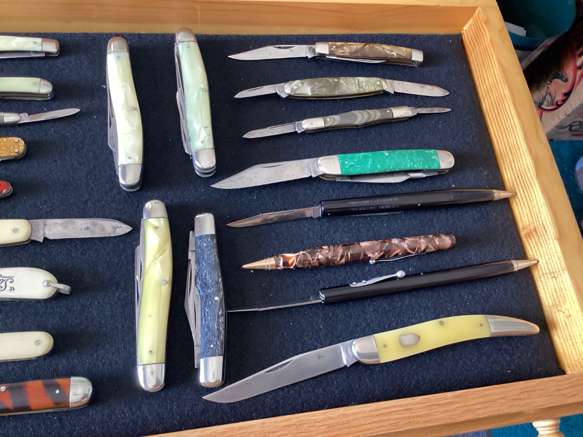

Jacknifeben
- Posts: 1657
- Joined: Wed Mar 03, 2010 9:06 pm
Re: “Out gassing” question for more informed forum members
Stick with Cattaraugus and never go wrong. Some of these have been hiding in a drawer for over 50 years.
- Miller Bro's
- Posts: 13629
- Location: Earth
Here's my knife, let yours go too long and it will look like this one

I believe (HOPE)Miller Bro's wrote: ↑Sat May 18, 2024 9:14 pm Here's my knife, let yours go too long and it will look like this one![]()
I caught mine in time to prevent any further damage.

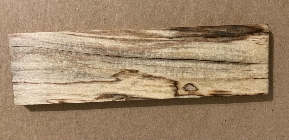

I took your advice and decided on wood. Found a set of stabilized spalted birch scales. Thought birch would be perfect on a canoe. If I am successful, I can get both scales from one scale. If I fail, I’ll have another scale to send to a professional.Modern Slip Joints wrote: ↑Thu May 16, 2024 11:34 pm A canittler or any canoe would look good with hard wood sides, preferably a hardwood local native Americans used.
