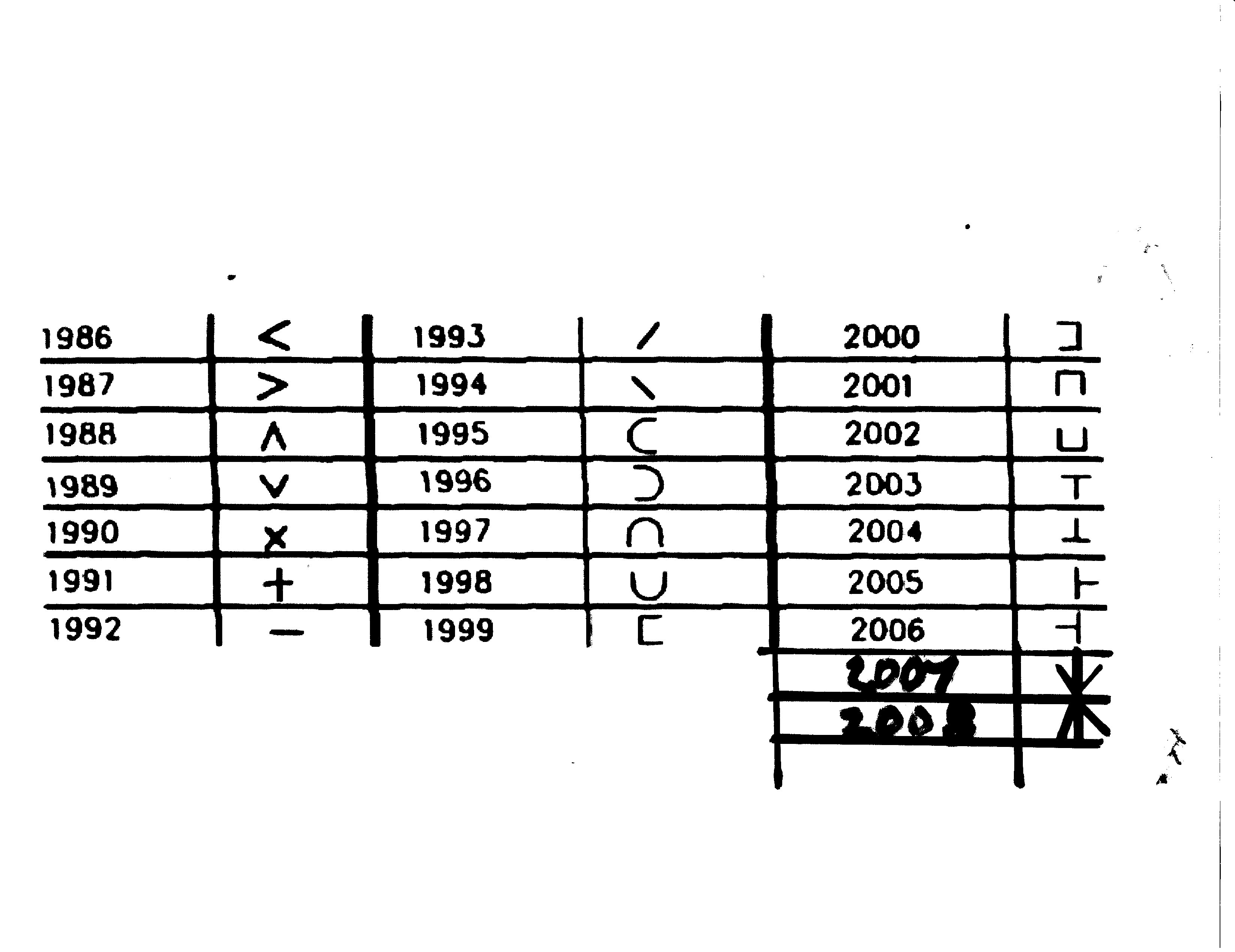

- jonet143
- Posts: 6922
- Joined: Fri Jun 23, 2006 3:33 am
- Location: w'ford-tejas
Re: Determining the date of a Buck knife
buck date code
johnnie f 1949

- Joe Houser
- Posts: 33
- Joined: Tue Jan 06, 2009 6:19 pm
A picture is worth a thousand words!
Thanks Johnny!
Couple things to keep in mind in regards to that chart. 2002's date code got changed to a tiny anvil in commemoration of Buck's 100 year anniversary.
Then, we moved our plant from San Diego California to Post Falls Idaho in 2005 so...we changed the symbol for 2005 to a tiny outline of the state of Idaho.
I will see if I can figure out how to get a good picture of the updated chart posted here.

I just picked up a 112 w/a date code mark not on the graph.jonet143 wrote:buck date code
Much like the 1988 mark, but w/line in middle, like an arrow. What year would that be please?
Thanks in advance.

Obviously they do. I have found my answer elsewhere on the net.
The arrow ponting down towards the USA marking means 2007 MFG.
The arrow pointing up (as mine) away from the USA means 2008 mfg.
I bought the knife on ebay, so wasn't sure what vintage. Thanks for your replies.

Hi Fatstrat,
Maybe I can help with your question. I have a couple of newer Bucks that have the "arrow" like what you described in the date stamp, but on mine the arrow is pointed down. You say yours is pointed up. The chart Jonet143 posted only goes through 2006. The knives I have with the downward pointing arrow are made in 2007 based on the date shown on their boxes.
I have to assume by a process of elimination that your knife may well have been made in 2008. (Not likely you would have a 2009 model yet) Do you have the original box it came in? If so, check the label on the end of the box and see if it shows a production date.
Hope this helps. Let us know if you have the box and if so if there's a date on it.
Phil
edit: Looks like you beat me to the punch by all of one minute, but since I had to dig my knives out of the safe and unpack an ammo box full in an attempt to get you an answer, I will leave the post as written.
