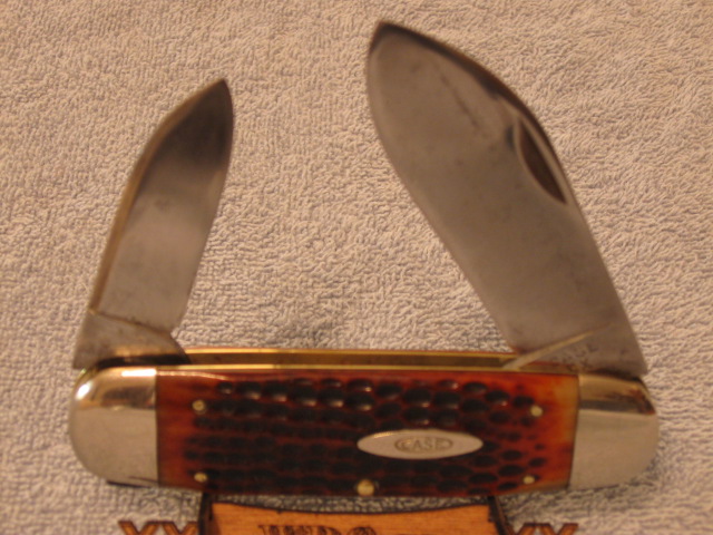

Thank you Robin. I appreciate your help and the fact you did some research for me.. I was surprised that I could not find the answer quick and easy. Here is a picture of the knife I bought without the pattern stamp.
Again Thanks,

Great knife ! That is my favorite style . I have several of those in "CASE XX" red bone and green bone (also reg bone) - some with pattern # and some without .

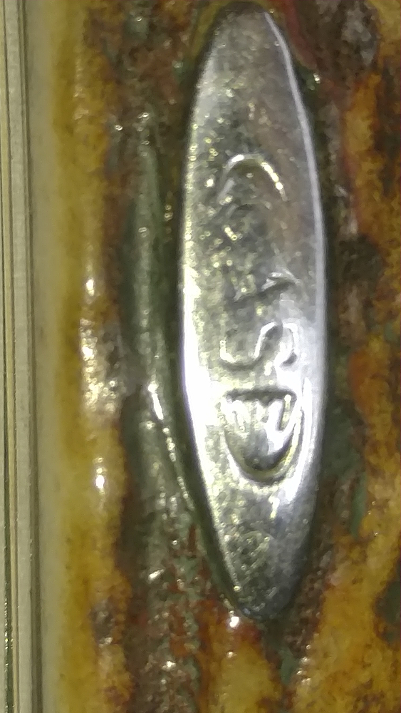

I just acquired this Case with no number. It is Case Tested xx.
peanut740
Posts: 7845
Re: NO PATTERN NUMBER
Post by peanut740 »
I don't think it's a Case.
Roger
Zuber7
Posts: 6
Joined: Sun Apr 15, 2018 7:10 pm
Post by Zuber7 »
Can anyone tell me what this knife truly is?
olderdogs1
Posts: 2538
Joined: Mon Apr 03, 2006 6:48 pm
Post by olderdogs1 »
I would like to see a real close up picture of the tang stamp or stamps. Also what is the closed length? Hard to evaluate with the pictures and information given.
Tom
Mumbleypeg
Posts: 14583
Location: Republic of Texas
Post by Mumbleypeg »
Need some better, good clearer pictures taken on a neutral background (light gray or white) with good light. The knife looked off (as in not Case) to me the first time I saw it, but can't quite put my finger on what about it is off. May be the covers? To confirm its okay or not need better pictures, whole knife, both sides with blades closed and open without cutting off parts of it in the picture, and close ups of the tangs.
Please don't be offended. There are a lot of counterfeit knives, especially old Case Tested knives. Most are easy for an experienced eye to spot. Some however will fool most collectors. We've all been there or will be sooner or later (which is why we're all skeptics.) :lol:

Here are some closeup pictures of the Car knife. The knife is 4-1/8" closed.

What throws me a little is how ""pocket worn"" the shield & scales are,compared to the tang stamp & blades ?? Not wanting to start a slinging match,but just seems like from the wear on the shield & handles,that the knife has been carried and used for many miles,not to wear the blades more ?? Tang stamp looks like it was stamped yesterday** Still a handsome Case Knife though** ::tu::

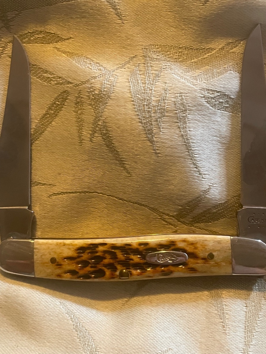

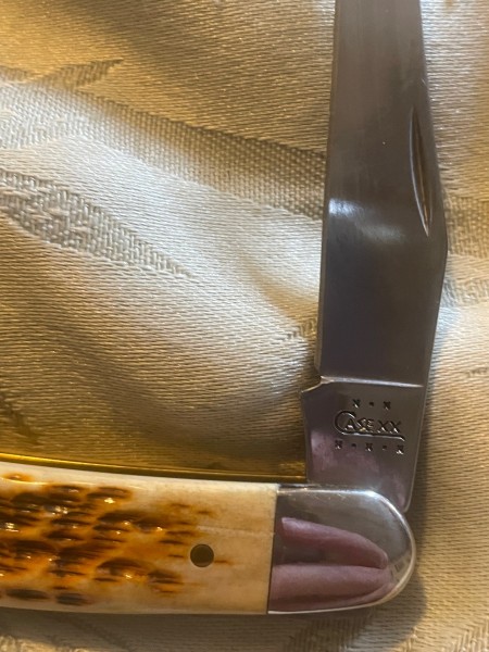

Can someone tell me about this knife? No pattern number just Case xx on both blades.
Mumbleypeg
Posts: 14583
bcyoung826 wrote: Sat May 27, 2023 6:53 pm Can someone tell me about this knife? No pattern number just Case xx on both blades.
The knife is a “Muskrat” pattern, which to my knowledge has never had a pattern number. The knife has two identical “master” blades. Sometimes you’ll find a Muskrat on which the date code year stamps are mismatched (occasionally by several years). And at various times Case stamped the pattern name “MUSKRAT” on them. See the Case Pocket Knife Pattern Name Guide in the Research section here: https://www.allaboutpocketknives.com/ca ... -guide#d-o (scroll down to find the Muskrat pattern).
