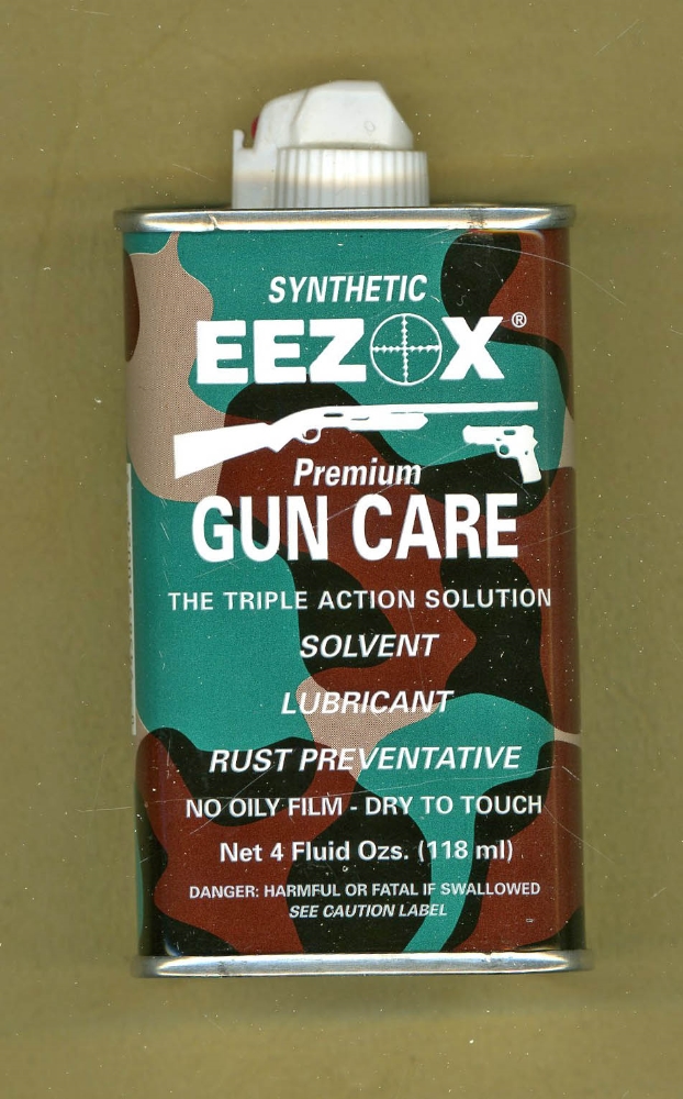

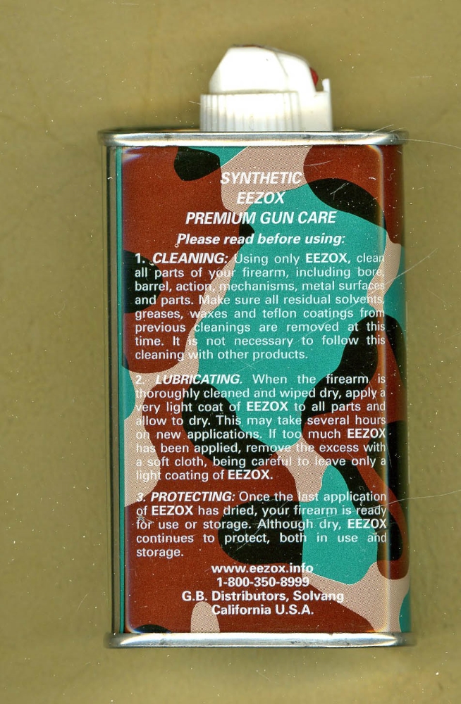

- orvet
- Posts: 19885
Re: Knife Polishing Removing Rust Pitting How To
I missed Paul's post on preventing rust in a knife that has had some problems with rust.
I agree with all the steps used in cleaning it and drying it but my last step after it has been washed, WD-40ed, and dried with compressed air, but after that I apply a liberal coat of Eezox. Eezox is a product made for firearms and rust has always been a problem with firearms. Eezox works as a lubricant as well as a rust preventative.
Birchwood Casey's Barricade and CLP's Break Free are also supposed to help prevent rusting on firearms.
If it will work with firearms it should work with pocketknives!
I have used all three products but Eezox is my personal choice for rust prevention on a knife that I suspect will be at risk for rusting.
