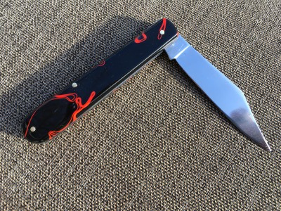

Another one of the knives that was in a group purchased from E-Bay. I was kinda surprised at how cheaply this knife was made. It had the hollow scale/bolster design that I've come to hate. I originally was going to use some spalted tamarind wood for the handles but the wood seemed softer that what I was looking for so I dug out some black Kirinite and used that instead.

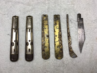

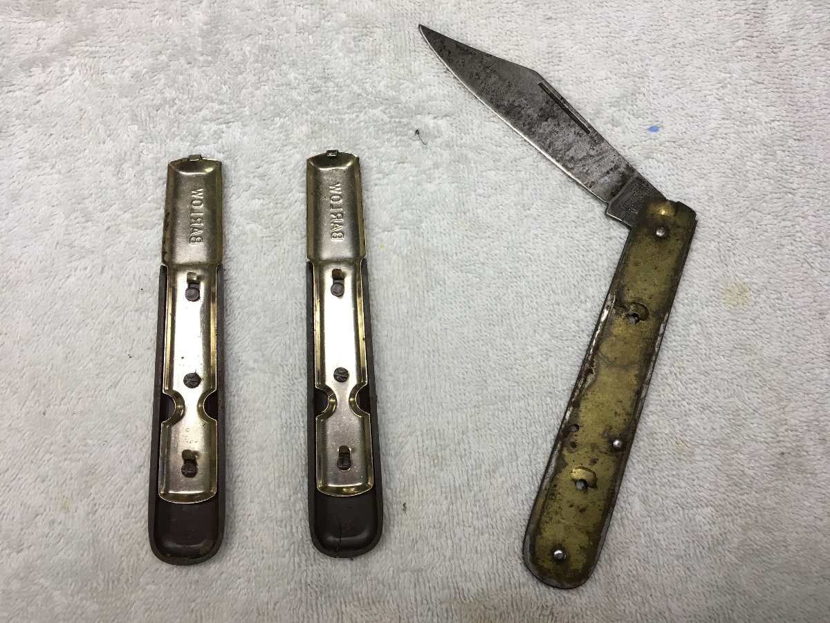

Nothing outstanding in the disassembly;

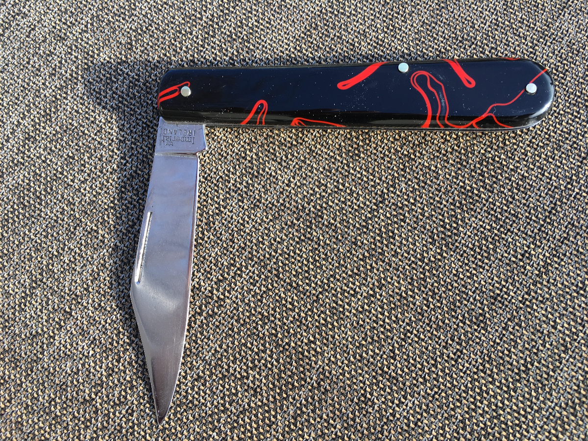

I cleaned and flattened the liners out as I was no longer going to need the raised tabs and cutouts for the hollow handles. Polished the backspring and reassembled with some black Kirinite scales with red accent stripes.

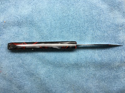

I ended up with a small crack at one of the pin holes.I used a technique where you put super glue into the crack and then sprinkle it with baking soda. The baking soda causes a chemical reaction and instantly sets the super glue. I was able to sand and polish it within seconds. I saw the technique online in a video.
Here it is all polished and ready for the shelf;
Thanks for looking.
Jeff

Jeffinn wrote:Another one of the knives that was in a group purchased from E-Bay. I was kinda surprised at how cheaply this knife was made. It had the hollow scale/bolster design that I've come to hate.
Jeff, how could you disparage my beloved shell handle design?
I agree they look cheap, and they are inexpensive to manufacturer but Imperial did something right; they used good steel! They also constructed the shell handle so that even if the handles fell off of the knife a person could still keep the inside liners and blade and have a functional knife. The fact that they endured and were manufactured until 2004 is a testimony to their market appeal. The fact that you still find tens of thousands of these at flea markets around the country as a testimony to how well-made they were, in spite of being cheap.
The sheer genius of the shell handle design and the timing of introducing it during the depression was kind of a perfect storm. I believe it kept Imperial solvent through the depression until they received government contracts in World War II.
All that being said, I still enjoy turning them into "real knives" was solid bolsters, and you did an outstanding job on this one! I am usually not a huge fan of Kirinite but the clean, shiny black, high polished look on your knife is beyond my expectations of Kirinite!
Well executed Sir!
