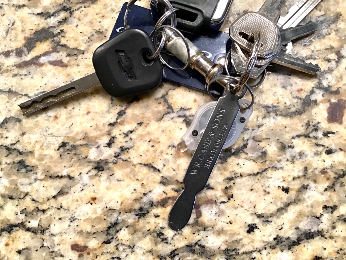

I’ve had a knife pick on my keychain ring for about as long as I can remember, for exactly the reason you stated. I don’t use it on my EDC, but if/when opening a lot of blades or a stiff one is encountered, it’s handy when needed. It’s just like another key on the ring so not bothersome carrying it, at least not to me.
Just realize that the pick can slip off the nick and possibly scratch the blade, so don’t use it on a valuable collectable unless you’re very careful. ::nod::
Here’s the one I have at present.

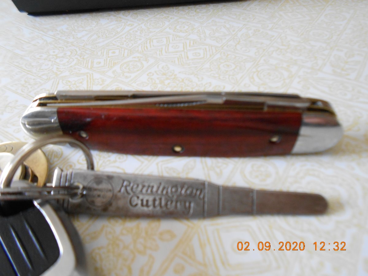

John, I had to use a pick on a new to me knife just this past weekend. I have a Remington knife pick on my car key ring. One of our AAPK members added it to a deal we made a year or so ago. Not sure if it's real or a reproduction, any way it works very well! And thanks again to who ever sent it to me, I apologize for not remembering who it was. :oops:
Treefarmer
Excuse the blurry photo

Philip, it was me and it does my heart good seeing that it is useful to you. Thanks. ::tu::

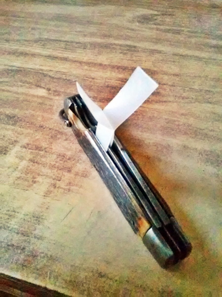

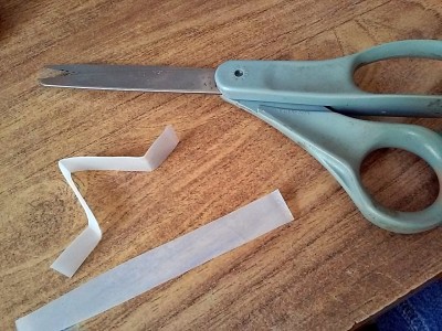

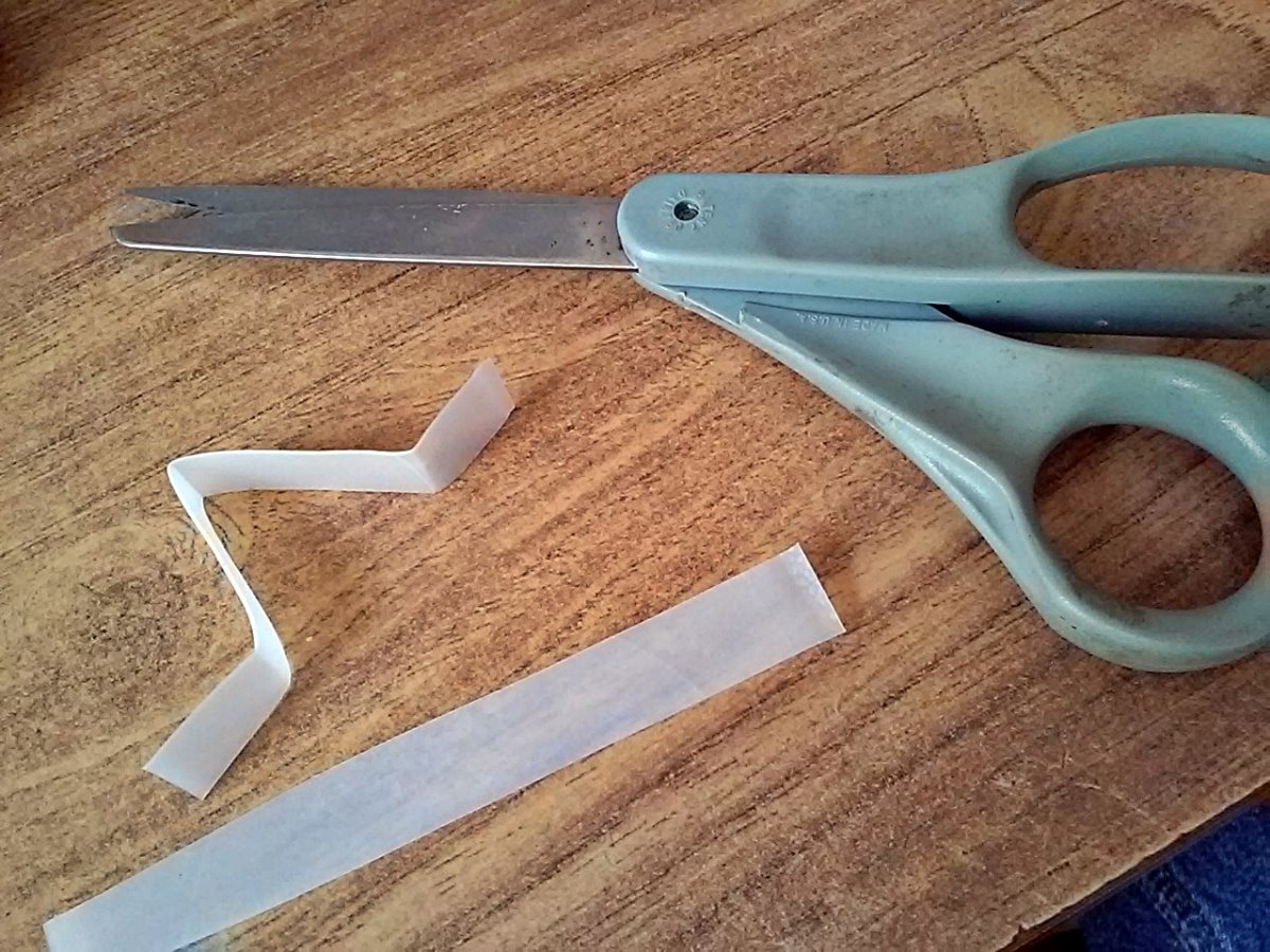

Don't have one of those fancy dancie knife pics? Don't want to spend the money for one? Got one but can't find it right now?
Cut a strip out of a milk jug. Fold it in the middle. Slip it down into the blade well and underneath the knife blade. Pull up. Ta Da. Mechanical leverage at it's best. (A folded business card works just as well)

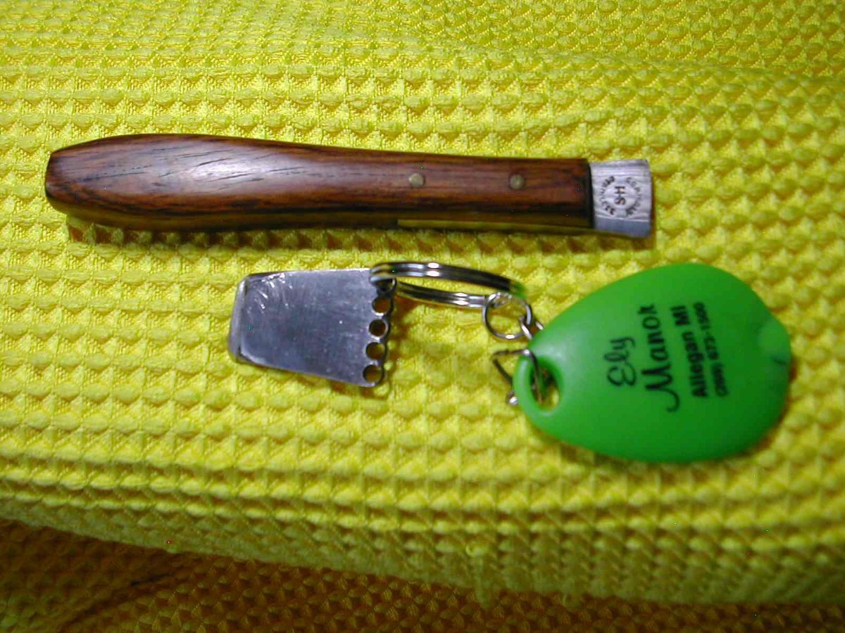

I bought this kitchen tool at a garage sale for $1., not knowing it is for zesting Limes. shaving off the rind for cooking. I hack sawed of the business part and put both in a vice and filled down the ends to a step for a knife pick. one for the bench + to carry.

::tu::
