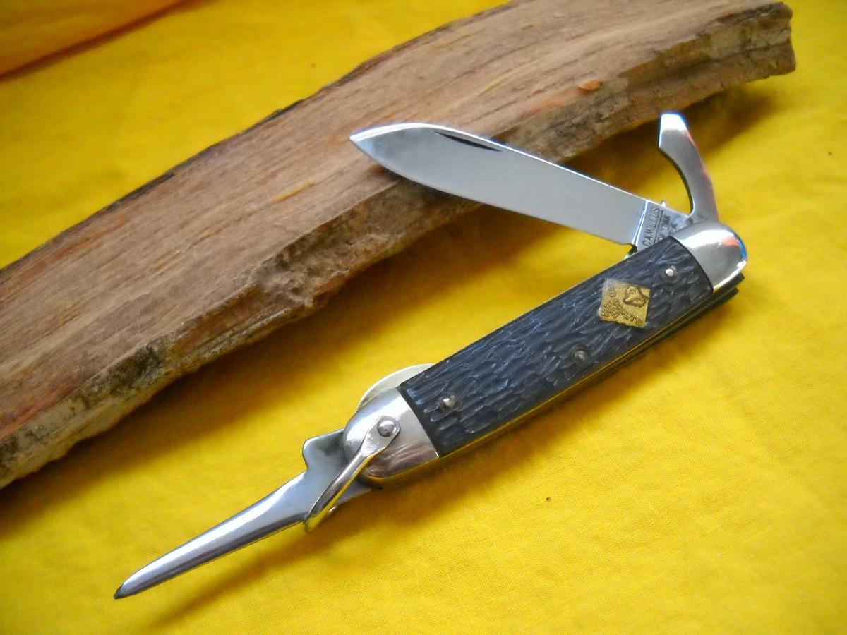

Acceptable is defined by the owner!!

Bravo Cato!
First rate job. That baby has got the WOW FACTOR now.

cato wrote:how do you like me now....

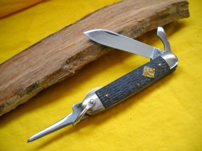

Knice cato!!!
I got one.....

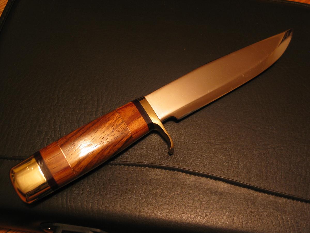

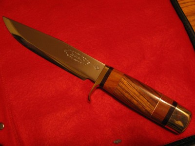

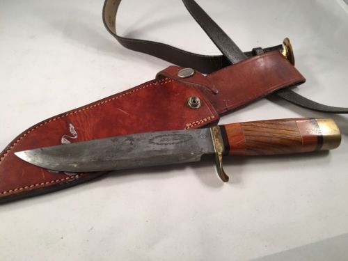

Nice 3 F ,
I am with mumbleypeg, on slow and steady, most of the cleaning is knowing when to stop
and which knives to clean , i was able to get a couple of custom fixed blades, i have been working
on for awhile cleaning up, they were mainly neglected with light sharping , but my only ones
this one is the L. E. (RED) BROWN HAPPY WITH THE WAY IT IS TURNING OUT

Scott excellent job. You are the master and I the student.TripleF wrote:Knice cato!!!

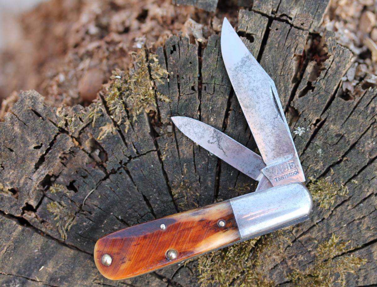

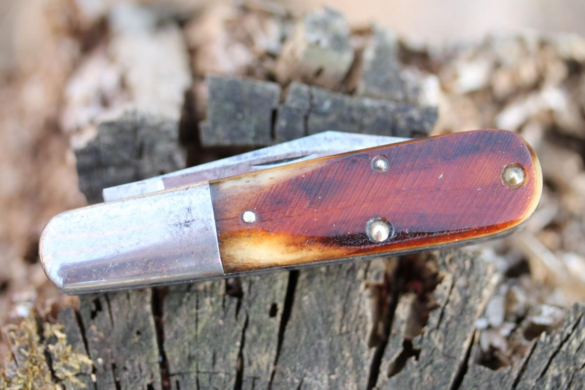

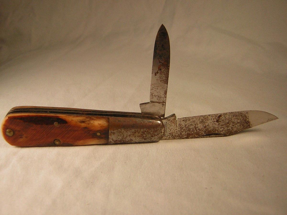

I try to clean a vintage knife without taking away its hard earned patina and history. I soak the knife overnight in mineral oil, use 0000 steel wool, lots of q-tips. For rust I have found a product, Big 45 Metal Cleaner works well with out damaging metal, I use it with plenty of mineral oil and it cuts the rust right off.
http://www.big45.com
I finish up with some green buffing compound on a strap of leather and hand buff, never a buffing wheel.
I recently found an unused but rusted Case Tested Barlow, here are the before and after pictures. The rust is gone, still has the staining from the rust but I would rather have that than the shiny over buffed look.

John Nice job on the Barlow. Nice knife.

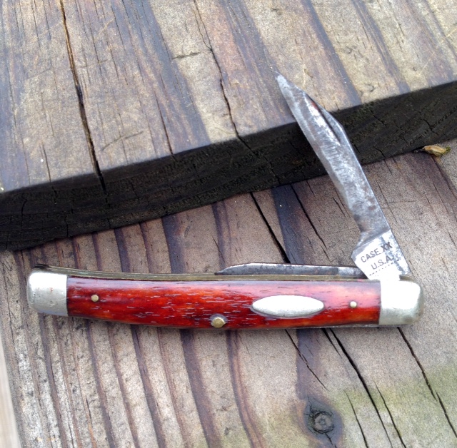

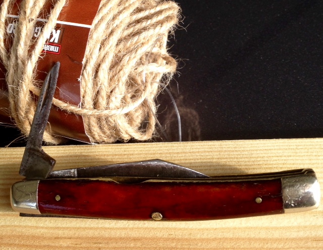

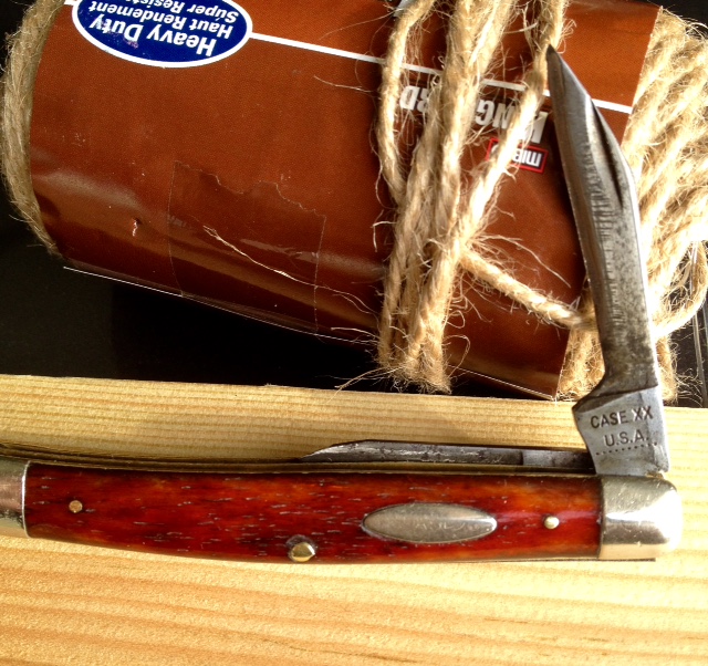

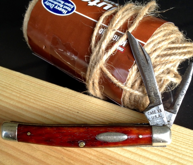

Here is the Case Knife 1970 Medium Jack that I cleaned up.
It turned out pretty good. Got the snap back to it. The blades
were pretty heavy with rust. The pen blade is really small--- the
previous owner must have used it extensively (I guess it will be
really useful if you need a very small blade) Bolsters cleaned up well.
27 gm 3.25 inches long
First picture is before cleaning.
Bob
