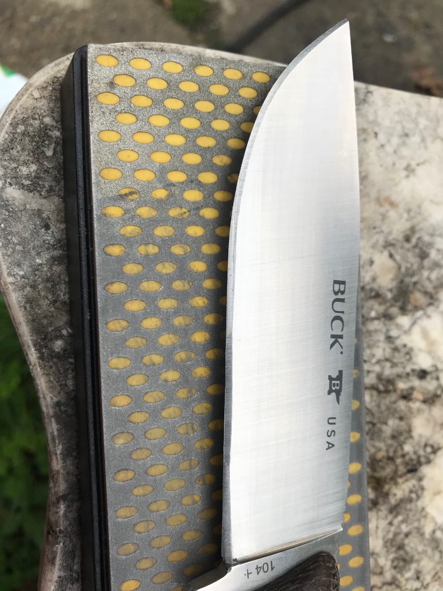

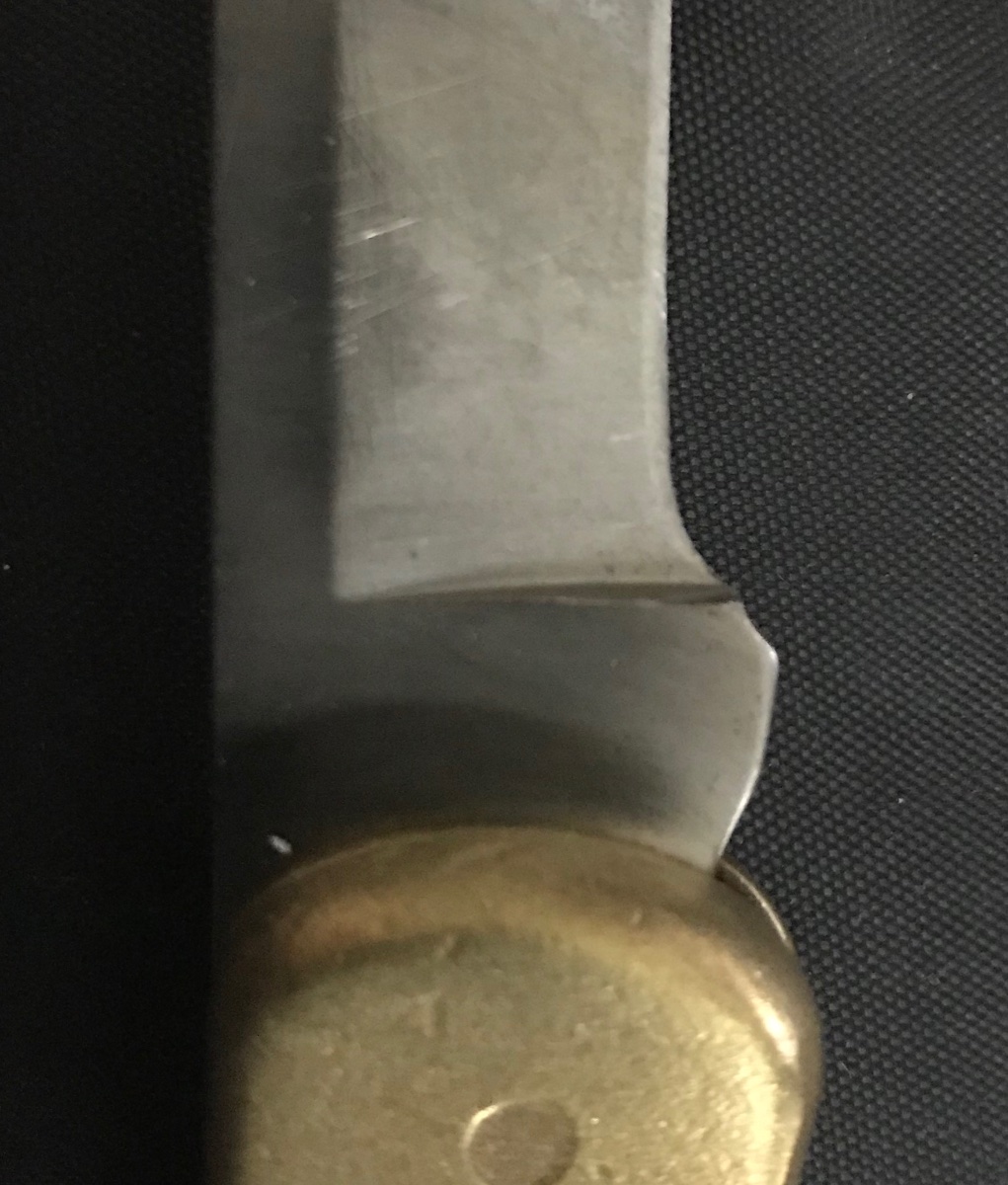

My apologies for the vague title. But I couldn’t think of a short title that explains this. Basically I hate recurves even subtle ones created by a bad choil area.
I think it’s caused by round corners on the stones at the factory. The trouble is these knives ruin the corners on good stones which ruins knives sharpened after that. If you are not careful.
It grows with each sharpening.
Each time you sharpen the curved part gets longer and longer. Or farther and farther from the ricasso.
Even worse it will lift the blade off the stone so it only contacts the belly leaving an inch of blade that doesn’t contact. And premature wear on the contact point.
I don’t necessarily like sharpening choils, but if they are very small they are ok.
From the factory
From the factory
Small choil cut
Small choil cut
After sharpening.
After sharpening.
I cut the offending part out with a cut off wheel. Very careful to not go too deep. Then sharpen them normal on a diamond bench stone being sure to keep the corner pressed against the ricasso. Then I sharpen the belly to the point separately.
If done right after several sharpenings my little choil is gone and if carefully sharpened I won’t ever have to cut another one.
If the edge is not straight from the ricasso to the belly I am not happy. In kitchen knives I think this is caused by sharpening steels. Or generally bad sharpening. Ever seen a recurve wharncliffe? ::facepalm::

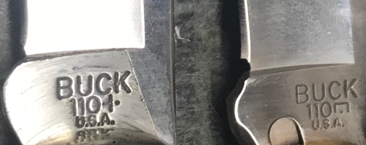

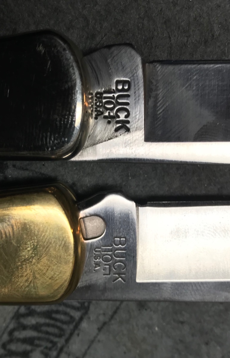

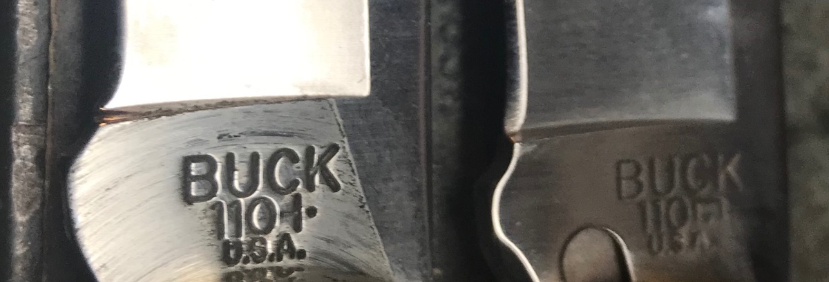

Also I try to keep the edge parallel with the spine. So the basic blade shape stays the same for its entire life it just gets narrower. As opposed to becoming a stiletto shape. Like the 110 below. This is caused by the slicing motion while sharpening. The closer to the ricasso the less time the blade is in contact with the stone. Again keep the corner of the stone against the ricasso.
Loss of belly.
Loss of belly.
For me it is about maintaining the integrity of the blade even as it’s sharpened down.

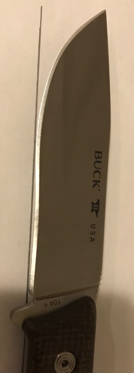

Here is another one with a slight factory recurve. Not sure if it’s intentional or not, but to my eye it shouldn’t be like that. This is a brand new Buck knife.
I’m going to “fix” this one by trying to take out most of the material from the choil to preserve as much of the belly as possible.
eveled
Posts: 2582
Re: My sharpening pet peeves
Post by eveled »

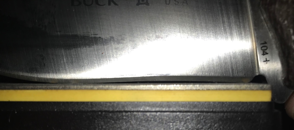

Now it’s straight. You can still see the factory grind on the edge bevel directly under the anvil logo. You can see how much of the choil was used up to get it like this, but I left the belly intact.

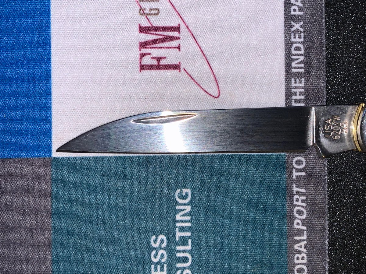

My biggest pet peeve is how absolutely awful factory grinds are on Case wharncliffe blades. The grinders don't take the time to try and maintain a straight leading edge - far more often than not, seems they always grind too deep and impart sort of an arc/curve in the last 1/2" or so near the tip. It takes alot of work to straighten the edge with a file and then start from scratch regrinding the entire edge profile - sometimes, it requires removing so much steel to get it back to straight that the blade is thinner than should ever be just to correct careless factory grinding. I just wish the grinders at Case took a little pride in their work (you do not see this kind of careless grinding coming out of GEC on their wharncliffe's - its a matter of taking pride in work over just grinding blades as fast as possible to fill the tray of finished knives ... I get that Case puts out probably a hundred knives to each knife GEC puts out, but there's a point where this kind of thing should be caught by quality control over at Case and this careless behavior CORRECTED). Here's what I'm talking about --->

::facepalm:: That’s pathetic. ::dang::

John. the issue with Case may be carelessness. But it might be ignorance on the part of the grinders or the QC personnel, or even higher management. You might consider notifying Case, just as you did here, including photos. It would be very interesting to learn their response.
