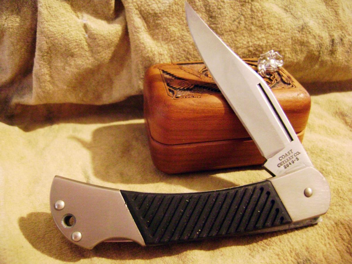

For the life of me I can't come up with a logical advantage for the "patented split tang". Seems like someone came up with that brain child and marketing ran with it.
You mentioned Coast. So it's possible my Coast lock back was made by Western?

Jerry, in addition to the advertising claims, there are some advantages to the split-tang construction. It allowed the use of one blade blank for both stacked-leather-washer handles (usually found only on stick-tang knives) and for handles made with traditional scales. This could add up to some significant savings in tooling and inventory: use one setup to make the blanks in bulk, then pull them from stock and finish in whichever style was being ordered.
Split-tang construction works well for the use of traditional scales of wood, bone, plastics, etc. It works well for stacked leather washers too, but doesn't hold up as well due to the additional exposed but unsealed leather along the surfaces of the split tangs. It is a trade-off. For my purposes, I can spend a few hours re-building the stacked-leather handle on a stick-tang knife, or maybe an additional hour doing a Western; I consider the additional time well-spent to get the quality of steel and heat-treatment used by Western. Re-building a "normal" flat-tanged knife with solid scales takes about the same amount of time as does re-building a Western with solid scales, so that's a wash.
I can't tell if your knife was made by Western--my focus is earlier, and it doesn't look like any Western I know. But then again, that style of handle seems to have become popular after the time when Coleman purchased Western, so it could have been made by Western under Coleman ownership, or even by Camillus. I'd look for similar knives (and handles) in Coleman and Camillus pricelists/catalogs.
