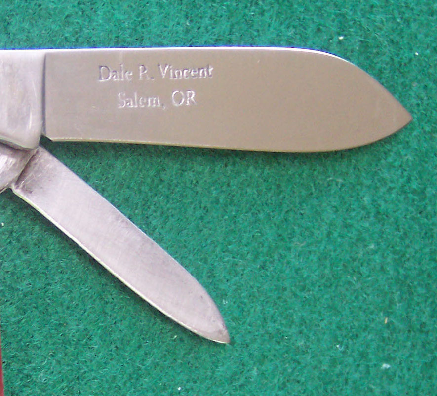

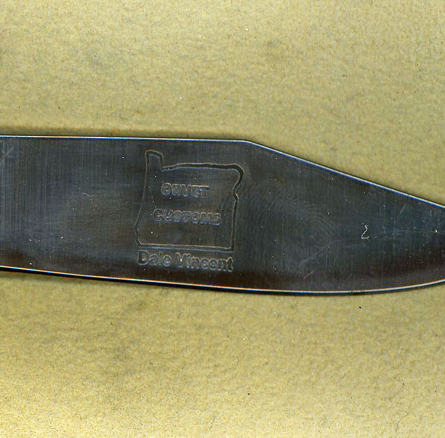

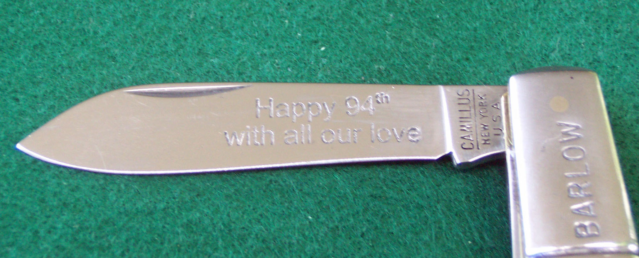

My name & logo are etched into the metal using an Electro-Chem Etch machine.
Here is their web site: http://www.ecemmi.com/index.html
With direct current it removes metal from the blade and deposits it on the felt pad that is soaked with an electrolyte solution and placed between the blade and the electrode. The stencil is placed between the blade and the pad and that is what gives form to the etch.
By using alternating current it leaves a black mark on the blade. You probably know the electrical theory better than I do, but it all has to do with the fact that current flows both ways.
Here are examples of my etches:
My first stencil with my name and city: My new logo stencil on a work in progress. You can actually see it better before the blade has the final finish on it: This is a special stencil for a customer: It was for his grandfather’s 94th birthday. When I told the Electro-Chem Etch folks what it was for, they didn’t even charge me for the stencil. They are nice folks to do business with.
I do know there are hardened steel stamps available. I have contacted a stamp maker who advertises in Knife World, but they are considerably more expensive per knife than the Electro-Chem Etch method.
