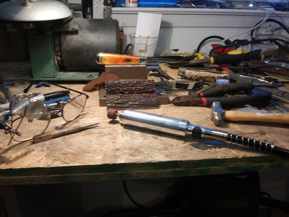

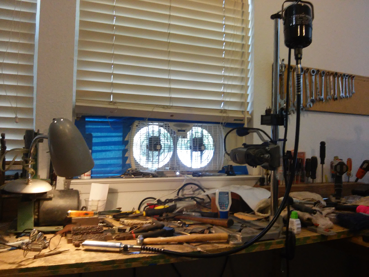

Wow, everyone has a nice looking shop! I got some new equipment this week. A cabled rotary tool with foot pedal control. Variable speed too. Both hands are free to work with. I have a cable attachment for my Dremel workstation but this is better!
Has a real drill chuck instead of the system used by Dremel.
And I discovered that I can plug my first gen Work Sharp into the pedal and now I have slow enough speeds that it has become very versatile.
Good tool so far. ::tu:: Got it on eBay. $60.00 shipped!

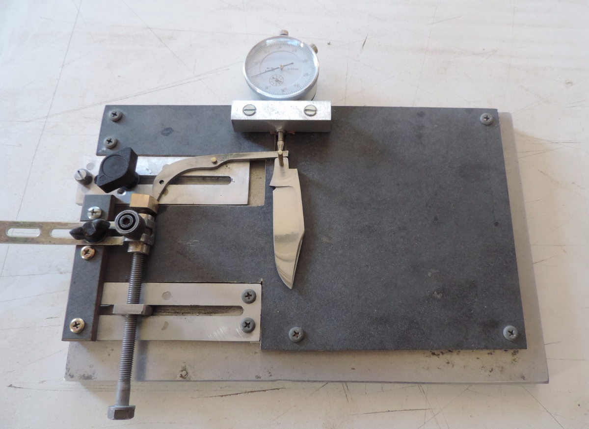

Love this thread... I have learnt so much. They say “Necessity is the mother of invention” but so often in my case “lack of money is the mother of my inventions” :roll:
A couple of recent creations as I get into making slip joints from scratch – up until now most of my dabbling is around re-working existing knives.
A rise and fall gauge … the actual gauge cost $19 off that auction site the rest of the 'stuff' surfaced from various parts of my shed.
Also I wanted to start relieving the area of the scales where the tang rotates. I don’t have a Mill or access to one so again to ‘that auction’ site for a small east/west vice $40 shipped out of China. Some other bits & bobs out of my handy shed pile and a basic drill-press becomes a rudimentary mill. I still have a few minor adjustments to make but the test-runs are going well.
Edit ... I should have added the Chuck is pinned to the Drill press shaft to prevent it shaking loose.

Nice set up Derek! The tools in my shop are all re-purposed. I have one drill press that a dedicated buffer as I dont have a bench mount buffer. I like it better as the speeds are slower and I have a choice of speeds. I like the way you set up your shop Derek! ::tu::

Randy, I'm sure yo'll enjoy the variable speed rotary tool and looks like you are going to get the most out of the variable. Fantastic buy!
Derek, you are doing some great work on your tools so I'm sure the folders will follow the coarse. Great innovation.

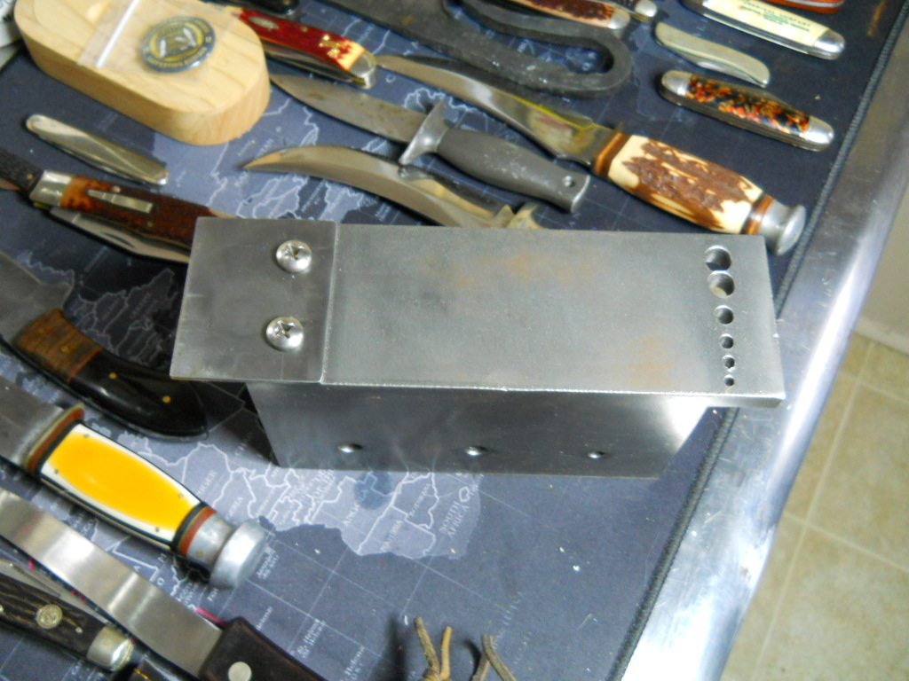

Post by americanedgetech »
I'm almost finished with my Stiddy, and I had the camera out so I figured I'd post a pict of the progress.
The basic block is 11L17 cold finish steel. Hard surface, and a soft core so I could easily machine it without heat treating or annealing.
The tang that is on it now is 4130, and is 0.07863" thick. I have some S-7, and W-1 steel on the way to make interchangeable tangs from in varying thicknesses, and hardness.
For now there are two 1/4 x 20 machine screws holding the tang but tomorrow I am cutting a 1" round piece of 4130 lengthwise to get a half moon piece or cap to sandwich the tang with recessed cap screws onto the block. I figure that spreading that load across the bar would be much better than a couple screw heads. Plus that will leave an area for krinking.
The only other modification I need to do is add a few dimples to the surface to seat pin heads into for secure peening. I think I'll add these to the side of the block.
All in I have about 60 bucks worth of steel, and enough tang material to make around ten spares of each grade.
Time wise it took about an hour to drill the holes, tap the threads for the tang, and about 1/2 an hour in the mill to cut the end below the drift holes.
I call that time, and money well spent. ::tu::
The messy work table is just a spare table in my lab room but I needed somewhere to stage from until my shop is built,
I have a grinding, and polishing bench that I am working on building as well so I'll try to post that up tomorrow.
