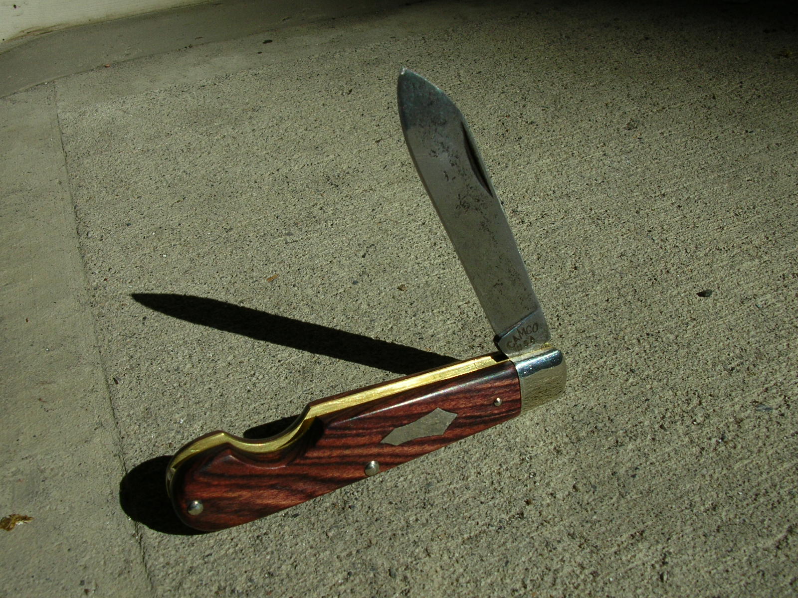

I just finished a 77OT Muskrat that had one broken blade. I used red jigged bone for the scales. I like the look of the pins so I decided to put the scale pins in. When thinking about spinning the heads, I had an epiphany.
I put the head spinner in my drill press vise and chucked a short piece of 1/16" brass pin stock in my drill press. I then spun the pin into the stationary head spinner.
It worked so well that I made up a bunch of pins. I would taper both ends of a piece of 12" pin stock then cut off about 1" lengths. Inserting the tapered end in the chuck I spun the heads on to the pins. I did a dozen pins in about 20 minutes, maybe a little less.
I just thought I would share that method with you. It works well when you only need a head on one end, like for handle scales. I just peen the inside end of the pin on the liner, then file it down.
