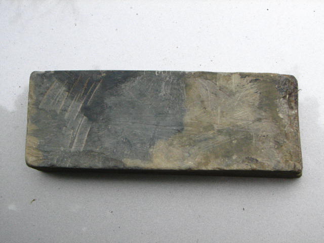

On Arkansas stones I used honing oil for many years. I cleaned them after use with a drop of dishwashing soap, a toothbrush and tap water.
No matter which type of stones you prefer, keeping them clean is important!

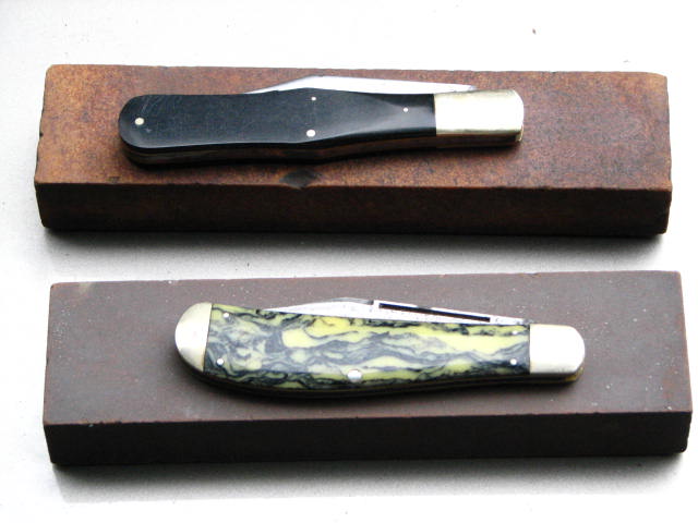

Being the cheap-and-lazy type, most of my stones come from auctions (where an old oil-soaked stone will often sell for less than a buck, because after all--who wants to clean them?).
Cleanup is easy. Put the stone in a pan or bowl (I use a cheap plastic shoe box from Wally-world). Put on rubber gloves. Spray the stone down with the cheapest oven cleaner you can find. Take the foam-covered stone and put it in a ziplock bag.
Let the stone sit over night. Put your gloves back on, open the bag in your sink, then scrub the stone with a wire brush. Oil and dirt are gone, and you can see what you actually have.
the dried soaked-in oil will come out this way, and the surfaces of the stone will be clean. If I need to dress the stone to flatten it out, I rub it on the side of a cinder block.

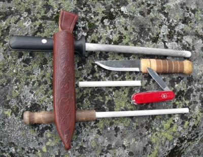

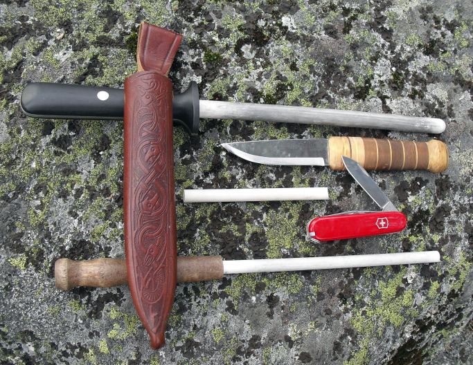

But I like to take my edges one step further and for that I frequently use ceramic rods (sticks).
These are reasonably priced, quite effective and easy to use once you get the hang if it.
I use mine for all kinds of knives, from Chef's knives to small pocket knives. The big one is used mainly in the kitchen, the medium sized takes care of most fixed blades and pocket knives at home and the short one is used mainly for quick touch ups in the field.

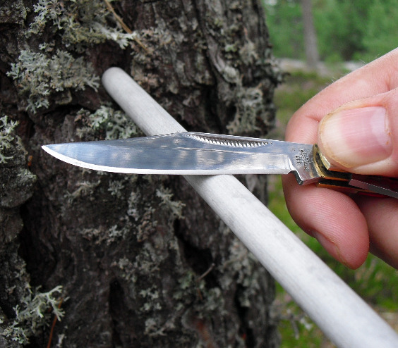

When using a ceramic rod freehand, I definitely do not try to mimic the frantic whackety-whackety stuff that chef's always do when steeling. I'm rising the spine of the blade a hair higher than when using the diamond stone and move the edge controlled and carefully along the rod from base to tip. You can hold the rod still and move the knife or you can hold the knife still and move the rod. The important thing is maintaining the angle through the stroke so that the cutting edge is constantly touching the rod.
Just as when using the diamond stones, I start out applying some pressure and then gradually reducing it. For the last few strokes I apply minimal pressure.

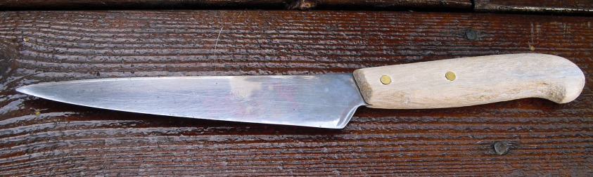

I asked my better half about the kitchen knives and she told me that one of them she could clearly remember from back when she was a child. It was hopelessly dull even back then and it has never been sharpened since.
Here it is:

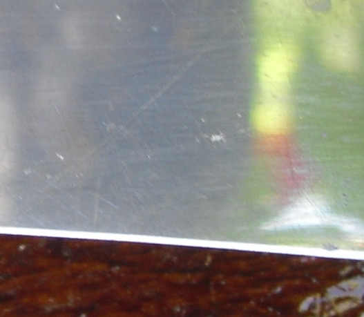

An old and inexpensive kitchen knife, but made in Eskilstuna, Sweden with Swedish steel. And those are good knives.
After establishing a new edge with the diamond stone and refining it using a ceramic rod, the knife was sharp for the first time since it left the factory many years ago, and probably sharper now than ever.

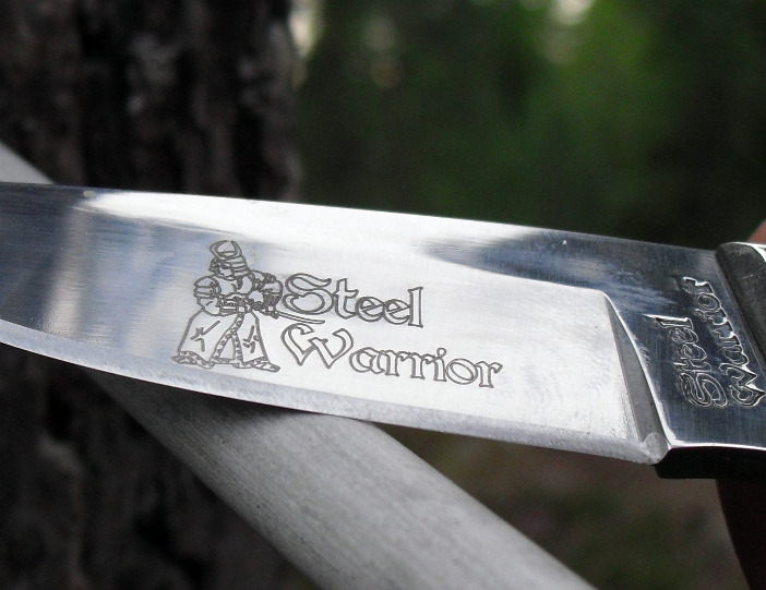

To get your knife shaving sharp you need a decent steel, but you don't need an expensive top-shelf super steel. This fixed blade from Steel Warrior is certainly no expensive knife, but it will take a shaving sharp edge.

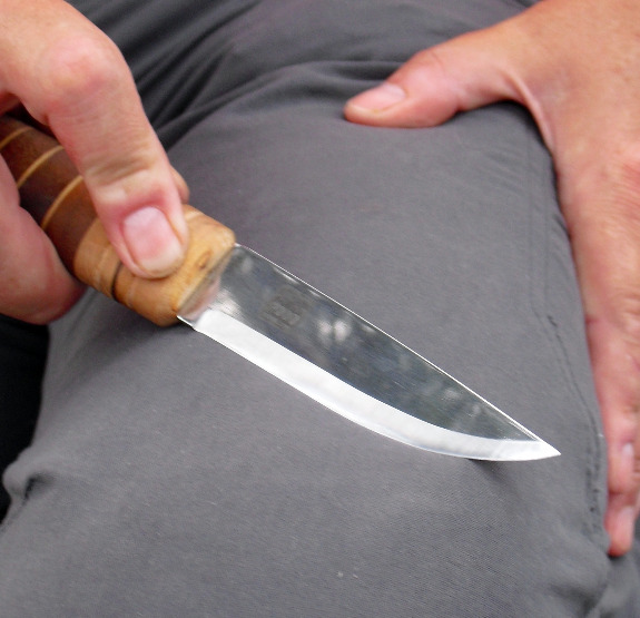

Of course you can not sharpen your knives on your pants, but you may take your edge that final minor step from shaving sharp to hair-popping sharp. This is not about steel removal, but taking care of some micro-burr that may still remain.
Try it and see for yourself!

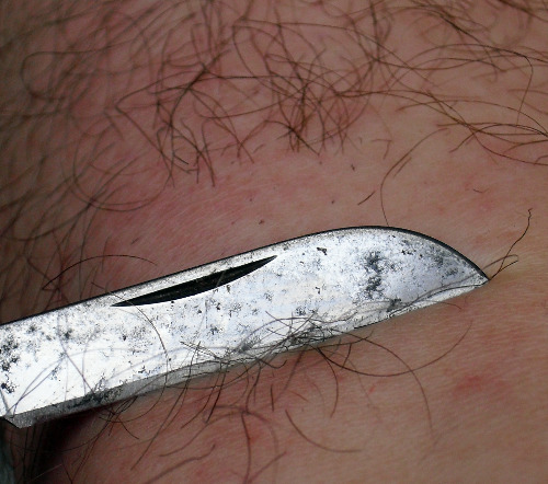

Old and well used McCoy, but shaving sharp.

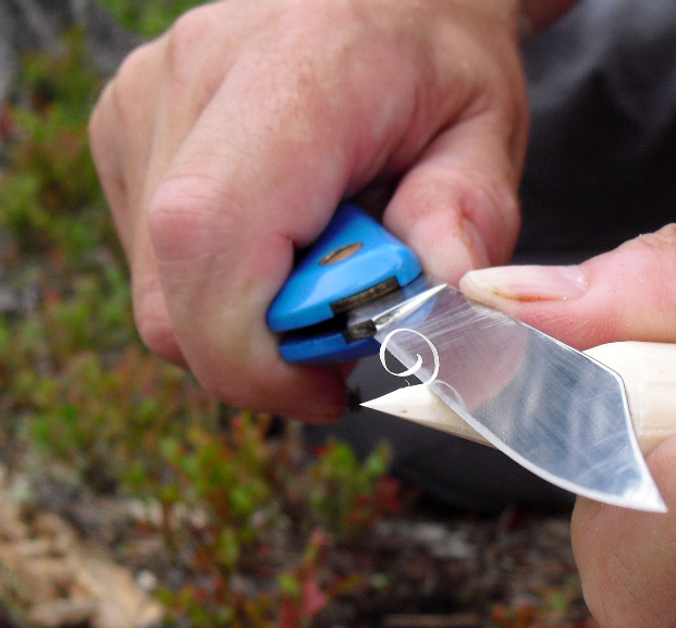

I purchased this EKA from a Swedish gentleman at a fair earlier this month. Nice model for hiking, but it was a bit scratched up from sharpening and very dull.
No problem. After some sharpening and care it makes those thin shavings that I like and is ready for new adventures.

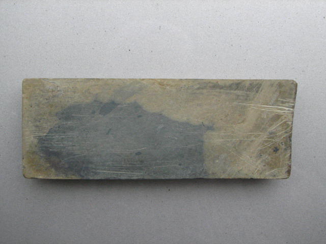

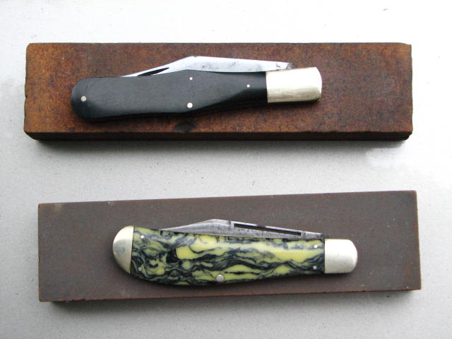

I thought I would bring Mikes old thread up to include some stones I got last Sunday.
I love old stones and I have blathered far too much about them, but wanted to show these off and ask about one in particular. I'm just guessing, but the odd shaped one seem like it could be a Belgium water stone.
Anyone have any thoughts on this stone? It's about 7" X 21/2" X 1".
The other two are very nice white and black Arkansas stones. About 8" X 2" X 1".
A girl was selling all her fathers carpentry tools. (UGH!!) The stones were about all that was left.
