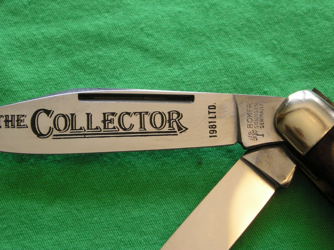

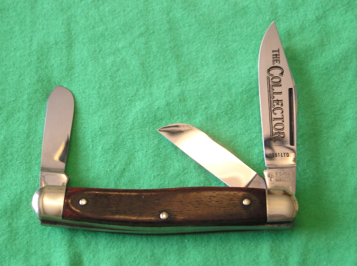

Here's a wild one for you. Whip out your copy of Mark Zalesky's Boker Tang Stamp article from Knife World magazine for this one. Compare the tang stamps and dates in the article to the ones on the 1981 Limited Edition knife. Shows me just how hard it is even for Boker Solingen to keep up with the history of this company.
Of course they were limited to only three blades. ::shrug::
By the way: This knife as shipped from the factory would have had two shields "glued" to the handle. The old tree logo on the left, and the new logo they used in 1981 on the right. You rarely find one with both shields still attached. The joke is that the little velvet bag in the box wasn't for carrying the knife in, but for keeping the little shields in when they fell off!

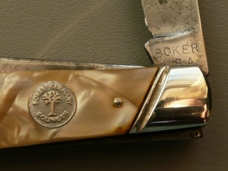

Thought I'd revive this old thread with a new shield I saw on a 9885 pattern for sale on ebay.
Here's the link for more pictures.
http://cgi.ebay.com/BOKER-U-S-A-PREMIUM ... 4aa71c4380
The shield is unusual. First one like this I've ever seen.
With the Boker USA tang stamp, this knife is post-WW2.
I think the handle is celluloid and there is a lot of shrinkage. Don't know when Boker stopped using cell....
I'd guess this knife was made somewhere between 1945-1965 ????? ::shrug::
Interesting combination of BOKER USA tang stamp and Boker Germany shield. Possibly a replacement shield?
What say you?

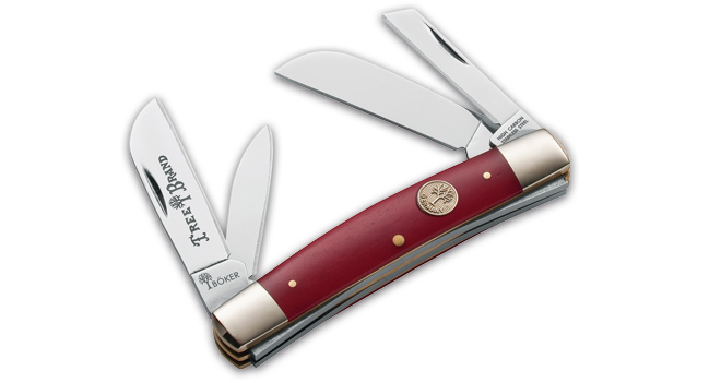

Just saw a new tang stamp and shield to keep up with:
http://www.boker.de/us/pocket-knife/bok ... knife.html
Looks like Boker has a new low cost option. Note the different style tang stamp, and shield with GERMANY under the tree. MSRP is in the area of $40!
New for 2011? Anyone know anything about this line? Look for pattern numbers 110720 thru 110733 on Boker's website.

I don't know anything about that new congress knife Blue but, if they would put a spear blade as one of the mains and use carbon steel instead of stainless for all the blades, I'd buy one.

rangerbluedog wrote:Just saw a new tang stamp and shield to keep up with:
I've gotten a couple of their small stockman's. They're German made Tree Brand and so far, I'm not disappointed. It's a bit unusual though.

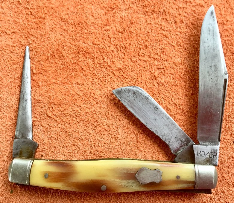

Here is a shield that is a shield..... Nothing on it....
Looks to be anywhere from 1930's to 1970's..... (Just a 40 year span)
Shield.....

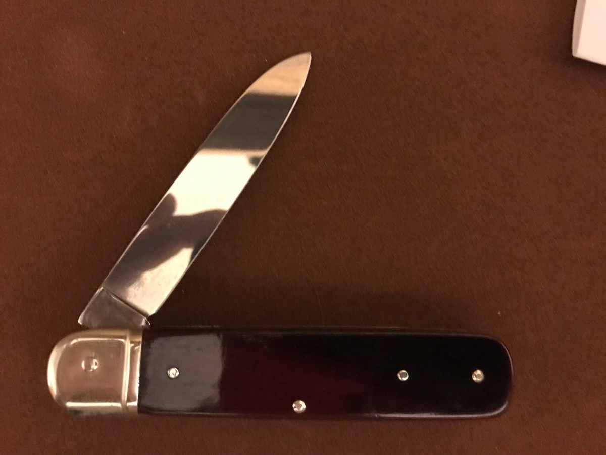

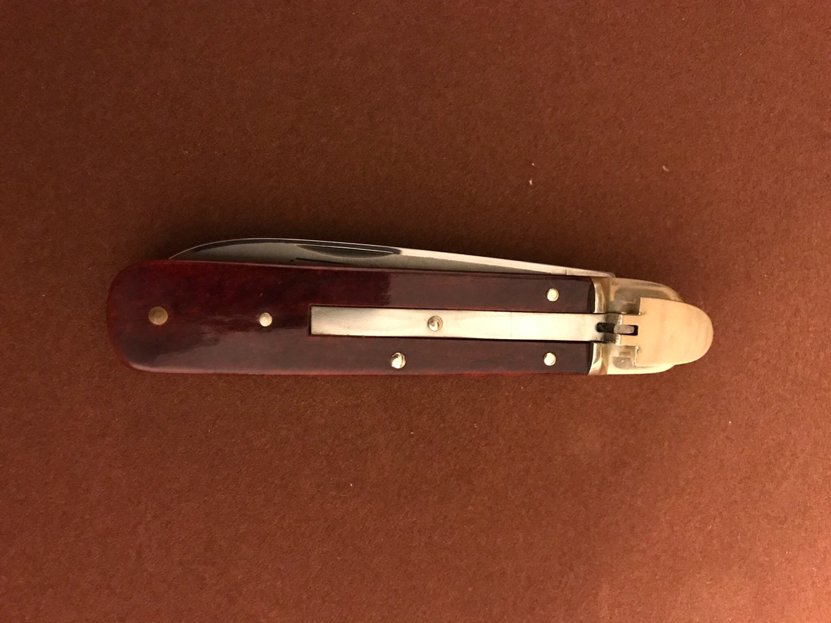

Here’s a nice smooth red bone Boker switch I’ve had a while , don’t know much about it or when it was made , very good quality made knife , fires really smooth . Not something I normally collect so it will most likely be for sale at the up coming Lakeland knife show . Any info on it would be greatly appreciated .
Thanks for looking , Mike
