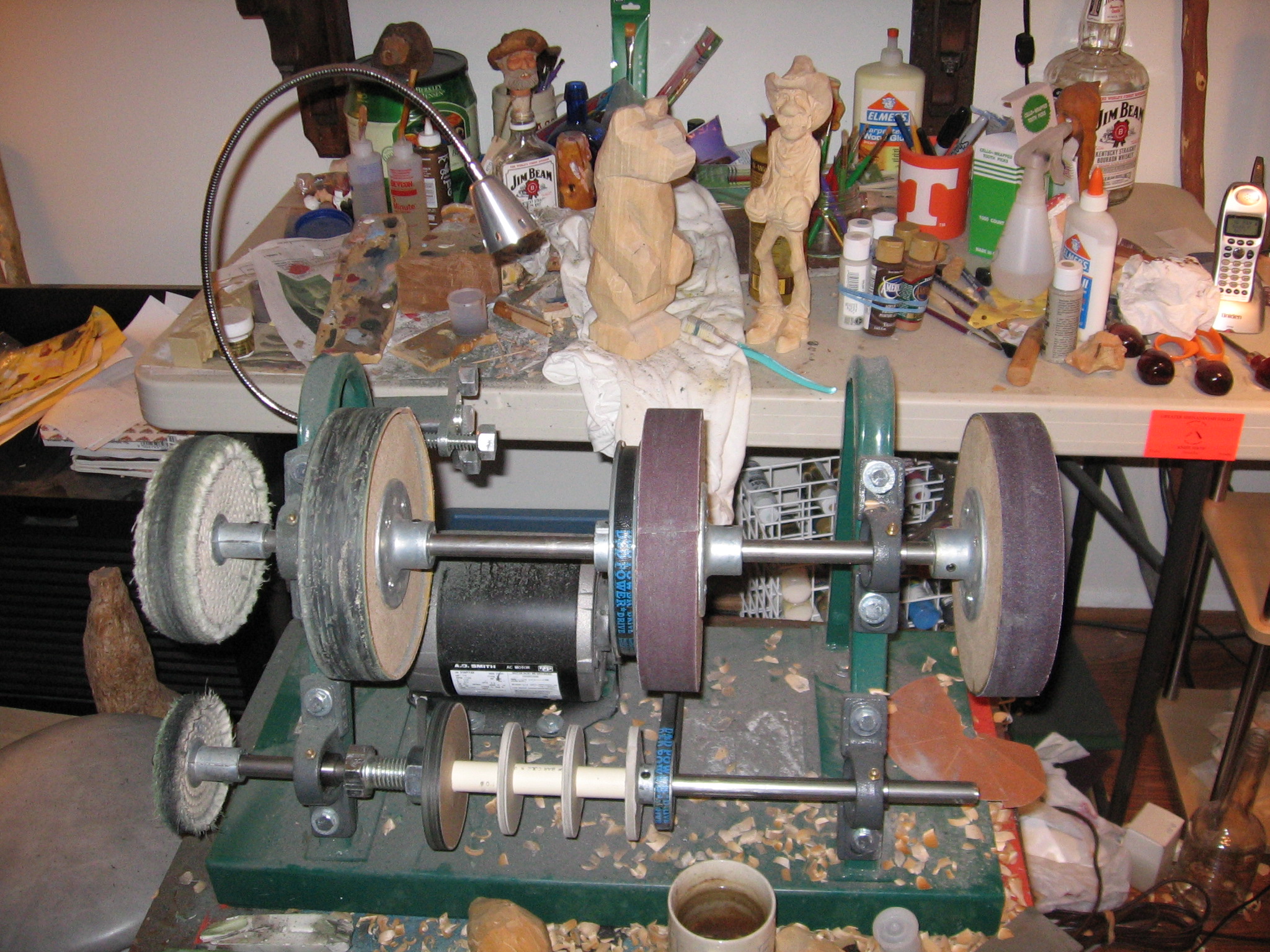

Archer,
I use a Burke Sharpening System (power) to sharpen all my palm tools and knives for carving. It works for me and is a quick way to get an edge on a tool. (also a good way to burn up a tool if not careful
)Just remember, if you use power to sharpen, heat is your enemy. And as Hukk pointed out, consistent angle of the desired bevel means everything.
I would also recommend a very good source of light when sharpening. Light will reflect any dullness in the edge.
When stropping, especially power stropping, be careful not to over-strop and "round" the edge. Again, as I believe Hukk mentioned, a knife may appear to be "razor" sharp, and in fact shave hairs off your arm, but not carve very well due to rounding caused by over-stropping. By the way, I always keep a piece of Basswood (Linden Wood) on hand and carve cross grain on the end grain to test the cleanliness of the cut. If I see any scratch marks or milky streaks, I still have work to do. A clean cut should leave no marks and a nice clean sheen on the end grain.
Also, in obtaining that razor sharp edge, there are two criteria that must be met... A "wire burr" must be created and then removed.
My apologies if I have been long winded, but I have gone through many frustrating "sharpening sessions" when I started carving and can relate to anyone with sharpening woes! Heck, I still have diffuculty with some of my v-tools and odd shaped chisels! I can post a pic of my sharpener once I figure out how to!

Re: Sharpening D2?
Well, I hope this works, my lovely wife showed me how to post a pic. This should be a pic of my Burke Sharpener as well as part of my messy carving room. Drum roll please...

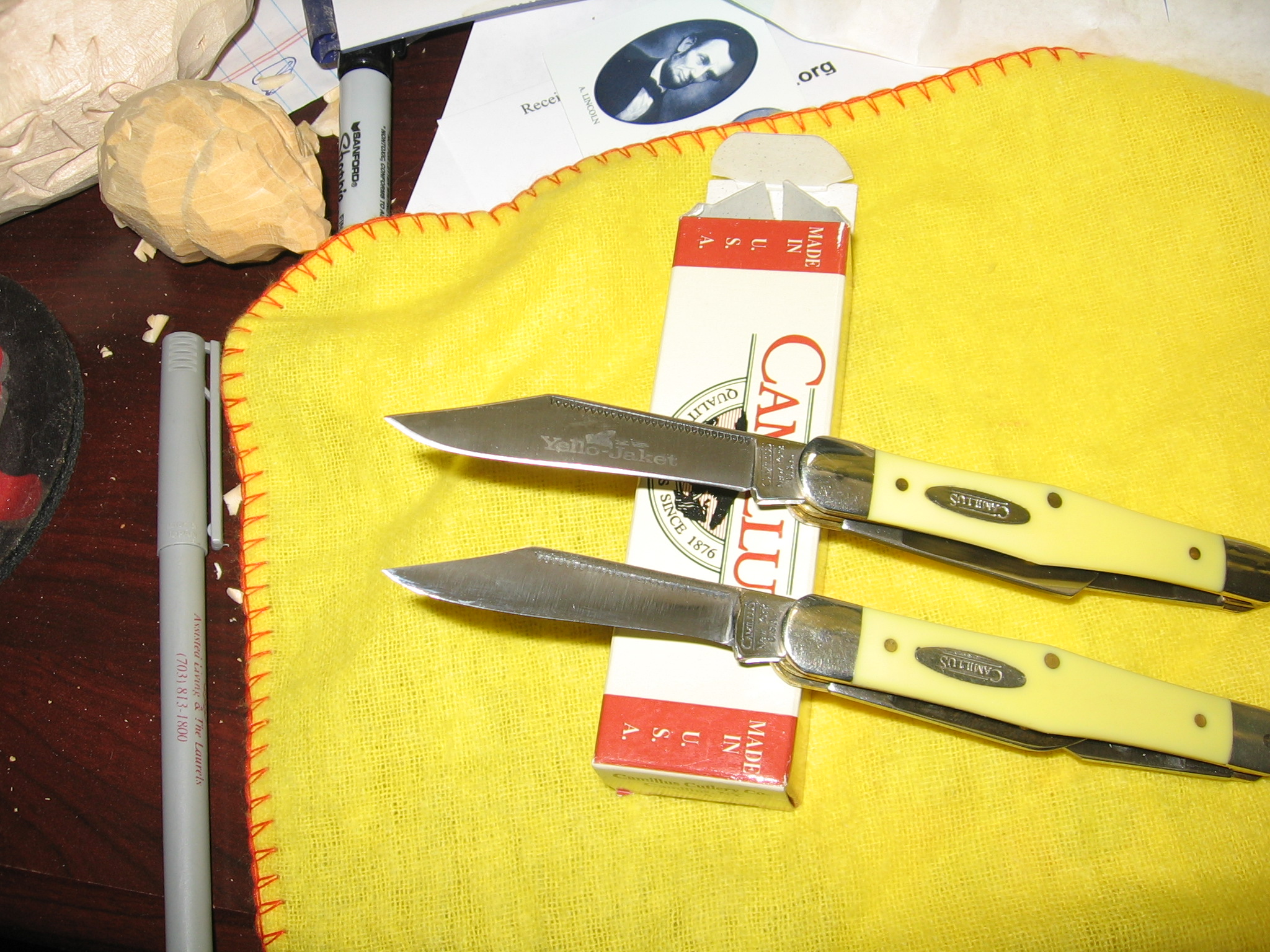

Re: Sharpening D2?
Here are two identical knives, both Camillus Yello-Jaket carpenter/whittlers, the top one is in factory condition, the bottom one I sharpened up for carving. You can see how the light plays off the bevels on both knives. note: you will notice the bevel reflect light near the tip of the knife on the one I sharpened...I had dropped the knife and bent the tip

- Froggyedge
- Posts: 1121
- Joined: Sat May 10, 2008 4:00 pm
- Location: Norway
Re: Sharpening D2?
I think you have given very good explanations! And photos too. Thank you!carvin don wrote:I agree with you, I prefer to remove the factory bevel on my carving knives as well. If sharpening by hand on a diamond stone for instance, I would lay the blade flat to the stone and take her down from there. This however, can be time consuming, hence the purchase of the power sharpener. Some folks raise the angle slightly, others even higher yet, whichever angle you choose, be consistent on both sides.
The thinner you get that edge, the easier it will slice through the wood, but is also more brittle and prone to "chip" and "nick" if you are carving through harder woods or hit a knot. Thin blades are great for detail work. ...This method works for me... I think it's best to choose a system you are comfortable with and stick with it...
I agree with you and what you have learned from experience.
Often you read that when sharpening your knife you should always try to keep the angle used by the manufacturer. I have several knives where that would mean a very steep angle and following the instruction would mean never having a sharp knife!
I am used to Scandinavian knives, which usually have a wide bevel and a rather thin edge that really bites into wood and they make good slicers too. Quite a few knives come from the factory with an edge that will just slide along the surface of the wood if you try to make some thin shavings. Knives with a thick edge sharpened at a steep angle may take a lot of abuse without being damaged, but unless you are planning to do a lot of chopping such knives will not perform very well IMO.
