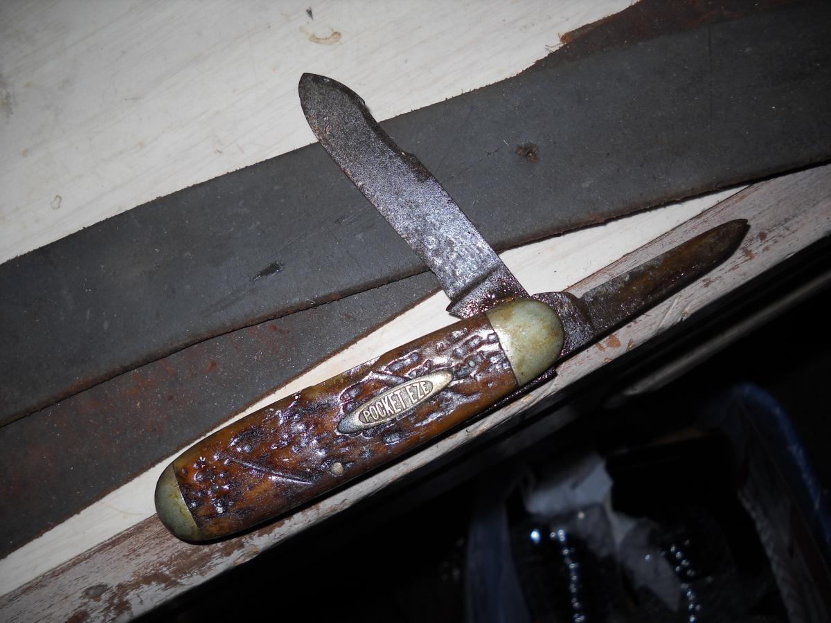

I bought a "lot" at an estate sale on the 17th of December.
This Robeson has been soaking in MO since then......I just pulled it out today. Enough of the rust has faded to where I can open the blades and they are tight and have great snap.
Unfortunately the nail nick was mising when I purchased the knife.

Thats a great knife Scott
Dremel out a EO notch in the handles and slip her in the pocket
- TripleF
- Silver Tier
- Posts: 19257
- Location: West Central FL
Re: Mineral Oil
garddogg56 wrote:Thats a great knife ScottDremel out a EO notch in the handles and slip her in the pocket
That's a good idea Dogg.....
