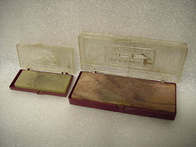

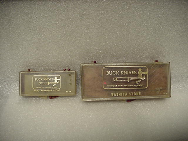

Anyone who actually uses a pocket knife has to eventually sharpen it.
So the question is, how do you do it?
Myself, I do it the way my father taught me, I use a good sharpening stone.
A few drops of oil about a 20 degree angle and in no time it`s sharp.
Pictured below are a few of the many old sharpening stones I have. The small one is a hard Arkansas stone and the larger one is a Washita stone.
Both of these were sold by Buck knives. they work well and will last for many years.

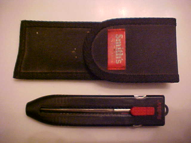

I've been using a Smith's diamond stone for about as long as they have been producing them.I normally use the fine grit but will occasionally use the coarse grit if the knife I am doing is really dull.I originally bought one to use on a custom knife I bought made of O1 that resisted virtually all attempts to re-sharpen with a normal stone.Found that it worked great on 440C as well.

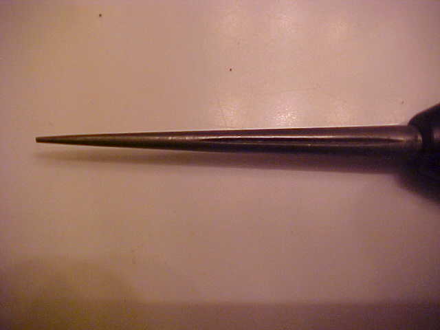

Bought a Smith's folding tapered diamond stick for doing serrated knives and it works great!

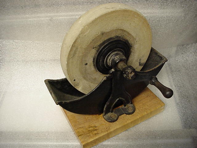

Here is a relic grandpa used to use.
Hand crank water stone!

Wow! That is a cool old water stone!

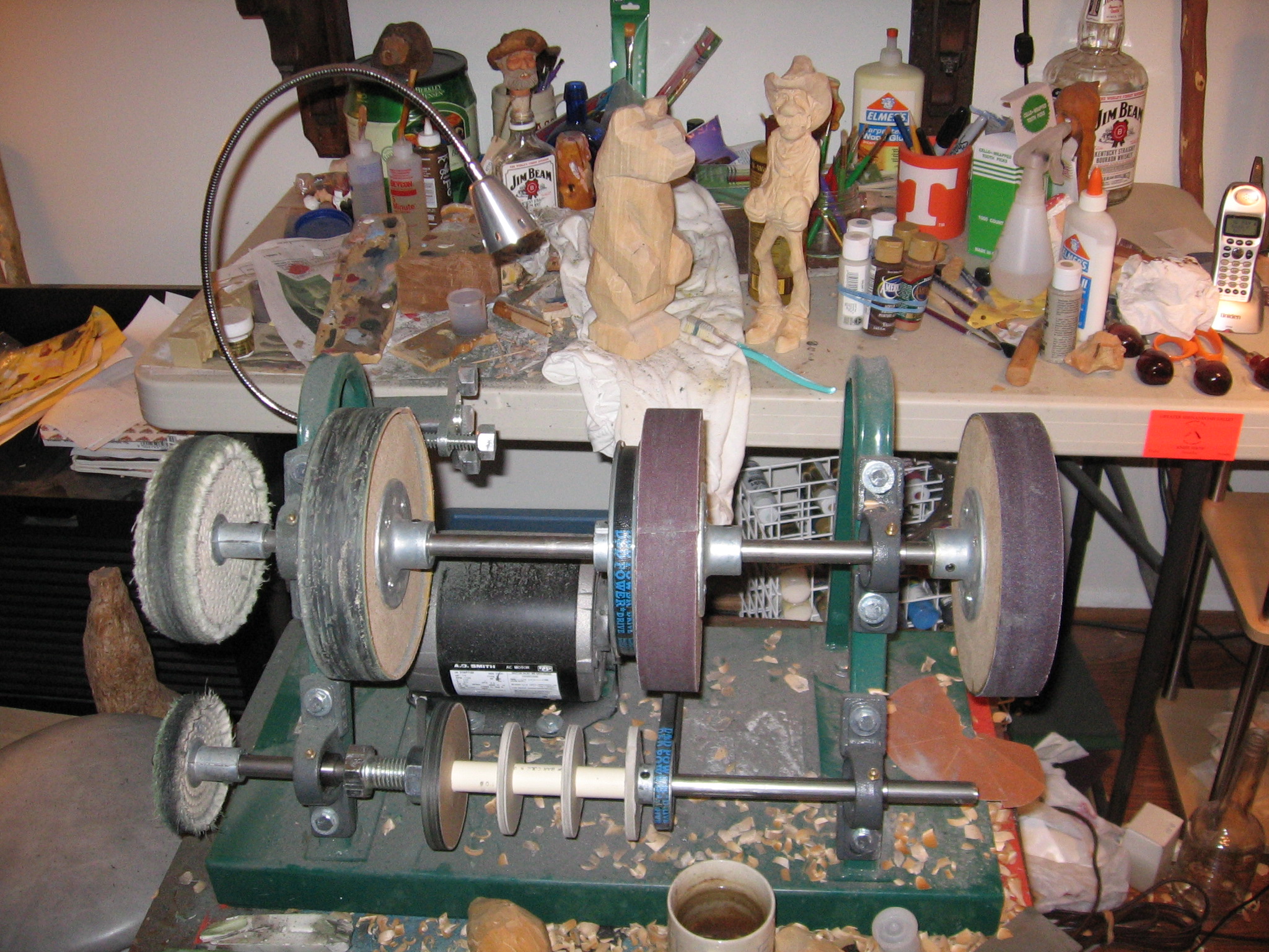

Like I told Philco awhile back, sharp tools are for sissies...push harder.
I usually just scrape my tools across the sidewalk or curb, good coarse grit for hogging off alot of steel.
After using stones for a long while, I decided I wanted to spend more time carving and less time sharpening, so I have used power for the past few years (really makes re-profiling a tool much faster)
I'll never throw away my diamond stones though

Don, we gots to get you some wheels!!
Do all those puppies turn at once??!!

rayban wrote:Don, we gots to get you some wheels!!

Miller Brothers,
I have those same Buck stones. The plastic cases are long gone. I'm pretty sure I have had them for at least 30 years. They don't see much use anymore.
