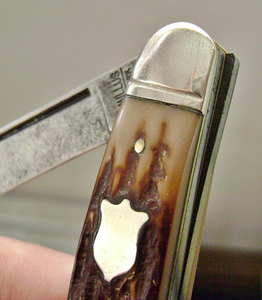

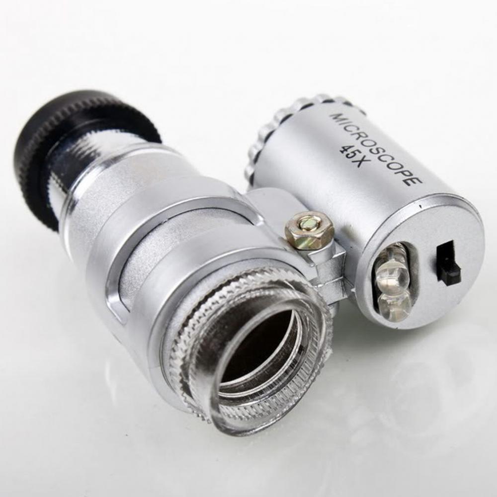

For a definitive answer to your "what material was used for this handle", get yourself one of these little lighted 45X microscopes. They can be carried in your pocket and are available on eBay for less than $2 shipped.
Here's what the difference in bone and Delrin looks like. The spots on the bone is the haversian canals that surround blood vessels and nerve cells throughout bones.

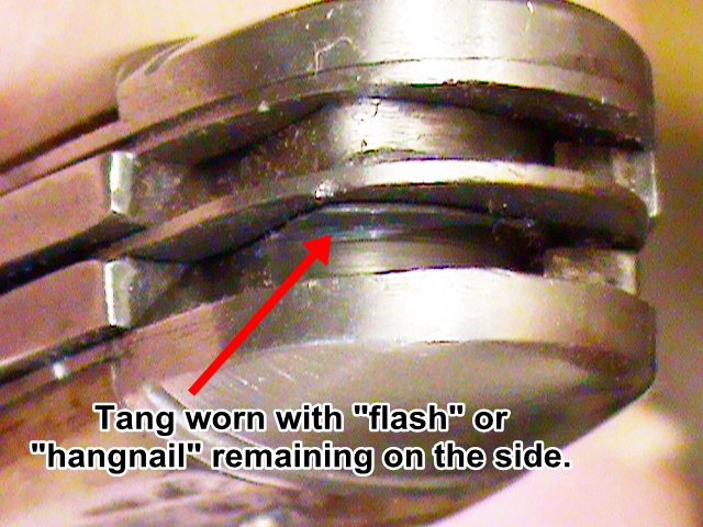

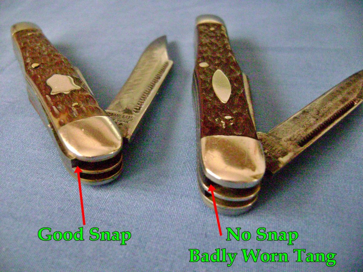

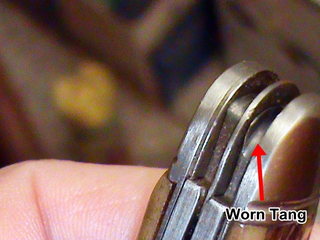

Ebay seller doesn't mention blade snap or has no clue what your talking about if you message him/her asking about it? Here are some work arounds.

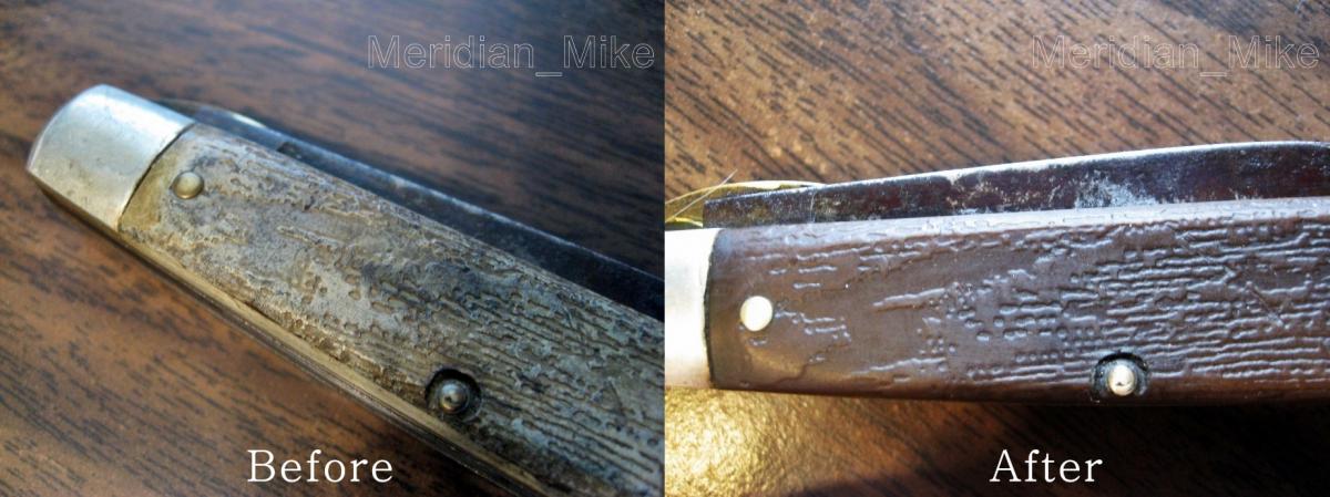

On a different subject, see a knife on eBay you would like to have but the Delrin handles are gray and look terrible. I call it "Delrin Haze" and it's an easy fix. Rub those Delrin handles down with machine oil (3-In-One, Mill-Rose, etc). I've scored a few bargains on eBay because the handles looked like crap.
Here's a before and after picture of Meridian Mike's Delrin handled electrician's knife.
- Recommend they search on YouTube for "blade snap Jerry" (you can't post a link in eBay's message system)
- If they have the blades open and you can see the back spring, check to see if it looks like this. If it does the blade will have good snap even though it may take a good oiling of the joint to bring it back.

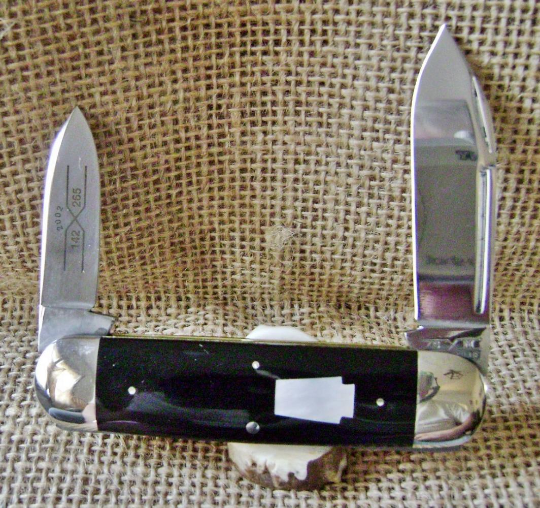

Gary, watch the video and you'll discover the difference is the profile of the frame (Shades of Wharncliffe).
melton714 -- I think I'd be safe in saying any preference of one over the other is simply personal. I know they can be expensive buggers.

From what I understand there is the traditional Toenail, a swell center Toenail and a Sunfish Toenail. Then again..........I have trouble understanding.
