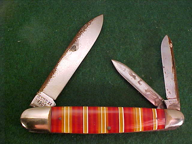

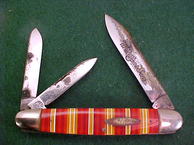

I bought an estate with about 10 candy stripe and gold stone case classics that had never been out of the boxes that have some surface rust. Anyone want to work on these?

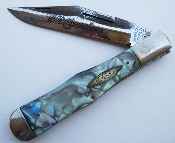

I can feel your pain... I had a bunch of Case Classics go bad on me.. all celluloid handles... And of course they were all low run knives... This little beauty right here is a one of a kind Classic and never produced... It has the long tail C proto mark on the front bolster and proto on the reverse side of the blade... As you can see it also has a slight rust problem... :roll:
I used to have about 50 Classics but sold them quick and rehandled others to natural material... I havnt owned a celluloid handled knive since and won't buy another... I do wish I could figure out something to do with this knife... Besides put it in my fishing tackle box....
