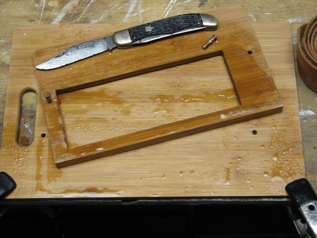

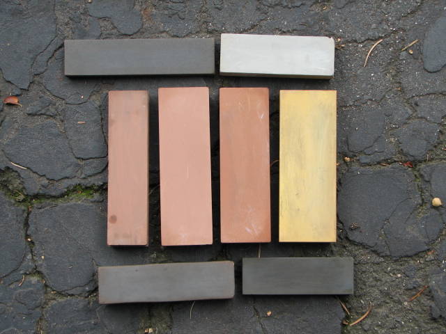

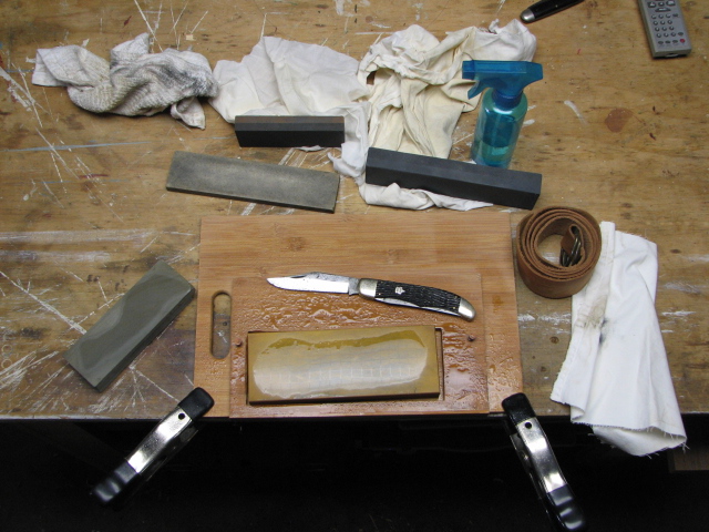

As you may be aware of from former posts, I use stones exclusively. This preference means that I have limited experience in the field of knife sharpening accessories, but I find most of the accessories available and the systems that can be had are easily dismissed when one has experience with stones; many stones. Please, I don’t regard other ways of sharpening knives as inappropriate or less than valid. They certainly will work and some folks will find it difficult to consider any other way of putting an edge on a knife. But I do urge you to consider stones. Looking back at another thread, PigSticker allowed that he would spit on a sidewalk and liven up an edge in desperate times.
A stone of sorts, no?
So, it’s stones for me. The more stones you have to choose from the more refined your sharpening can be. All stones aren’t the same. Man made carborundum, and India stones can very different in structure. Certainly earth stones can vary widely. There is also much to be learned about early naturally occurring stones in Japan, and Belgium, and probably many other places.
Man made waterstones made in Japan, and those made by Norton and others are probably closer in structure than any stones according to grade. This is an assumption, and all of what I’m offering here is just from my own experience and observations. I am not an expert on stones, or sharpening, or anything else for that matter. The point is, having lots of stones gives you lots of choices. Choices for the many different types, and lengths of blades you have. Also, different hardness of blades. And how about those blades that are so dull you soon realize you have a good deal of time facing you in making it right. So, choices. I’ll use this stone for this blade, and I’ll use this stone for that blade. Really, the idea is refinement. Knowing your stones, and getting introduced to and knowing your blades. You don’t just have knives, you’ve got blades, and lots of them, hopefully.
Frankly, I’ve never heard of the push/pull method described earlier.
For me, I hold the blade as though I were slicing off the top of the stone. If I’m using a coarse stone I may stay on one side of the blade a little longer to establish an edge before going to the other side to do the same .And I press very hard on the stone. I make that stone work for me. And I do move my blade in circular motion as well. Pressing hard and working the edge on to my finer stones. Most of my knives don’t require a coarse stone, but sometimes a new blade/new to me, needs to be shaped. Buy the largest stones you can afford or get your hands on.
If you want to practice, flea markets are full of inexpensive knives to work on. I would recommend 4 to 7 inch kitchen knives. They are easy to sharpen and they don’t fold on you, and they can be cheap.
I use water on my stones with a very little bit of soap to break the surface tension of the water and allow it to saturate the stone more readily. I do this on all my stones from coarse carborundum on down to my finest Norton waterstone. I want the stone to abrade the steel as efficiently as possible. I don’t want the blade to slide over it as it would with a petroleum agent. This just makes sense to me, and I find it very favorable, and I’m more attuned to the blade and stone. Using water also allows me to remove sharpening debris from the surface of the stone very quickly to continue sharpening and cleaning the stone.

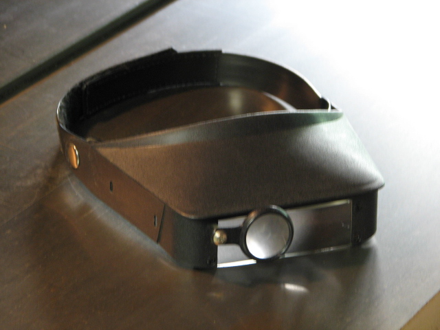

A word about visuals. I use a visor magnifier. It has two different strength lenses, plus a swing down loupe. I love it for sharpening, and many other things I’m curious about, and it leaves my hands free.
Also one of your best friends is light. Lots of it. So you can see that new virgin steel in a cutting edge that you designed that was waiting there for you to fashion any way you want.
Also, once you get the hang of this, it is fast, not slow. .........You want to strop? No leather? Use clean smooth card board...... Use clean smooth plywood. Like I told my kids... Never be afraid to break the rules!!!

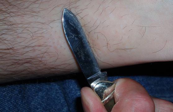

Shaving sharp is what I'm usually aiming for, but testing on my beard..? Not sure about that...
