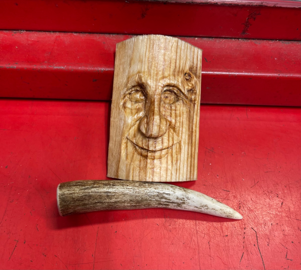

Best thing is bass wood. It’s available on line and at hobby lobby. Faces are easier to carve on the corner of square piece so you don’t have to remove as much for the nose. Watch Doug Linker on YouTube (search 5min wizard) and it will help you get started. Post your progress for us to see and have fun.
I carved this on the corner of a piece of pine

Cool Face, cool tip using the corner.

Good idea using the corner for the nose gives you a center line to keep things proportional. C-WADE7

eveled wrote: Thu Aug 31, 2023 11:28 am Good idea using the corner for the nose gives you a center line to keep things proportional. C-WADE7
I was never good at faces.
I helps a lot both as a center and that the nose protrudes more than anything else on your face, so it saves time too.
