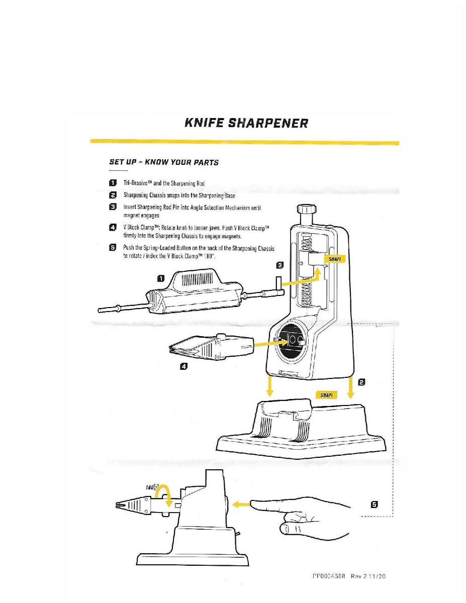

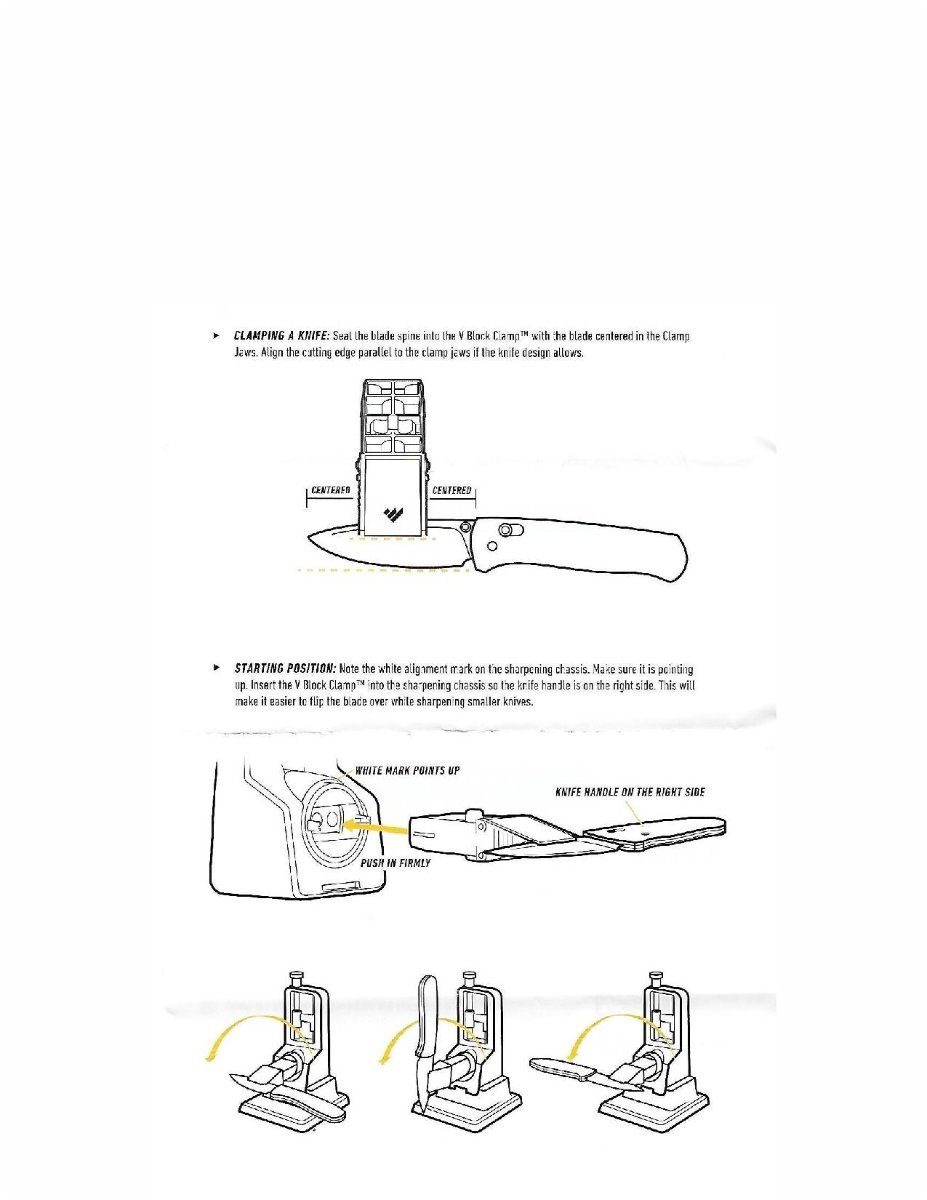

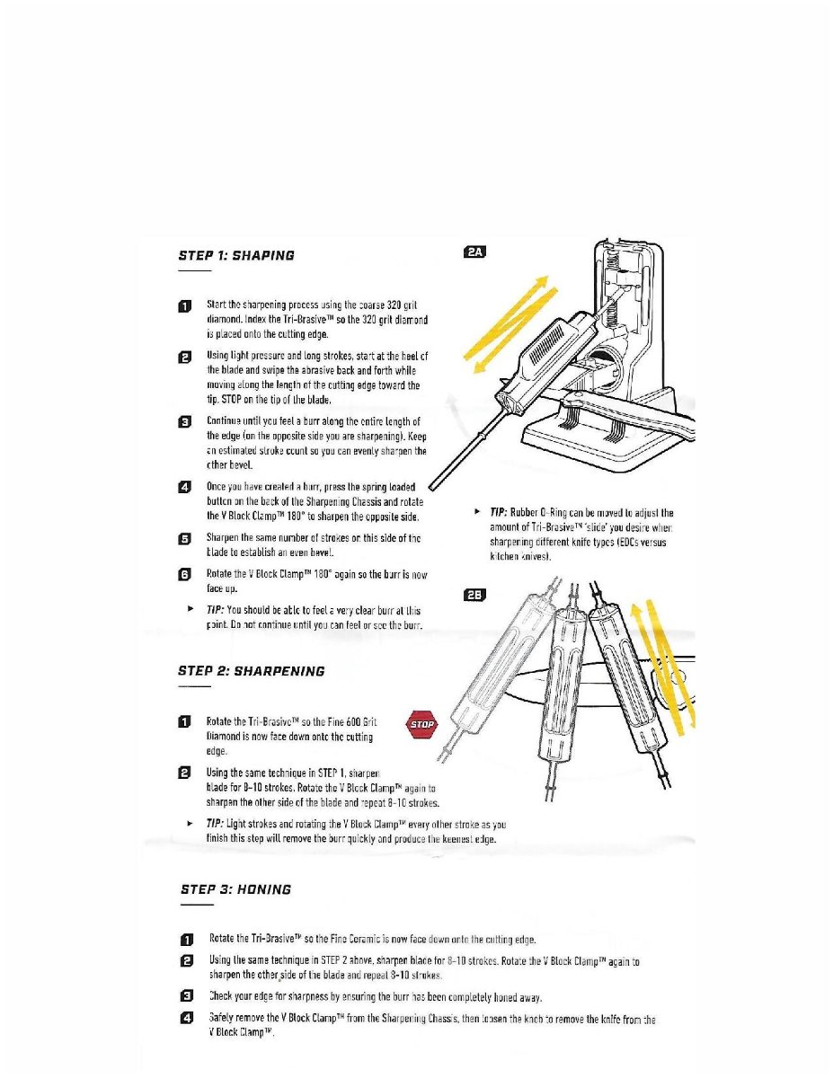

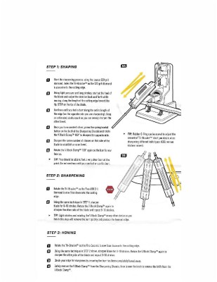

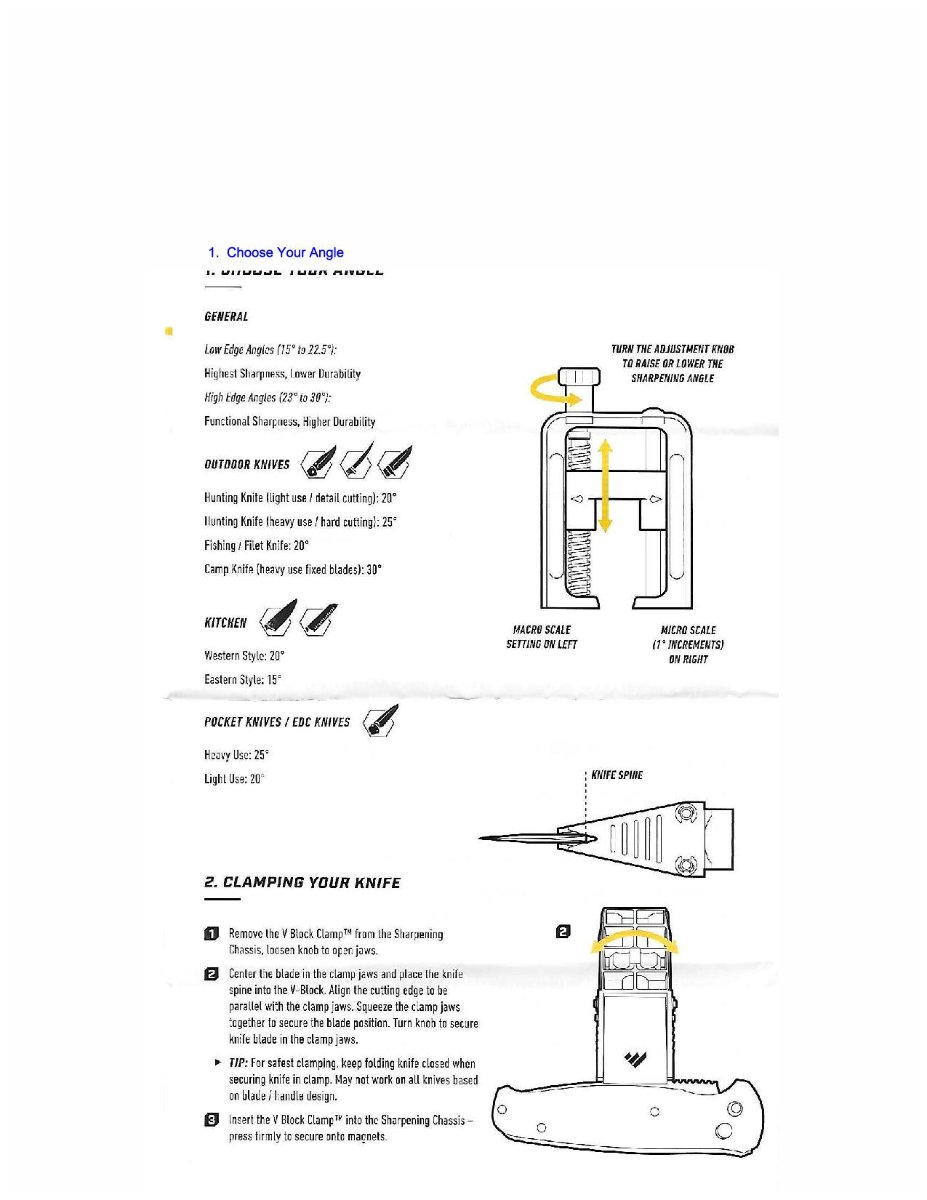

Before I go much further I thought it would be a good idea to post the supplied instructions below. I hope that they are legible.

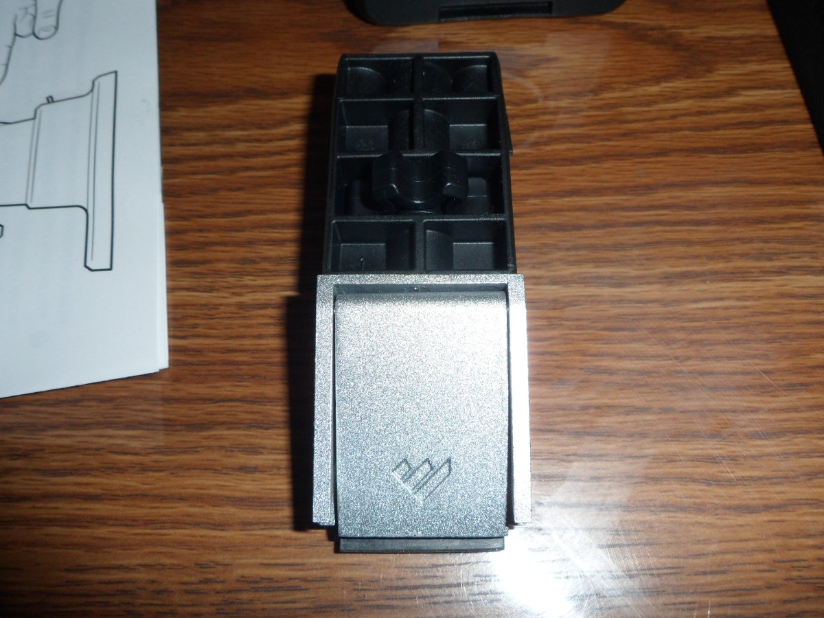

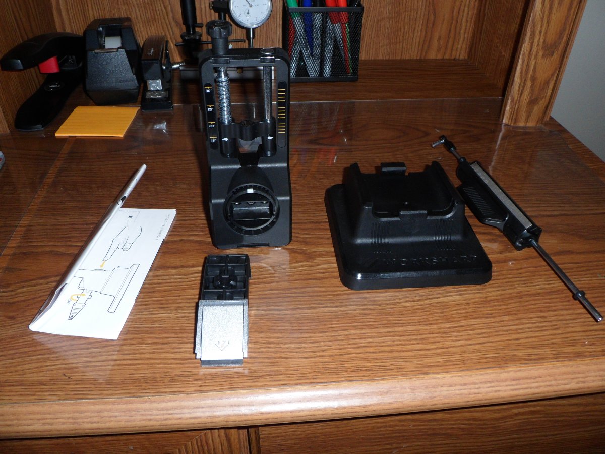

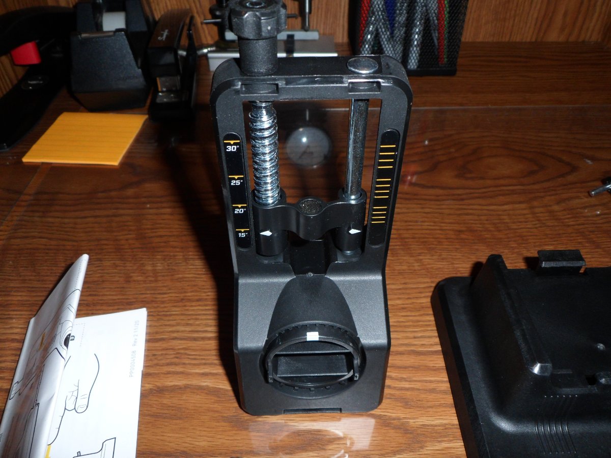

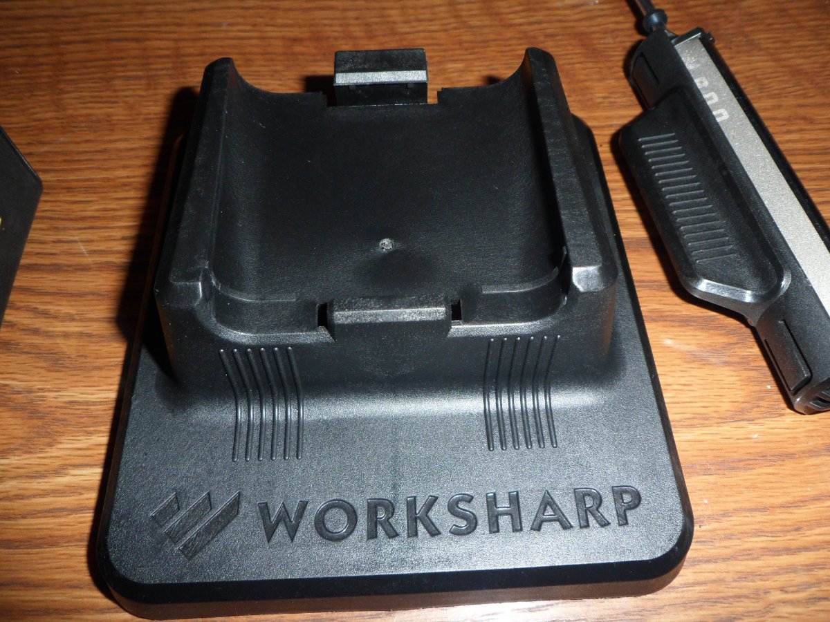

Next, I thought it would be good to post some of my own personal photographs. The below image shows all of the individual components together. The below image is the v-clamp. The below image is the chassis. The below image is the base. I don't seem to be able to attach anymore photos. Not sure if there is a size limitation. I will post a reply to this message and see if I can continue.

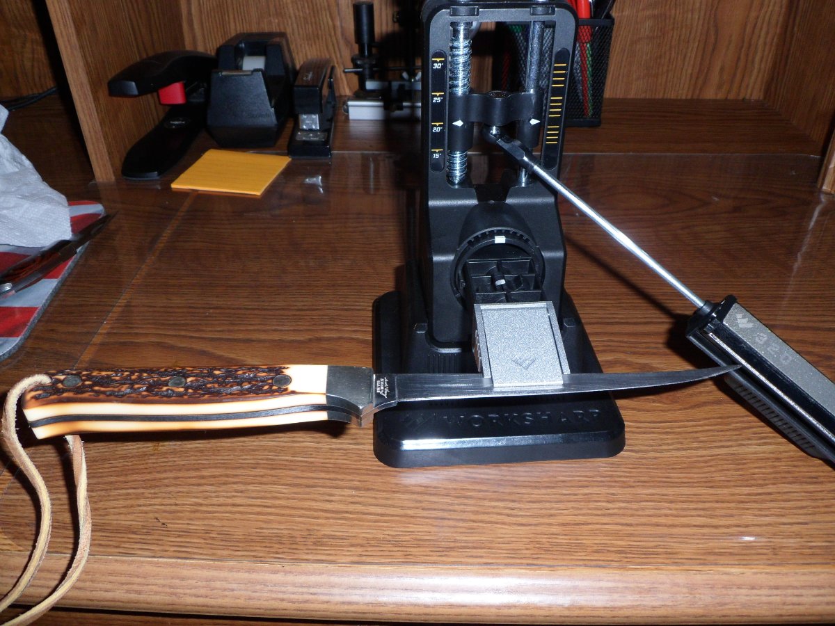

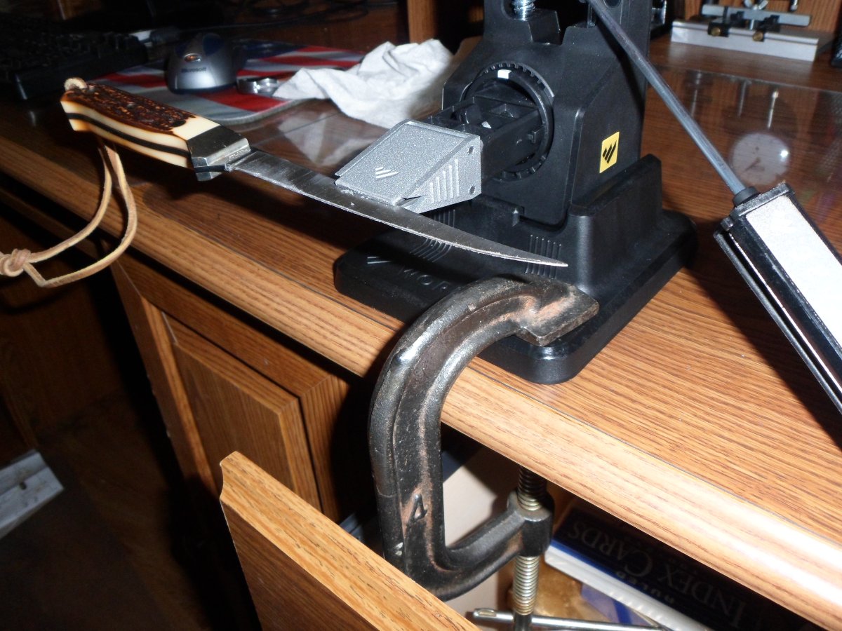

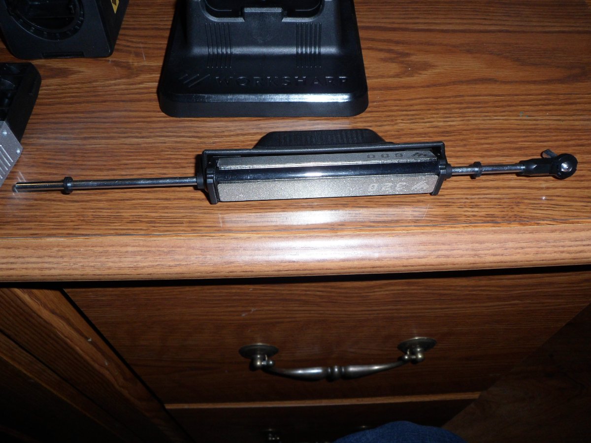

The below image is the sharpening rod. The below images are of knives attached.

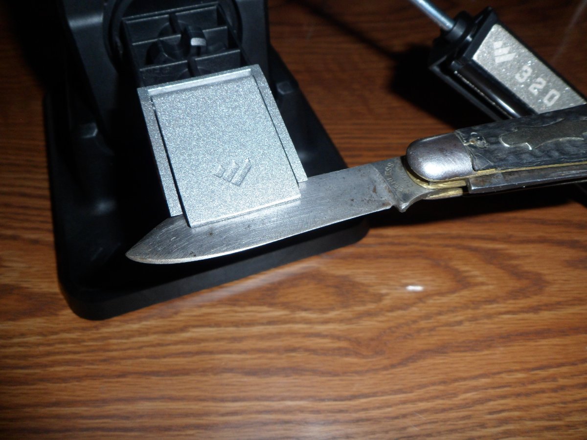

The first knife I tried to sharpen was an old pocket knife of unknown origin with carbon steel blades. It was dull as could be before I started and I decided to adjust the chassis to put a 25 degree angle on it. I followed the instructions working my way through the grits from coarse to fine and in no time I was able to put a sharp edge on the blade. I did not time myself but it may have taken 15 minutes.
The next knife I tried was a Uncle Henry 168 Walleye fillet knife. This knife proved to be more challenging but I was still able to put a fine edge on it. I decided to put a 20 degree bevel on it and proceeded to start the process. As soon as I started because, of the shallow sharpening angle and the narrow blade, I found that the sharpening rod was hitting the clamp instead of the knife. I was able to readjust the clamp so that it closer to edge of the knife and move on. The next issue I ran into was because the blade was so thin, narrow, and not very rigid, the blade flexed considerably while trying to sharpen. I was able to solve this problem by clamping down the base allowing use of my other hand to hold onto the knife handle to give it stability. The length of the blade was no problem as the sharpening rod had ample length to reach the ends of the blade.

One of the problems with these type systems has always been the clamp getting in the way of the sharpening rod and I did run into this problem. Extremely small knives and shallow sharpening angles will persist to create issues.

It's hard to tell from the pics but it looks like the knives when clamped, are only a couple inches above the table. Does the unit need to sit close to the edge of the table to allow the stones and rod to clear the table?

The clamp is about 2 3/4" from the table top. I don't think you would want the front of the base anymore than 4" from the end of the table top.

Thanks for the heads up and I did check the other site. Question answered there and the WSPA is definitely not for me.cudgee wrote: ↑Thu Nov 25, 2021 6:13 pmTrace, Mark the original poster and reviewer is no longer posting, i PM'd him but got no answer, so i don't think you will hear from him. But they just released some new holders for this sharpener only last week, look it up or there are some on another forum that have a fair bit of knowledge about these and the new clamps. You know where i mean, have a good Thanksgiving day.Rotten wrote: ↑Thu Nov 25, 2021 2:46 pmThanks for the great review! I do have a question though. Does the blade holder allow for secure clamping of small blades such as the spey on a Case 6318 stockman, or even smaller blades? If it does is it possible to get to 15° without hitting the blade holder? 15° is by far my preferred angle and the Work Sharp PA is a very interesting system to me for portability but if it can't get to that angle I might have to take a pass.Working Edge wrote: ↑Sat Mar 20, 2021 4:01 pm I've really been wanting to get my hands on a copy of the Edge Pro; heard so many good things about it, and I love tinkering with good tools, but so far, just have not been able to justify the expense.
I do most of my sharpening freehand on bench stones, but sometimes enjoy using the Precision Adjust unit indoors at the kitchen table, instead of standing at my workbench in my unheated worshop...!!
I also use the Precision Adjust those times when I or my customers want that picture-perfect, dead-uniform, mirror-polished bevel which exceeds what I can accomplish freehand.
Mark
Also there is a maker who has developed a scissor attachment and other stone holders for the WSPA which are 3d printed and priced to where they would be useful accessories possibly.
I am an Edge Pro user with a lot invested in extra stones and have made successful simple modifications to their small blade holder to allow for sharpening even Case's tiny trappers and stockmen and some even smaller. I love the consistent edge that I am able to achieve with the EP.

Glad i could help.Rotten wrote: ↑Thu Nov 25, 2021 6:26 pmThanks for the heads up and I did check the other site. Question answered there and the WSPA is definitely not for me.cudgee wrote: ↑Thu Nov 25, 2021 6:13 pmTrace, Mark the original poster and reviewer is no longer posting, i PM'd him but got no answer, so i don't think you will hear from him. But they just released some new holders for this sharpener only last week, look it up or there are some on another forum that have a fair bit of knowledge about these and the new clamps. You know where i mean, have a good Thanksgiving day.Rotten wrote: ↑Thu Nov 25, 2021 2:46 pm
