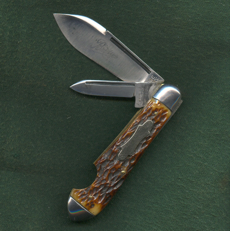

OK. So the seller is our old friend Brett1959. That alone should make one suspicious of the knife's bona fides.
Beautiful knife. Great blades with long pulls and a nice master blade etch.. Wonderful bone handles.
I suspect the blades did not leave any factory anywhere in this particular frame.
That bone is just screaming Robeson to me. I think it's a Robeson 027 EO jack from the 1920's or 30's.
Robeson used some long pulls early on, but nothing that ever looked like these blades. Robeson's long pulls were more narrow.

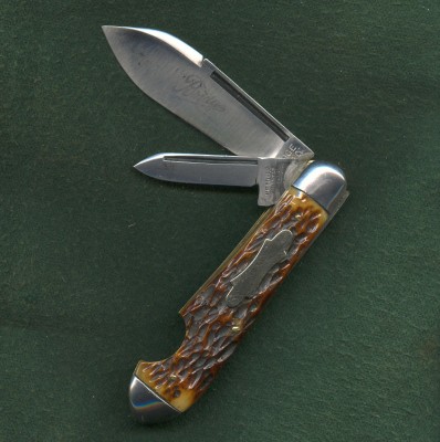

Re: Bridge To NoWhere
Charlie,
Take a good look at the pen blade. Then look at this one he bought for parts.
By his own admission he states the pen blade was replaced
http://cgi.ebay.com/ws/eBayISAPI.dll?Vi ... 0609069963

I agree, MB.
I looked at completed auctions for "Robeson", but it didn't go back but a couple of weeks and I neither saw, nor do I remember a Robeson 027.
Do you agree with me on the bone?
Charlie Noyes
Charlie Noyes
DE OPPRESSO LIBER
Sidlow Baxter
Sidlow Baxter
- Miller Bro's
- Posts: 13631
- Location: Earth
Look at the parts knife he bought, he actually reground the master blade into a pen blade, notice how far the long nail pull goes toward the tip?
Notice the jigged bone pattern on the original Bridge parts knife.
My question is, did Robeson use that exact same shield on that frame?
Yes I doRobesonsRme.com wrote:Do you agree with me on the bone?
That pen blade looks like a cut down master to me.

I agree on the bone - Robeson. And on the pen blade, how often do you ever see a long pull on a pen blade on an older American made knife? That plus the pic posted confirms where the pen blade came from.

the red flag is raised when you notice the large kick on the pen blade. too much of an out of balance for an original blade. btw, who is this guy? i guess he has done something like this before.. almost had me hooked with the easy open, but too high for me anyways.

Robeson used that escutcheon shield on virtually every 027 EO and 029 swell-end jacks they made, also on their 3 5/8" swell-end harness jacks.
I agree the pen blade was made from the master harvested from that old Bridge cattle pattern.
It's already a POS. And, him lying about the knife or omitting the complete truth about the knife makes it a fraudulent POS.
Problem is, somebody will pay him about two bills for this knife and then leave a glowing feedback and the jerk will continue to roll on, making fake knives and selling them to the unknowledgible collector.
If every knife he's sold on Ebay had been properly diagnosed by its buyer and appropriate feedback posted, his rating would be about 33%, not 100% and his Ebay business would have long since gone the way of the DoDo.
What a crook.
Charlie Noyes
What a crook.

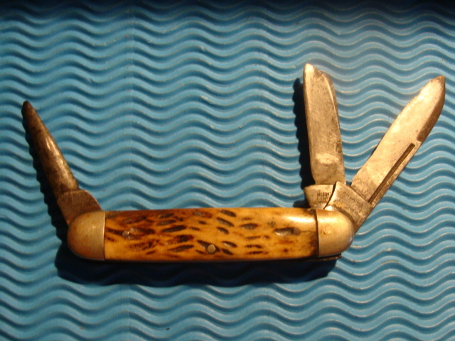

The comments on long pulls on pen blades got me looking through some of my Catt's. I found 2 out of my collection.
- Attachments
- MVC-022S.JPG (29.79 KiB) Viewed 549 times
- MVC-023S.JPG (31.24 KiB) Viewed 549 times
- MVC-020S.JPG (32 KiB) Viewed 549 times
- MVC-021S.JPG (29.84 KiB) Viewed 549 times

they are beauties jack
