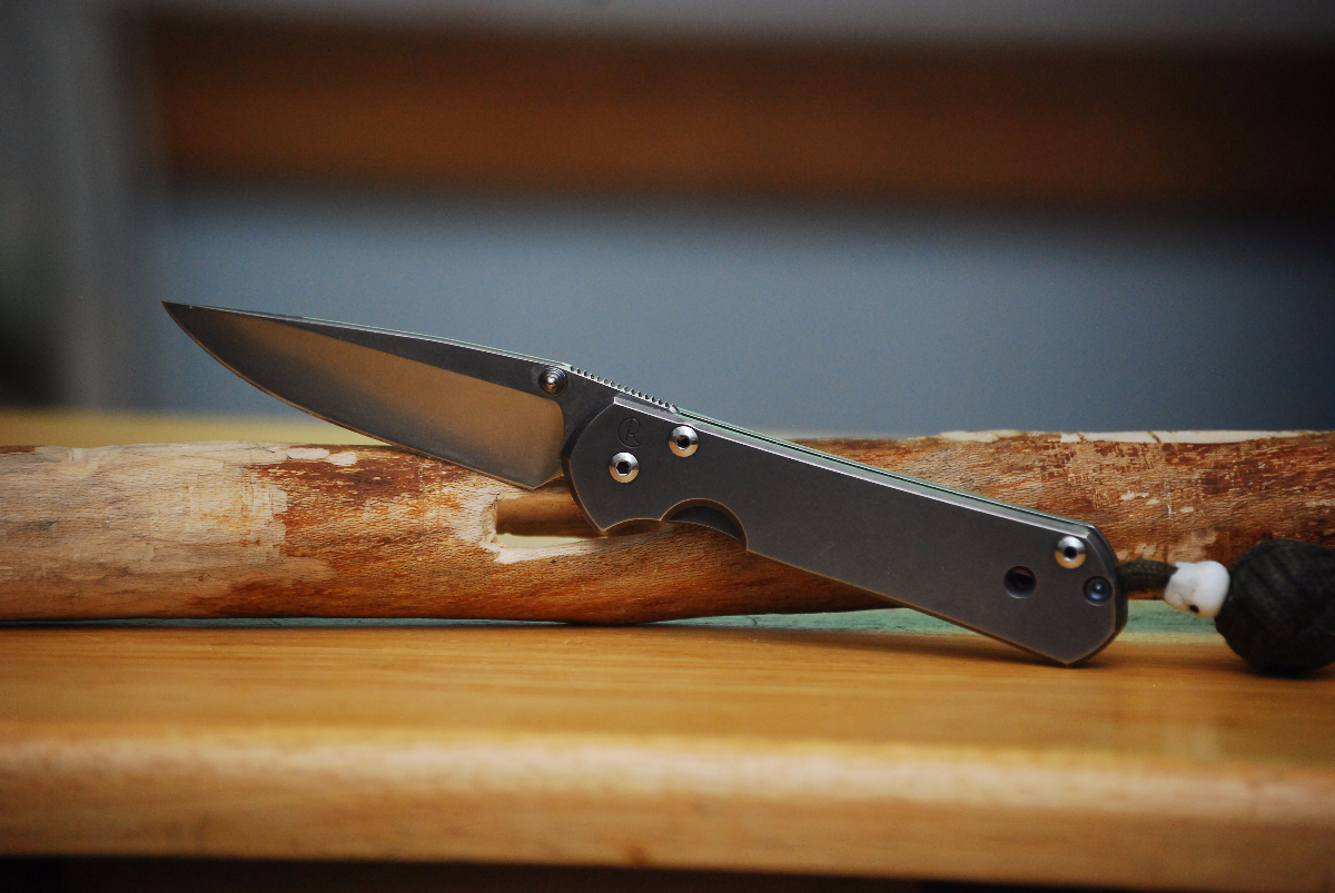

This today

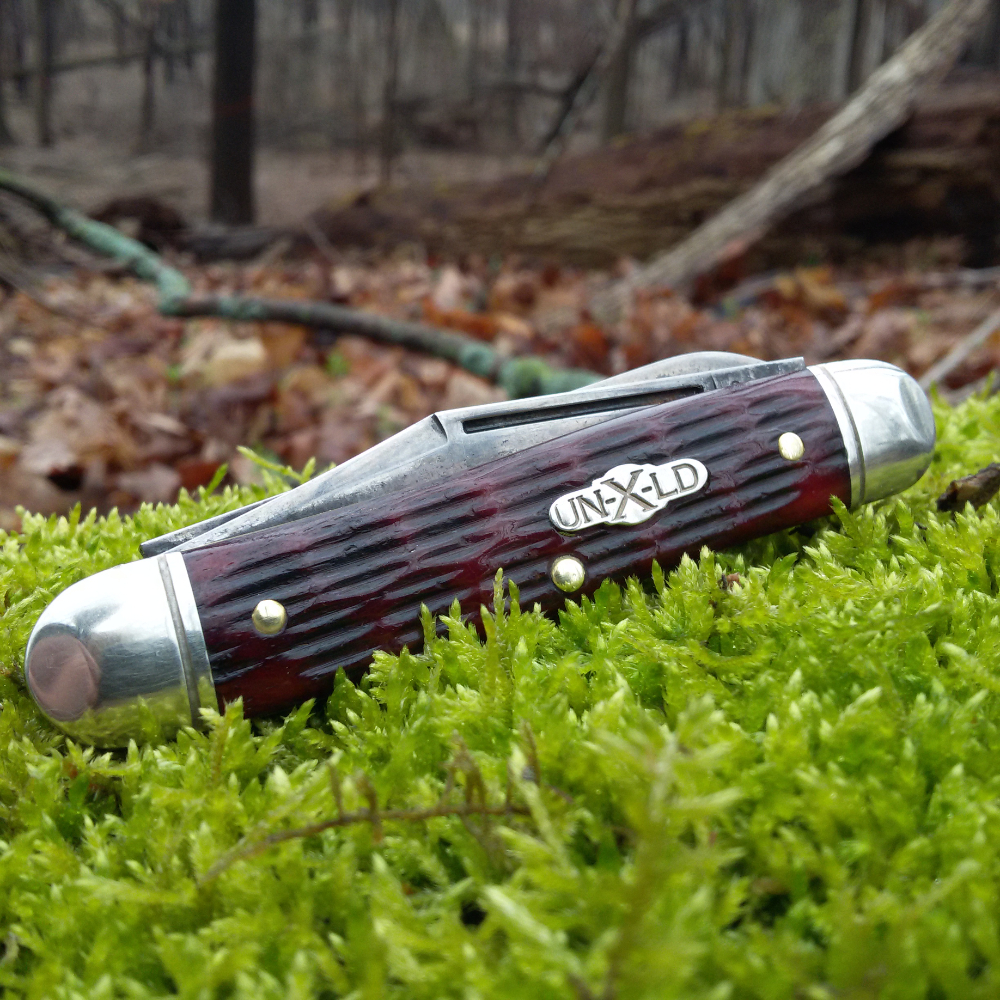

Cools photos, fellows! I took advantage of the slanting sun this afternoon to snap a couple of photos of this Schrade.
Schrade 804
Schrade 804

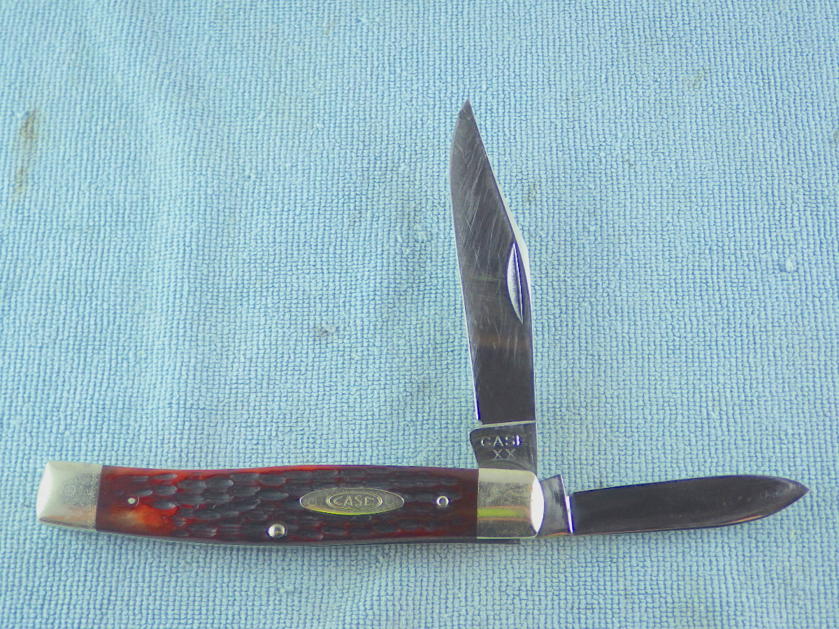

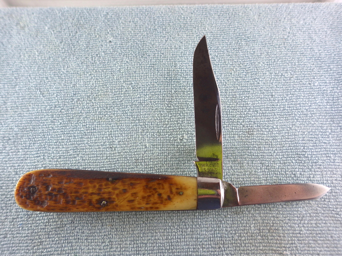

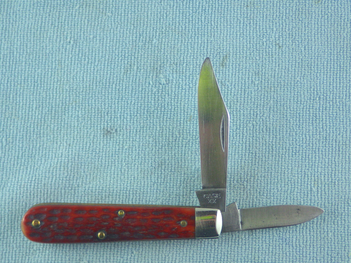

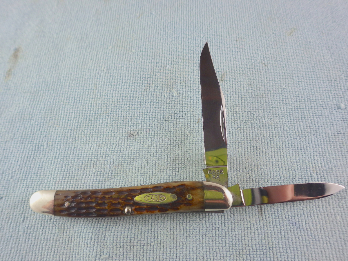

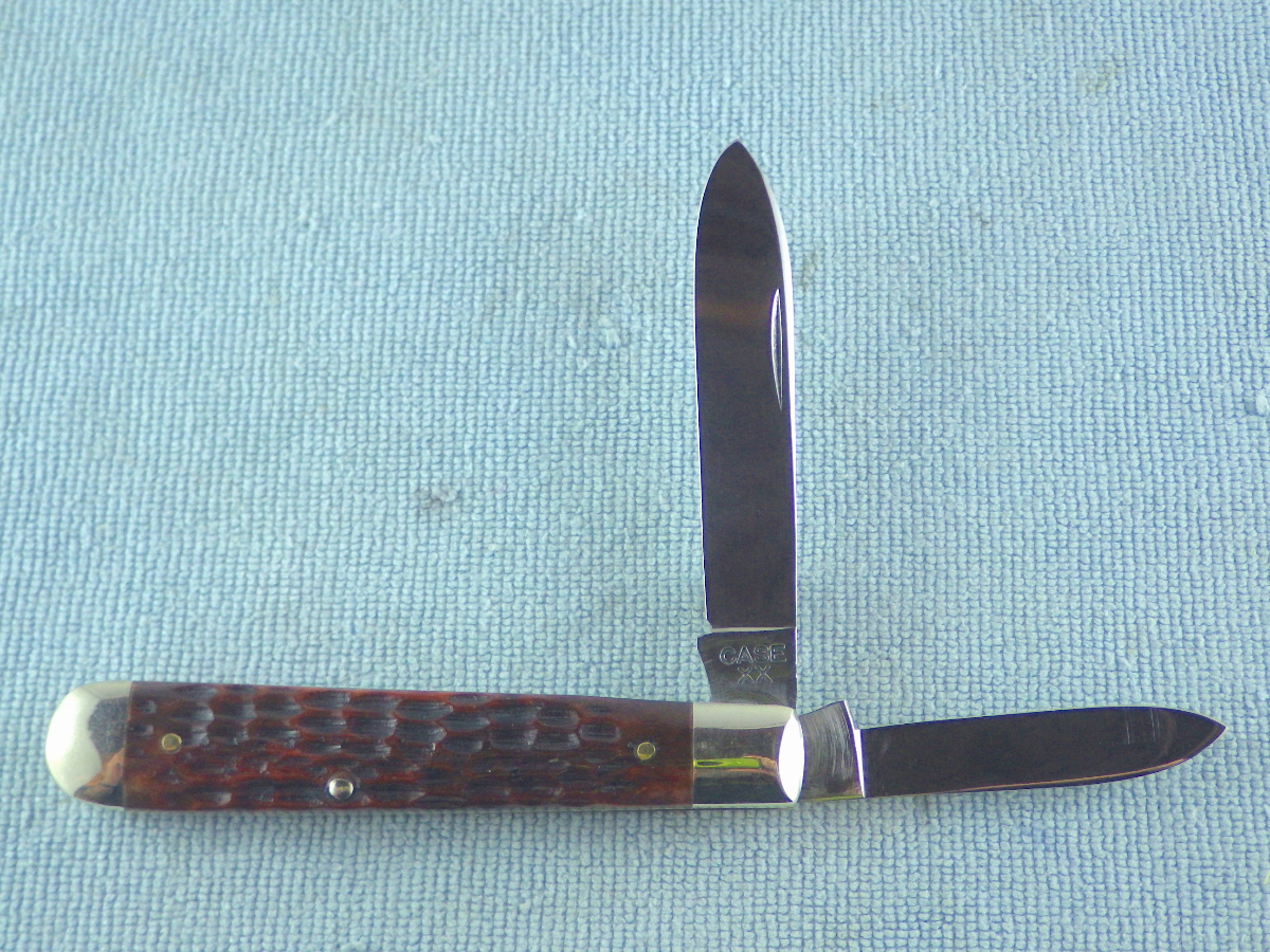

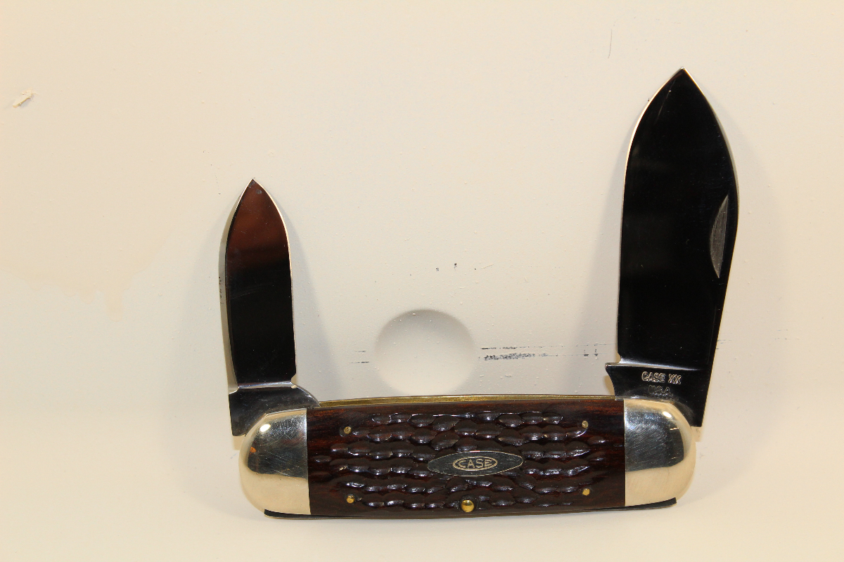

Here are some shots from my simply made light box. Still got a couple of problems to work out , but if it works I will document it here.
Greg
PROUD MEMBER AAPK, NRA.

The first 2 photos are not bad Greg... maybe the second abit out of focus... but the 3rd and 4th photos show the blades as "black" - I now understand that this indicates you are shooting perpendicular to the knife - you need to get some angle off the knife or it will show too dark... in the light box the knives need to be laying at a small angle... keep it at my friend as it only takes some playing around to get it right ::nod:: ... (PS - I may have some photos if I can find them that show the huge difference between shooting perpendicular in contrast to off on an angle)... I should add that a camera that has a macro setting where you can also adjust speed and f-stop helps a great deal - point and shoot cameras are tough...
Lee

LongBlade wrote:The first 2 photos are not bad Greg... maybe the second abit out of focus... but the 3rd and 4th photos show the blades as "black" - I now understand that this indicates you are shooting perpendicular to the knife - you need to get some angle off the knife or it will show too dark... in the light box the knives need to be laying at a small angle... keep it at my friend as it only takes some playing around to get it right ::nod:: ... (PS - I may have some photos if I can find them that show the huge difference between shooting perpendicular in contrast to off on an angle)... I should add that a camera that has a macro setting where you can also adjust speed and f-stop helps a great deal - point and shoot cameras are tough...
It is a work in progress Lee. I am using led light so I haven't quite got enough I don't think but you are right the angle makes all the difference in the world.
Greg

Greg - I think the photos of your favorite old Cases are better than the photos from your light box. I suggest a different background in the light box, something with some texture, like old leather or canvas or weathered wood. Just my thought, and I am no expert.
Mel

Dinadan wrote:Greg - I think the photos of your favorite old Cases are better than the photos from your light box. I suggest a different background in the light box, something with some texture, like old leather or canvas or weathered wood. Just my thought, and I am no expert.
Mel when I change the back ground it seems to throw the lighting off . Still got a lot to learn.

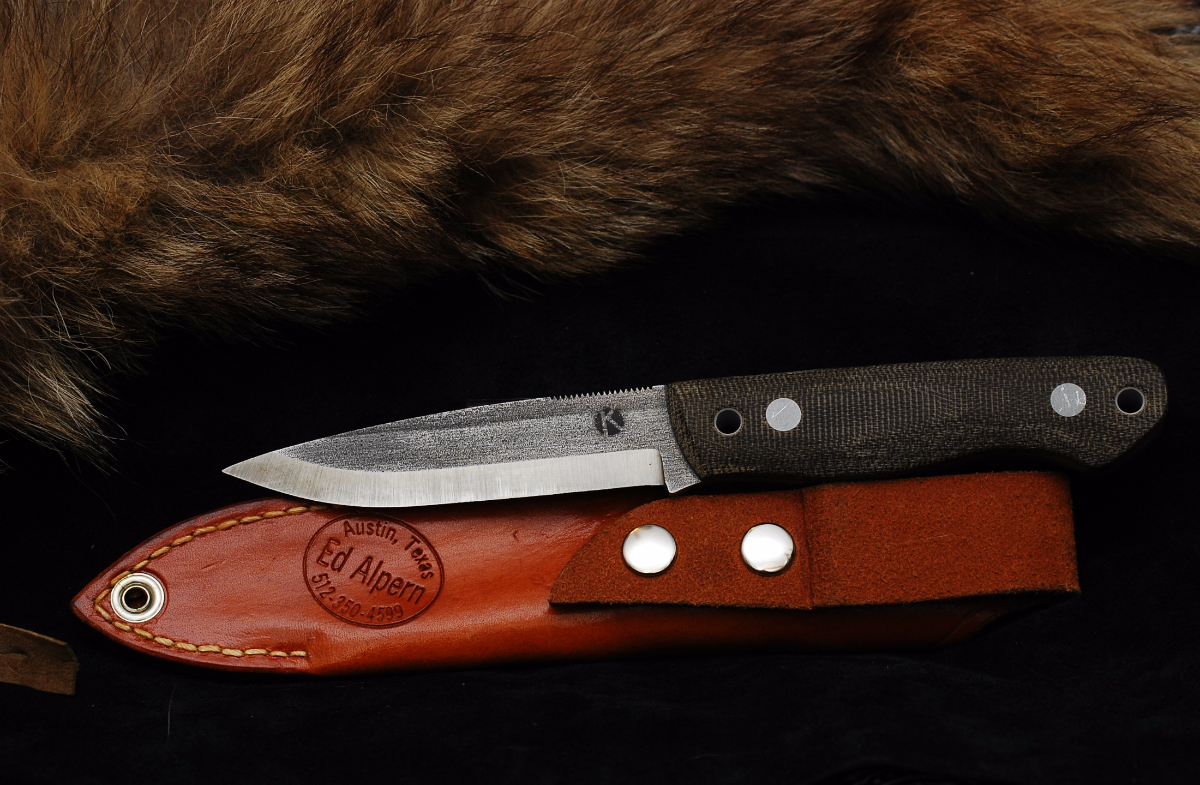

Forgot to post some knife pics.
Sharp by Coop, http://www.sharpbycoop.com/jalbum/index.html click on the link if you want to see some gorgeous knife photos of beautiful custom knives.

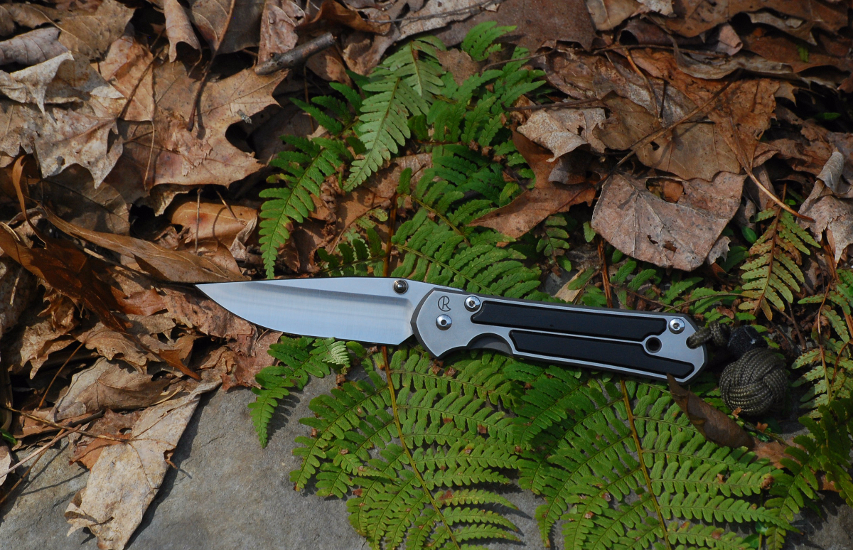

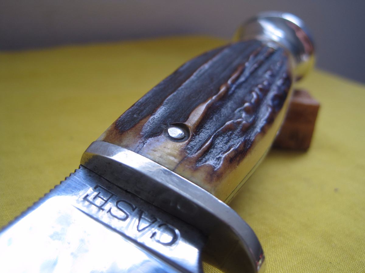

Trying to show the depth of the stag.....
dcgm4
Posts: 1962
Location: not there
Re: Knife Photography
Post by dcgm4 »
Nicely done, Scott. ::tu::
Dave

The last shot of the Chris Reeves in outstanding !!

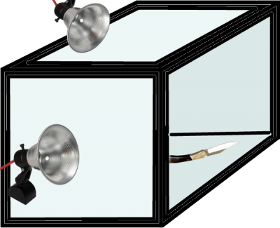

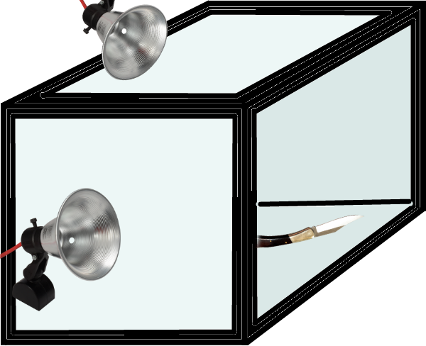

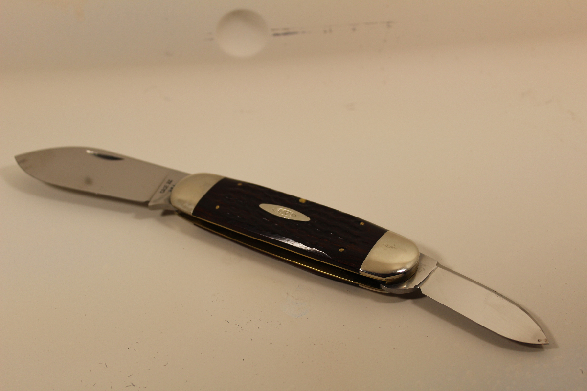

I need to make a new light box, I just wrote up a quick list of directions for a makeshift light boxes on the other site, here's how I made my last one.
Folks any amount of light control will improve your photos substantially, direct lighting especially by flash can be harsh and result in unwanted shadows, you can quickly build a small light box out of stuff everyone has around the house.
Items you'll need,
(1) sturdy cardboard box, approximately 30"X20"X20" microwave and computer monitor boxes work best for making cheap lightboxes. They're the perfect size and sturdy.
(1) roll of packing tape
(1) Sharpie/black marker
(?) sheets of packing tissue, the kind you put clothes in when you put them in a box for a gift, you need enough to cover 5 side of a box. An old white bed sheet works too.
(1-3) Work lights. I've used and moved table lamps, outdoor light and flash/LED lights around to get the right light.
(1-32) sharp knife/knives to cut the box and tissue paper or white bed sheet. I know, why so many knives? C'mone folks, it's a knife site. Do you really need a reason.
Backdrops and props help with the picture as you'll have to create a composed photo entirely in the box
Make sure your box is of sturdy consrtuction , empty it out removing any packing Styrofoam and cardboard inserts. Next use the tape to secure the flaps on the box so that when you're done you'll have a sturdy sealed box. If you have extra cardboard you can cut extra strips and tape them inside for increased stiffness.
Next take a Sharpie/marker and approximately 1"-2" from the edge draw a line around that side of the box marking the panel for removal, (this is where a sturdy box comes in handy, the better the box the thinner the frame and the more light and thinner the frame's shadows). After you're satisfied use one or all of your knives to remove the panels, at this point you can add pieces of cardboard to stiffen the frame if it feels flimsy and as you add the paper it'll stiffen up too.
When you're satisfied with the frame drape the tissue/bed sheet over the frame and again use 1 or all of your knives to cut the sheet/paper to size and secure it with the tape. The nice thing about this light boxes is you can easily repair, rebuild or modify (use different colored paper like a filter to change the color of light entering the box, you can add backdrops right to the rear of the box using everything from magazine pictures to album covers.
When you're done arrange your lighting till you're happy wit the results and snap away. Now this isn't nowhere as sturdy as Coop's light box and beverage was meant to be. It was meant to be a makeshift lightbox although I had one last me all year.
Here's a poor rendition of what I'm talkin' about. I hope it helps to illustrate what I'm describing. Hope this helps some of you amateur photographers, if you have any questions feel free to contact me by PM, Email or if Coop doesn't mind here on this thread. Hey if you build one please take a pic and post you're WIP and show the results your new homemade light boxes produce.
