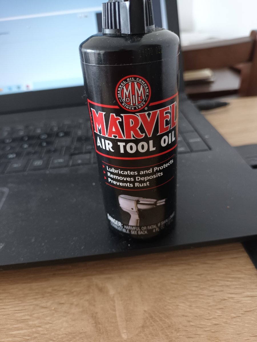

Good input. You say when you started collecting knives you used whatever oil was available. Now i know times have changed, but i am an old man now, and when i was a kid the old timers, including my Dad used whatever was available. They were thrifty and inventive, had been through 2 World Wars and the Great Depression. My Dad who always looked after his tools and instilled that in me would buy a pint of engine oil from the local garage, go home and fill his oil can with it. It was applied to every thing. We sometimes over think things especially for working knives and can go a bit over the top sometimes. Most EDC and hunting knives used frequently will cope with just about any oil/lubricant. Collectors and knives in storage not so, they require more attention, a bit like Cast Iron cookware, if you are going to store it, requires different methods than a regularly used pan. For what it is worth, a knife collector of many years put me onto this years ago and i have had great success with it, and made in the good old USA.orvet wrote: ↑Sun Mar 19, 2023 1:36 am When I began collecting knives, I used whatever oil was handy when I needed to lubricate a knife. Looking back, I think many of my knives were under lubricated.

Heh, I use that in my air nailers.

Marvel oil is a good product.
Back in the 60s it was used as an engine oil additive to reduce friction in car engines. It's also a good air tool additive. If I recall correctly, some air tools came with a sample of Marvel Mystery Oil.
Even a drop of engine oil from your dipstick will help lubricate a knife joint, as long as your oil is not old and burnt or full of metal fragments.
All oils have lubricating properties, some more so than others. I have used all of the oils I listed in my post above. It has been my experience that some of them work better for knives than others and for me Quick Release Oil works the best of any I have found to date.
I have used QR on squeaky door hinges, but I found it does not last very long, the hinge will start squeaking again within a few weeks. It seems to me that viscosity of QR is a little light for a door hinge. My preferred oil for squeaky hinges is 1 Lube or Justice Brothers 80. I believe both of those have Teflon in them which can become a little gummy and collect dust when used on knife pivots. That's not a problem on a door hinge.
Whatever you use, take the advice George Wostenholm stamped on the tangs of his knives, "OIL THE JOINTS."
