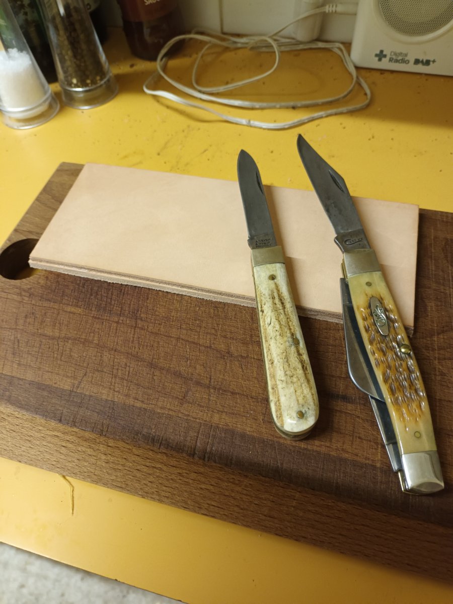

Mumbleypeg wrote: Tue May 24, 2022 3:25 pm Okay folks, since you asked here are some pictures of the leather “strop” piece made from an old conveyor belt. I took a picture of the edge also, hope you can see how it is laminated from multiple thin pieces of leather. It’s about 3/8ths of an inch thick total. I don’t use any compound with it, but it does have some kind of natural “oil” that comes to the surface with use. It doesn’t puddle there but you can see moisture on the surface as you’re stropping. Maybe from years of use either in the mine (I suspect they used some kind of treatment to keep it limber) or from sharpening. ::shrug:: I’ve had it since my grandfather’s passing, in 1968. The Case 6318 is for size perspective.
Also included a picture of some other miscellaneous sharpening pieces that live in the same bag with the leather piece. The black one is stamped “Buck” on the chromed metal pocket clip, the knurled piece can be turned/loosened to allow the rod to be extended or retracted into the handle. The other smaller one is some kind of hardened steel with a striated surface. Sort of a small version of a chef’s steel.

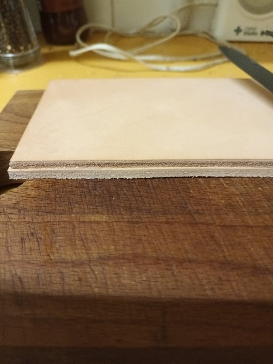

Thought you may be interested in this. Finished it last night and have had it clamped between wood to make sure it is completely flat. Have a large Case stockman and a 31/2 inch boys knife to give some size perspective, a bit longer than your grandfathers, but about the same width, and is 3/8 of an inch thick, but only 2 pieces glued together. Just working out what leather treatment apply before i start using it. Have a good Independence Day whatever you have planned. ::handshake::

Looks like a good job cudgee, hope it works well for you. ::tu::

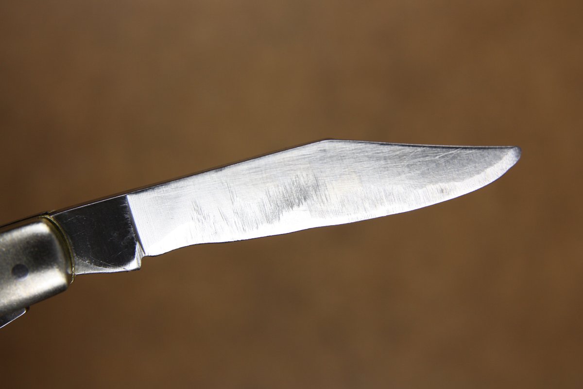

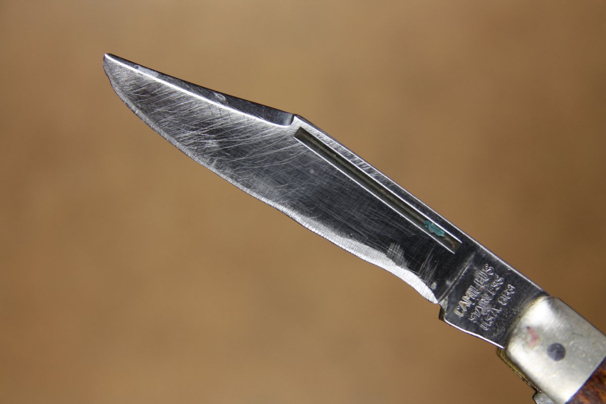

My nominee for the "Worst Sharpening Job Ever" is on this Camillus 883 that I recently picked up for $3. 60 grit bench grinder job?

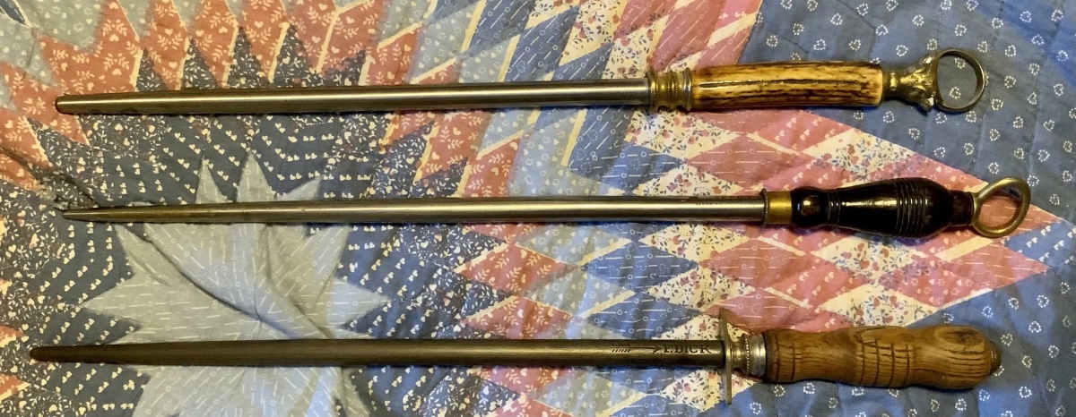

Here are my three old F. Dick sharpening steels. Two are completely slick, and the one I use barely, and I mean barely has some texture to it. As long as my edge is good, this keeps everything SHARP, and is great for removing burrs after sharpening.

Colonel26 wrote: Sat Jan 14, 2023 5:58 am Here are my three old F. Dick sharpening steels. Two are completely slick, and the one I use barely, and I mean barely has some texture to it. As long as my edge is good, this keeps everything SHARP, and is great for removing burrs after sharpening.
You bet Colonel, aren’t those between-the-wars smooth Dicks something else? I love mine. Some of them have slight pitting and flaws, so I use them with a trailing stroke.
I read somewhere that F. Dick made burnishing steels on contract for Henckels in some timeframes. I don’t have any Henckels steels to compare though.

catspa wrote: Wed Jan 18, 2023 6:34 am
Parker
They're most awesome in my opinion. I had no idea they were that old, I know nothing about dating them. I bought the one that's just barely got any texture at a junk type auction several years ago for a whole $11 I think. I fell in love with it right then.
The slicks I got from right here on aapk. Muskrat man had refurbished them and had them for sale. I though the price was good enough I bought them both.
It wouldn't surprise me if F. Dick made the steels and slicks for Henckles.

OLDE CUTLER wrote: Sun Aug 28, 2022 5:34 pm My nominee for the "Worst Sharpening Job Ever" is on this Camillus 883 that I recently picked up for $3. 60 grit bench grinder job?
🤦‍♂️ Looks like something my daddy would do.
