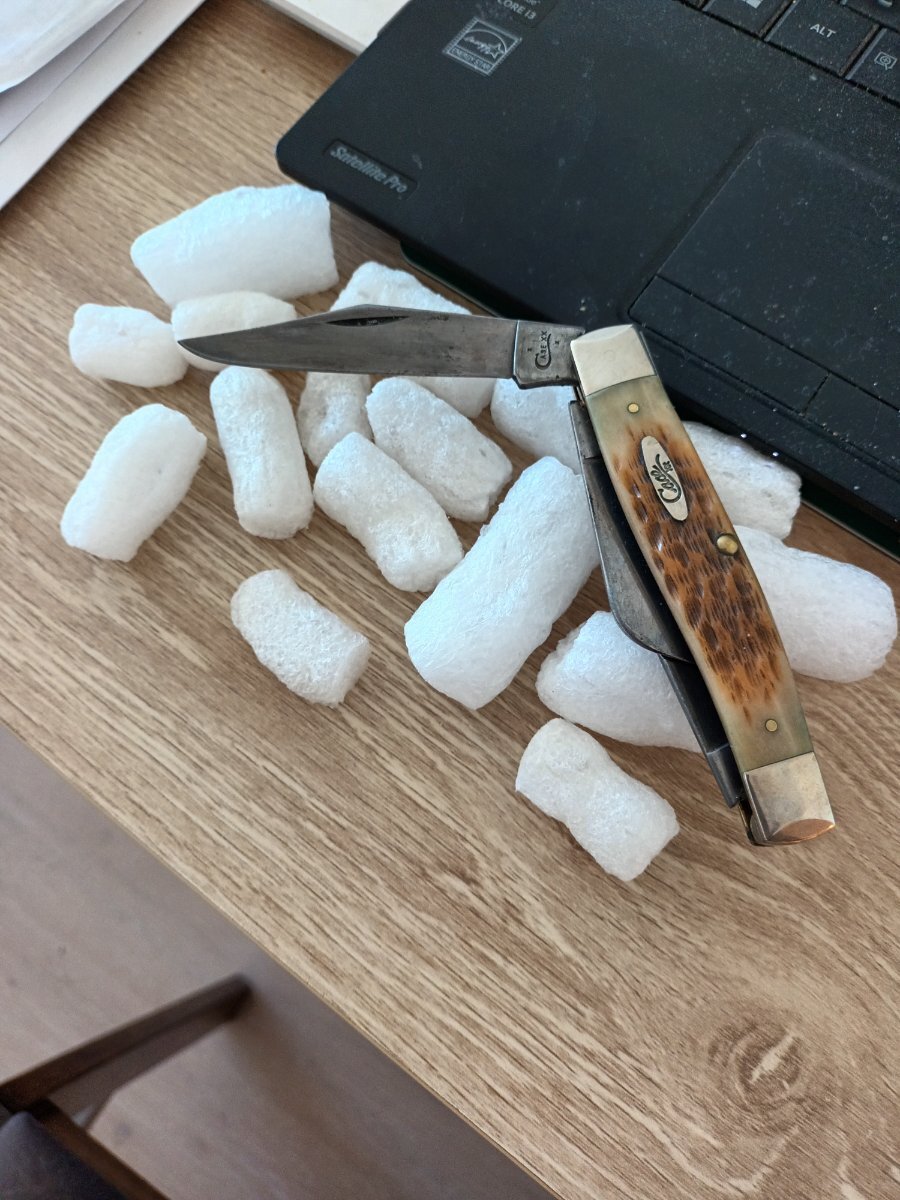

I hate wastage and stuffing up the planet. And as Dale said in the previous post, the amount of advertising material wasted is mind blowing, as is useless packaging. I use this as testers for edges rather than just put it into landfill. I understand it will eventually end up in landfill, but at least it serving some purpose before it does.
