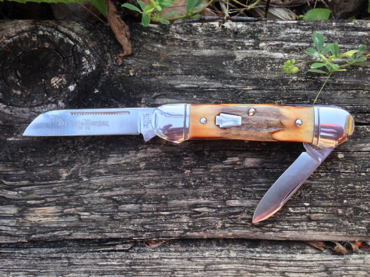

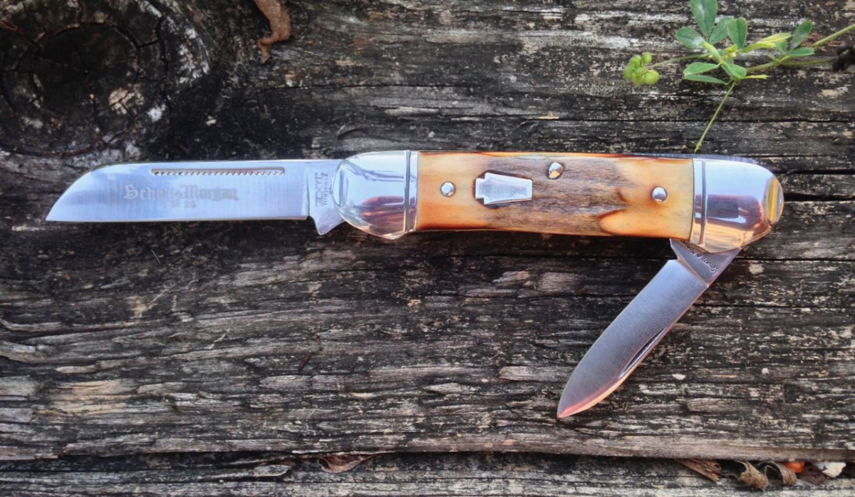

Thank ya Big H, it is an attractive knife for sure and when I saw it listed with that sf blade I knew I had to have it. I think I'm gonna like having it but I'm not pleased with the action on the blades. It has that gritty opening and closing thing that I've found on a few other S&M knives I've ordered.
A little oil helped somewhat but not much. Anyone know of a way to correct this short of sending it back to the maker? It's not a deal killer to me but
is a bit annoying and had I been able to handle the knife instead of mail ordering it I might have spent my money on something else.
Sunknife,
You can root through some of these threads and find that sometimes folks are successful getting the grittiness out of knives with a short soak in some water and dish soap, Dawn I think is most often recommended. This has worked for me several times. After soaking and working the blade, rinse with very hot water, blow it dry with compressed air and lube with your favorite knife oil. My daughter and her boys gave me a new Case Canoe a couple of years ago and it was awful but then when I washed it out every thing was great. Maybe it'll work for you and maybe some one else will have a better way to get the grit out and share it with us.
Treefarmer
Sunknife if you don't have any Quick Release oil, get some. It's the best stuff I've ever found for lubricating blades and it's amazing what a difference it makes in knives with "issues". Treefarmer gave you excellent advice on the cleansing and BLOW drying of your knife. Sometimes it's almost unbelievable how much crud you can blow out of a new knife with compressed air. Good luck!
Thanks Phil. I put in an order on the quick release oil, have a few knives that could use some help so it will be put to good use. I let you guys know how it goes.
sunknife wrote:I'm not pleased with the action on the blades. It has that gritty opening and closing thing that I've found on a few other S&M knives I've ordered.
Schatt & Morgan knives are notorious for having a gritty walk. The strange thing is that not all S&M knives have it, but enough do that it has been mentioned frequently and commented on quite a bit on AAPK. I have pretty much come to expect it as a disappointing yet normal characteristic of S&M knives...which is why I have pretty much stopped buying them altogether. I'm actually finding Queen City knives to be much better quality. For example, this Queen City Stag Canoe has a perfectly smooth open/close action, and I just ordered a Queen City EZO Stag Barlow that I'm anxious to get in hand to see if it's as nice as my canoe.

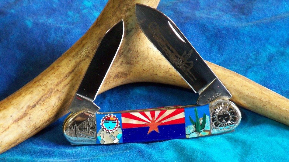

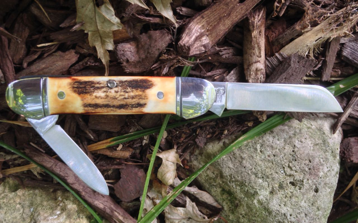

In the absence of any new acquisitions, here's a repost of my one and only custom canoe. I had this one made to my design and specifications to express my fondness for my home state.

I posted this S&M canoe knife here a few weeks ago and asked for some advice regarding the rough and gritty action on the blades and wanted to respond with a big thank you for your help Tree farmer and Philco, I somewhat new to this and appreciate the insight.
So I soaked it in dawn dishwashing liquid, dried it with compressed air and lubed it with the quick release oil. The results are that the pull on the main blade went from a 8 to a 4, easier to open but only slightly less gritty feeling. I suppose I should have contacted the dealer when I got it a month ago and asked for an exchange but I didn't and I'l just live with that decision. Also have to say that the main blade has a good deal of play in the closed position and needs to be pushed to the side before closing the secondary blade or it will get hung up on the tip of the main blade. This has happened to me 3 times now and put a small burr and slight bend on the very tip of the main blade that I've had to remove with a fine file.
I have one other S&M knife and one Queen knife that have the same gritty feel to the blade action but several others that are fine. May be awhile before I feel like buying another S&M knife even though the good ones are very good and among my favorites.
sunknife wrote:I posted this S&M canoe knife here a few weeks ago and asked for some advice regarding the rough and gritty action on the blades and wanted to respond with a big thank you for your help Tree farmer and Philco, I somewhat new to this and appreciate the insight.
Sorry to hear about the issues with your S&M. I have owned a pile of them over the years, and I own NONE now. Without exception, all of them had issues bad enough that wouldn't have been acceptable for a far lesser priced Case ... for what S&M's cost, the QC just isn't there - I'll never own another one.
I've gotten so many Queen made knives with gritty action that I now consider it a signature or trade mark of the Queen brand.
My experience is that the gritty action has more to do with poorly ground cam tangs than dirt or grime in the joints. I'm still a fan of Queen and embarrassed as I am to admit it, I've come to accept the gritty action on Queen knives that I really like otherwise.
Back to Canoes: I see that Queen has released a Schatt & Morgan Canoe with a single Sheepsfoot blade. It looks just different enough that I might have to pick one up.
