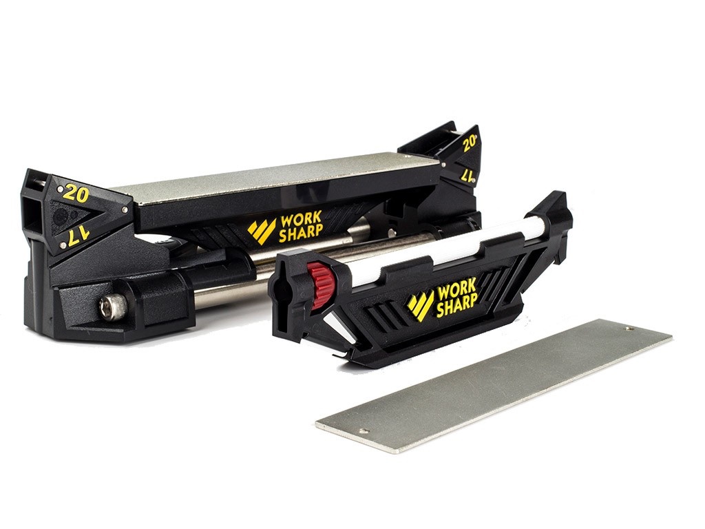

cody6268 wrote: Sun Aug 09, 2020 12:40 am What about something to sharpen recurves? I'm having a ton of trouble not only with hawkbills/pruning knives, but also some tactical designs with recurve blade profiles, like the Kershaw Chive for example. The round ceramic stone on the Worksharp Guided Field Sharpener will do great if the edge is in good shape, and not blunt, but if the edge is blunt, or in rough shape, it's not aggressive enough?

That Lansky’s rod appears to be a ceramic rod. If so it’s likely no different than the ceramic rod that comes as part of the Worksharp Guided Sharpening System. The handles are different of course but based on his comments I think the ceramic rod isn’t aggressive enough for his purposes - looking for something with courser grit. Wade’s recommendation (edge/corner of a stone) is a good solution. Haven’t tried it myself though. Can’t think of a single recurve blade in my pile. ::hmm::
