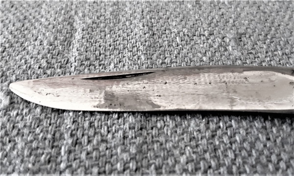

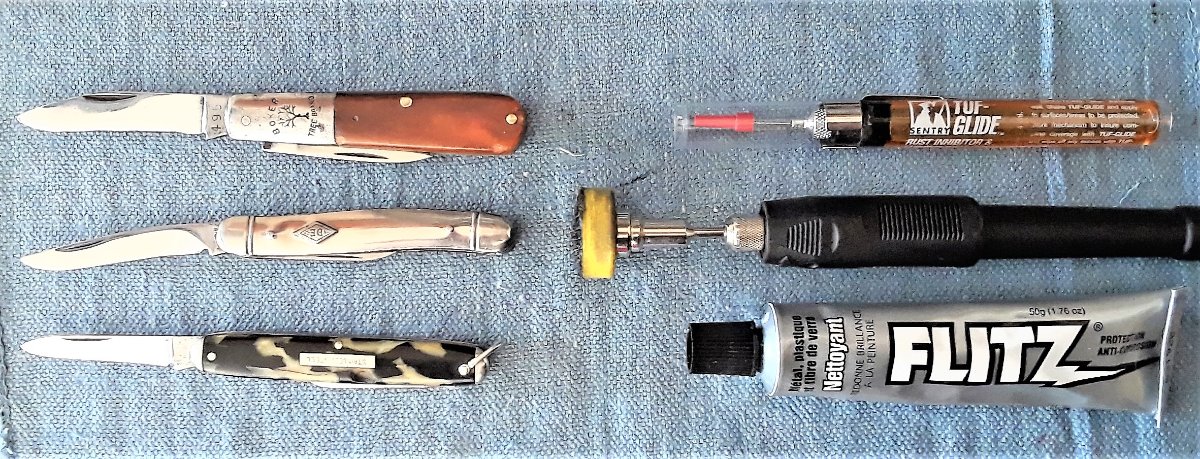

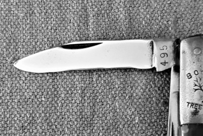

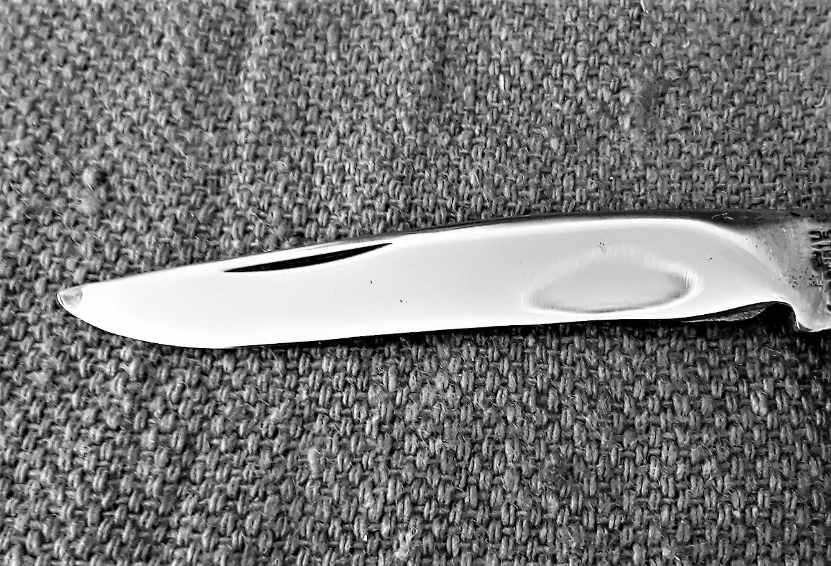

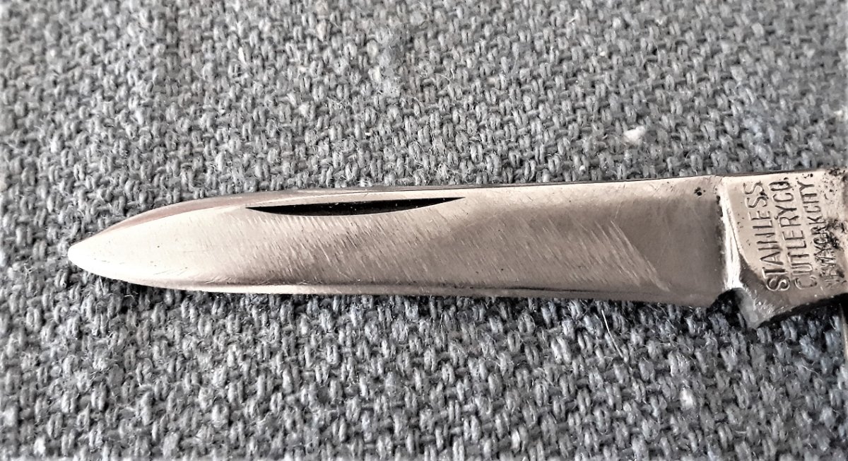

Just want to show how I'm cleaning blades. These were some old knives I had in the bottom draw that were in poor shape and I wanted to show how I go about cleaning the blades. 1) I use a "Super Eraser" on the blades and bolsters. 2) I then put a light film of "Sentry Tuf-Glide" oil on the surface of the blade. 3) Depending on the condition of the blade I will start with 240 to 400 grit paper on my dremel tool. Heavy pressure at first and in one direction from tang to tip moving very slowly. Then only lightly touching the blade moving slowly tang to tip. 4) Now add more oil and go up to the next grit and repeat step 3) again. After 400 grit I will use a combination of 600, 800, 1000, 1200, 1500, 2000, 3000, 5000, 7000, and 10,000 girt paper depending on how the blade is looking. When I've achieved the finish I want with the paper I will finish by polishing the blade with FLITZ polish and buff clean.
Sometimes there are cases that I only use the Super Eraser and the FLITZ polish on the blade, because of the overall condition of the knife. Anyway here are 3 knives I just finished the main blades.
Before
After
Before
After
Before
After

dlr110 wrote: Sun Jun 28, 2020 9:18 pm Just want to show how I'm cleaning blades...
Nice work! I use a similar process. Using a Dremel on them always scares me a bit. You have to be so careful that you keep the wheel spinning in the right direction or it could catch and throw the knife at you. Same deal on a standard buffing wheel. There is some risk involved.
Due to this I usually hand-sand the blades up to 10,000 grit. Often they are submerged in water (if that won't wreck the particular handle material) during the sanding so the paper doesn't clog and the black sanding residue doesn't stain anything. I use my Dremel with some Flitz for the final polish. Similar results. I expect using the Dremel throughout would be much faster.
I don't always respond to great posts but I always appreciate seeing them. Thanks for posting! ::tu::

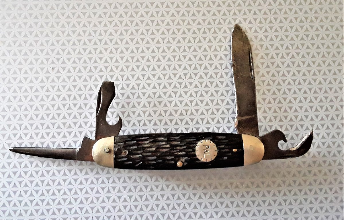

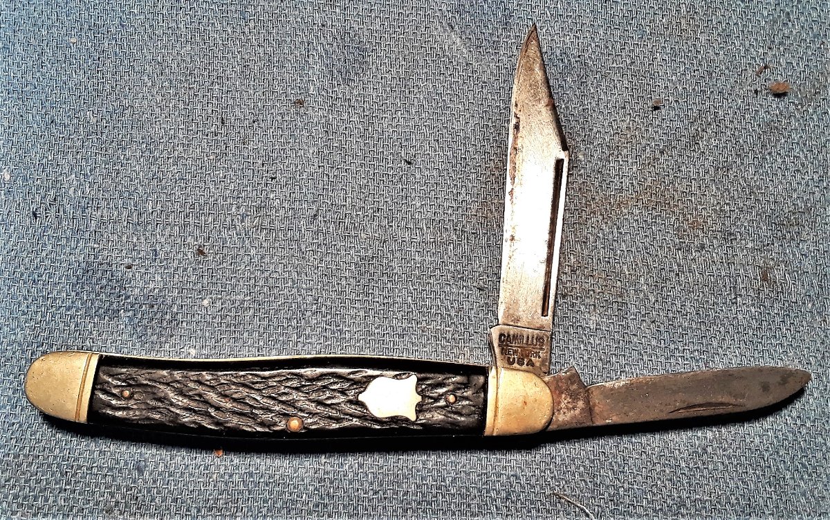

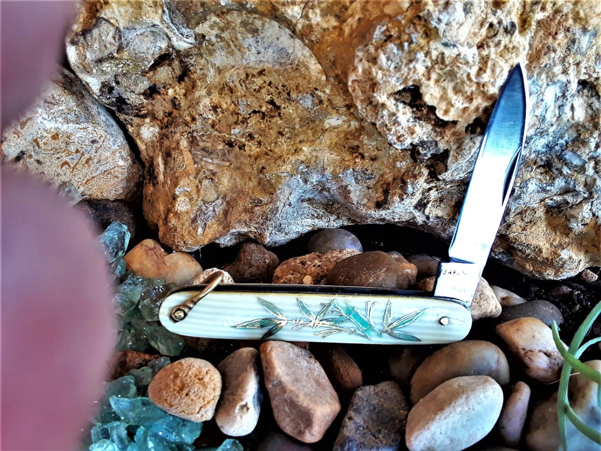

The little souvenir knife was easy to clean, but the PAL was a challenge. It still has a log of
pitting and scratches on the main blade and the bolsters were in bad shape. So that is about
the extent of my knife cleaning abilities.
Before....
After....
Before.....
After....

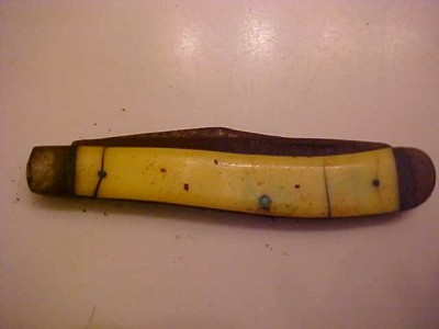

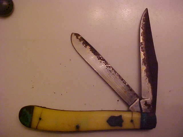

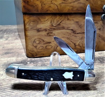

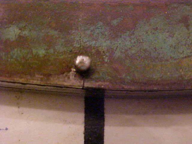

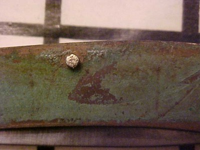

Here is a little CASE that I was able to clean up with some polishing cream.
I'm going to go out on a limb and say that short of new scales there is no
way to correct the green tarnishing.
David Roberts
Prayer Changes Everything
edge213
Posts: 8468
Re: Knife Cleaning
Post by edge213 »
dlr110 wrote: Mon Jul 06, 2020 3:08 pm Here is a little CASE that I was able to clean up with some polishing cream.
You are correct. From my experience it will only get worse.

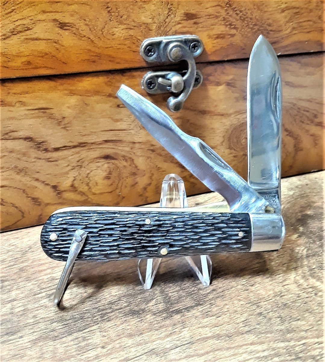

Post by dlr110 »

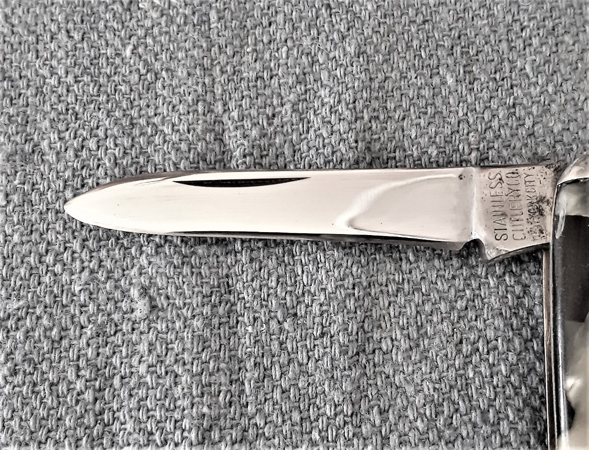

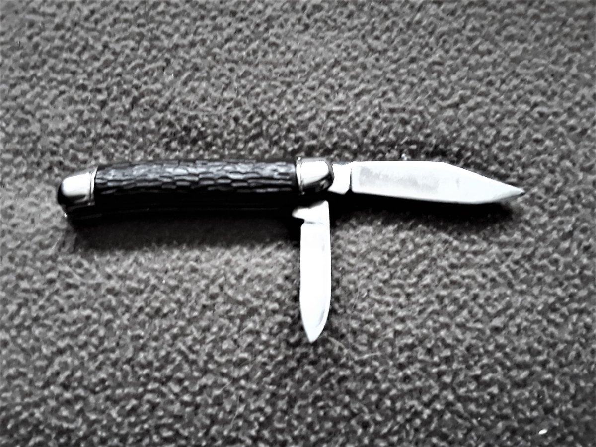

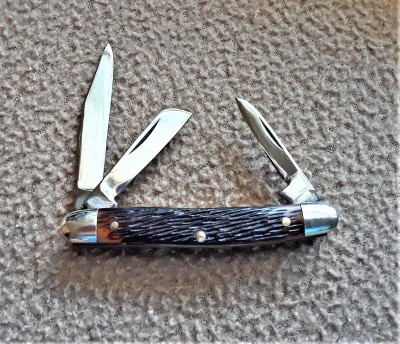

Craftsman U.S.A. 9473 Mini-Stockman 2 2/4" Long Closed.
After I cleaned this little knife up it was almost as if it came alive.
Everything is in great shape. It's tight, no wobble and the snap is
crisp in every blade. I think this was one of my best finds in a while
Now if I can find out who the exact maker was and around what year.
BEFORE
BEFORE
BEFORE
BEFORE
AFTER
AFTER
AFTER
AFTER
David Roberts
cudgee
Posts: 6930
Re: Knife Cleaning
Post by cudgee »
dlr110 wrote: Sat Aug 08, 2020 8:13 pm Craftsman U.S.A. 9473 Mini-Stockman 2 2/4" Long Closed.
That is a GOOD job. ::tu:: ::tu:: ::tu::

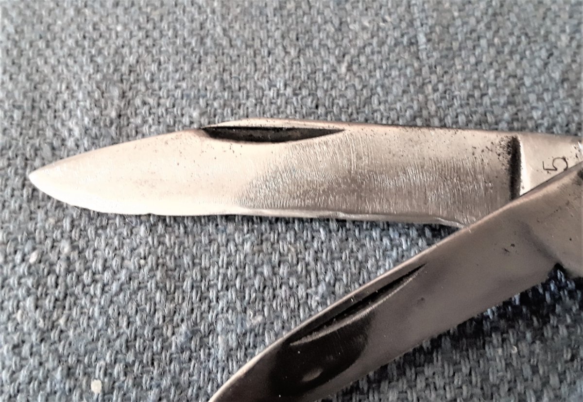

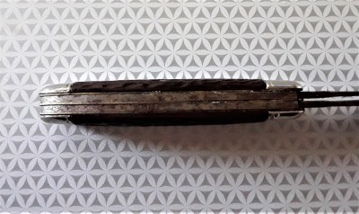

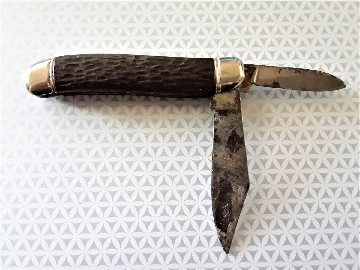

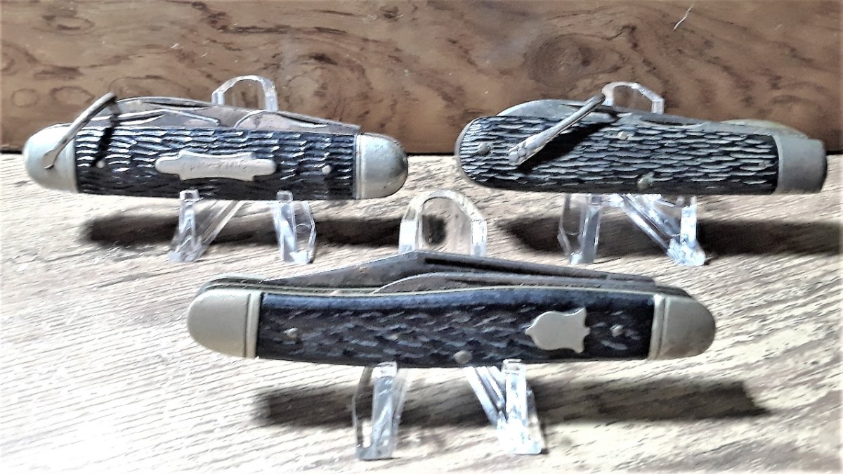

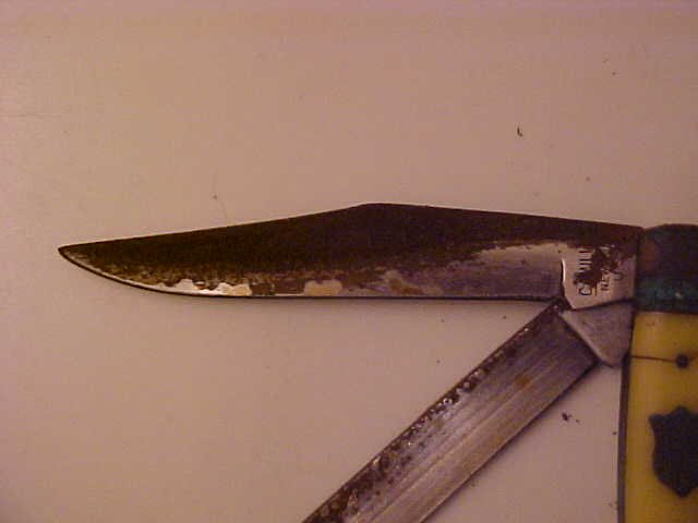

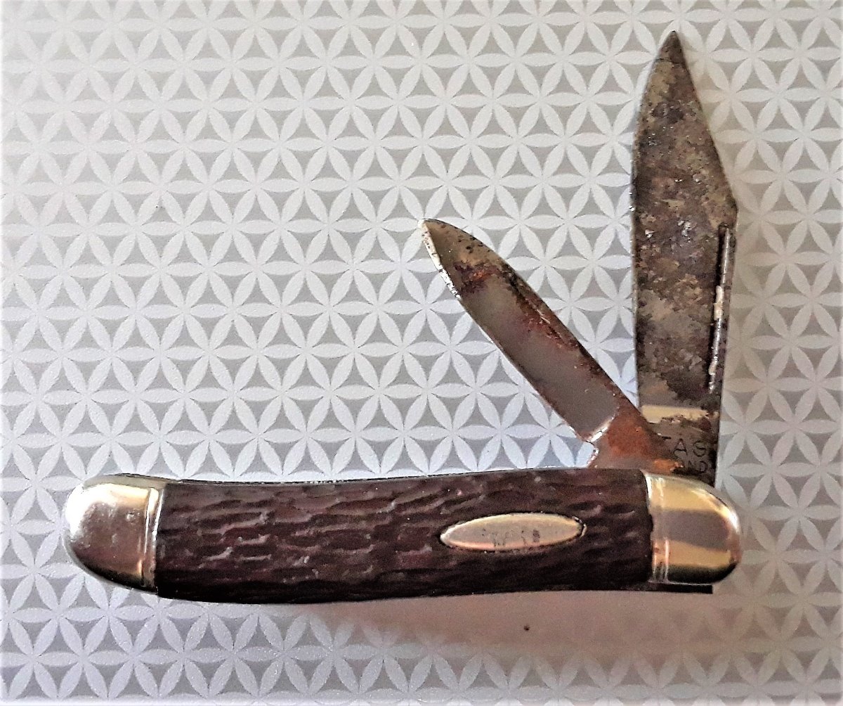

Here's 3 rusty messes I got and cleaned up.
BEFORE
BEFORE
BEFORE
BEFORE
AFTER
AFTER
AFTER
AFTER
AFTER
AFTER
David Roberts
cudgee
Posts: 6930
Re: Knife Cleaning
Post by cudgee »
dlr110 wrote: Sat Aug 15, 2020 6:38 pm Here's 3 rusty messes I got and cleaned up.
20200814_145057.jpg20200814_190900.jpg20200814_201822.jpg20200815_132607.jpg20200815_132819.jpg
You could start a little cottage industry. :) :) :) ::tu:: ::tu:: ::tu::

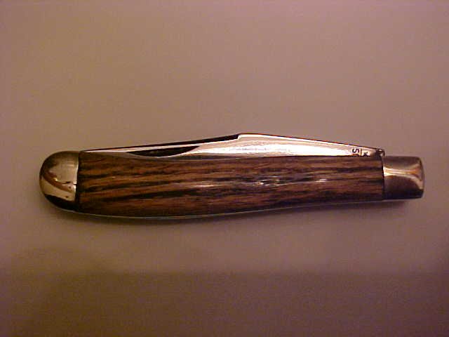

Here is one that most would probably have passed by as too far gone. I like challenges so I got it(the guy gave it to me)and decided to try my hand at rejuvenating it. The blades although quite corroded by the handles out-gassing were actually better than they looked.
The first order of business was getting rid of the handles.When I removed them I noticed that the out-gassing had corroded the brass liners to the point that they started to crack at the center rivet.This is a common problem with celluloid degradation.
Once they were removed I scrubbed the liners with some spray battery cleaner for automobiles(I think it is mostly baking soda)and a stiff nylon brush.Dried them and polished with a gray scuff pad.There are two grades of scuff pads:gray(fine)and red(coarse).I use both in my work and keep the used ones around for cleaning knives.
I made a pattern for the handles by cutting an index card(5x7)to fit between the bolsters and pressed it over the handle rivets which were still in place.I taped these to a couple pieces of scrap wood from an old cigar box and drilled the holes for the pins.I then cut them to fit between the bolsters and temporarily installed them one at a time.I trimmed the sides to fit using a sharp knife and finished them with a file and 100 grit sandpaper. I then rounded the tops down to the height of the bolsters and then glued them into place with epoxy. Final finish was with 220 grit paper and a bit of Mother's Mag Wheel Polish. I left them that way for awhile until I decided to try jigging them to look like bone. For this I used a small ball mill bit and a Foredom die grinder.I found that doing them one row at a time was fairly easy and the spacing could be varied a bit.After this I rubbed them lightly with Mother's again just to remove any rough edges.

Re: Knife Cleaning
Post by cudgee »
Simply "Brilliant". I am in awe, great job and well done. ::tu::
