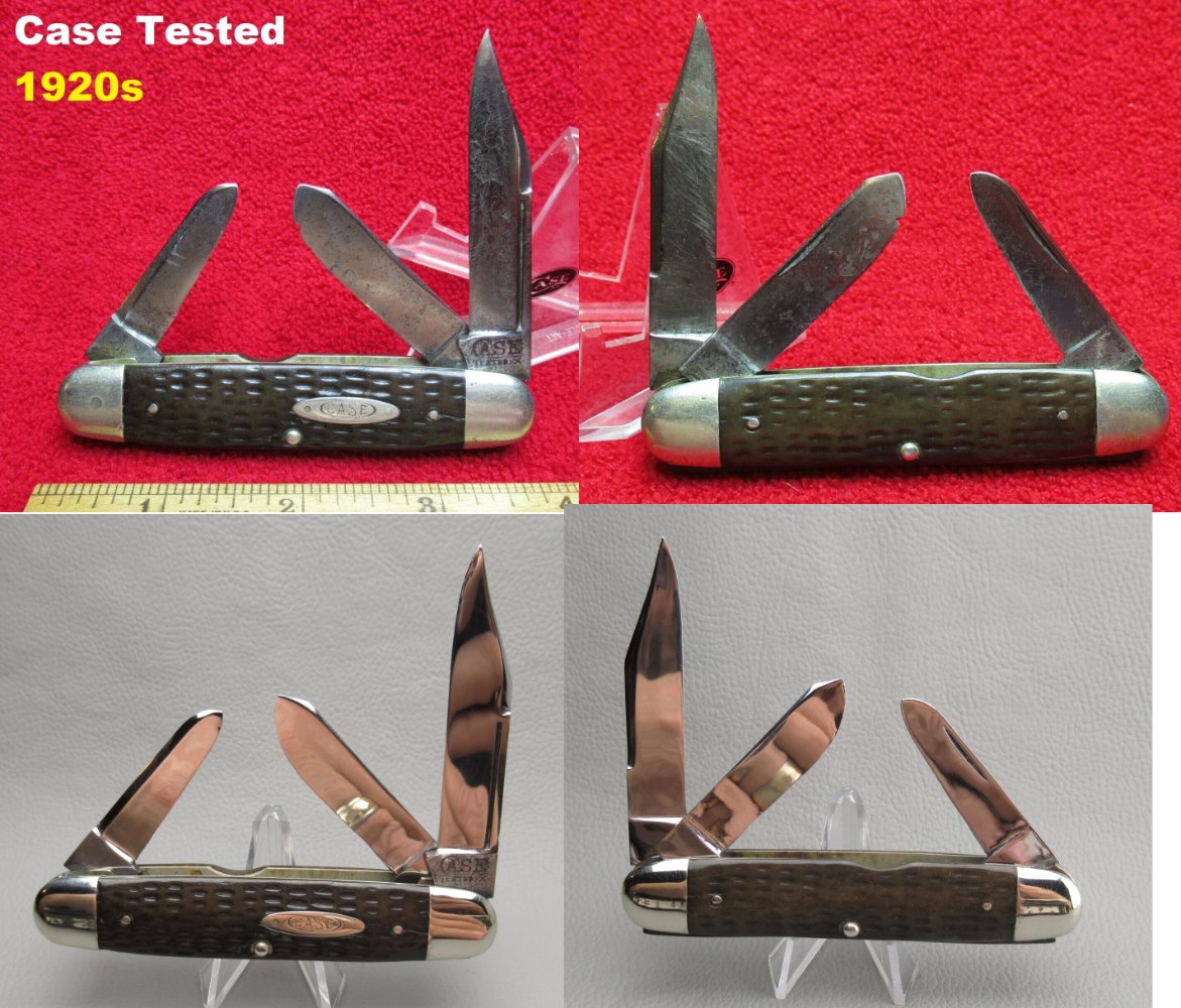

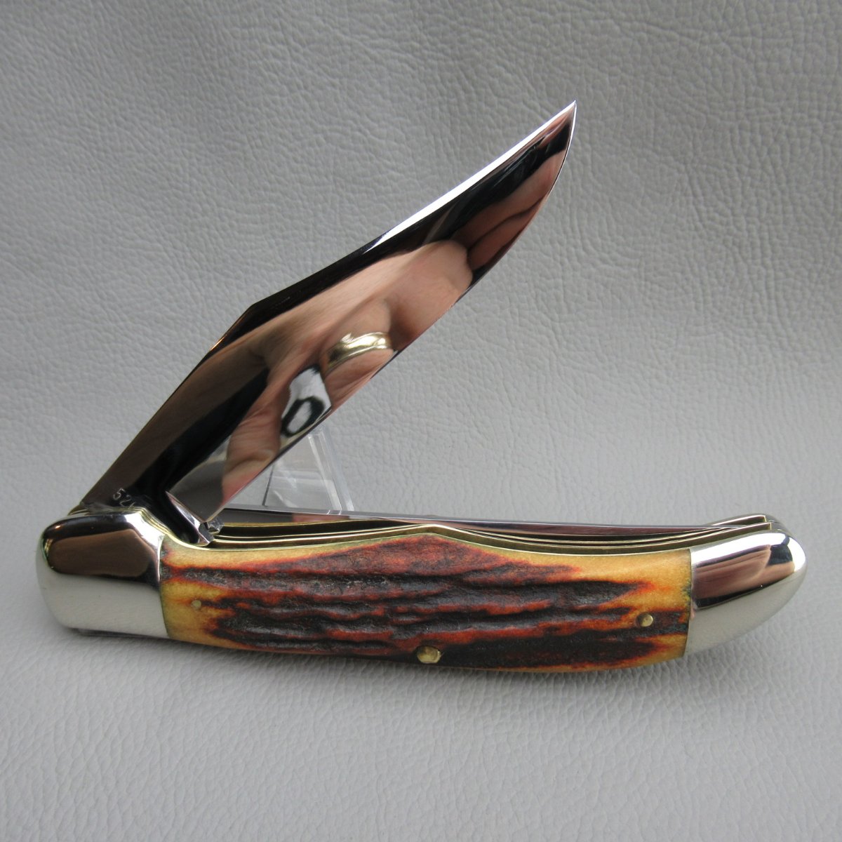

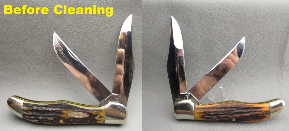

Hey Guys, I just finished this Case tested knife yesterday. One of my knife friends offered me a trade that I couldnt resist But said I had to work my magic on this Tested for him,,,LOL. Lord have Mercy on me, I do believe he got the better end of the deal this time, LOL hahaha. I worked very hard on this knife & Honestly I didnt know if it would turn out any good. It was a difficult knife to do. I think I did a pretty good job considering how bad it was.

Looks just like those high $$$ knives a guy on eBay sells. Said it once and I'll say it again, great work!

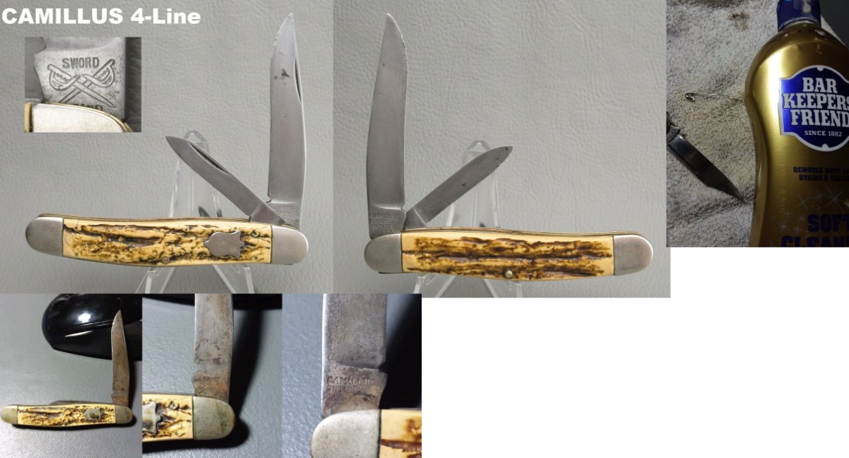

Hey Guys, for those of you who are enjoying this page, I do intend on "SHARING" my Knowledge & past experiences with "Knife cleanings" as time goes on. Its a Love & Passion of mine & NOT a "Secret" nor is it suppose to be. Knife restoration is similar to "Car Restoration" and that is no secret either. It can be a "Shade tree mechanic" job or it can be a "Barrett Jackson" job. I truly believe that ANY type of Restoration is all in the hands & eye of the person doing the "Work". My Goal is for all of us to Learn & Help each other in knife restorations. I hope you guys continue to follow this page & SHARE your little "Secrets" too.
My 1st little secret I just found out myself a month or so ago is this "Bar Keepers friend" household cleaner. Guys, This is a RUST remover & boy does it WORK GREAT on Antique knives ESPECIALLY the TANG STAMPS. It will NOT HURT the TANG STAMPS itself & cannot breakdown the CARBON inside the letters. I LOVE this stuff & SO DOES THE WIFE for her pots & pans/counter-tops/clothes washing/porcelain toilets/etc!!! So buy your wife a couple bottles & yourself one in this 3-pack version for less than 15-bucks... This stuff goes a LONG WAY!!!
https://www.amazon.com/3-PK-Keepers-Cle ... 6292&psc=1
Now take your safety pin to help clean out the tang stamp letters & this stuff will do the rest of the work for you. Absolutely NO SANDING required.. You rub it on & then rub it off, its that simple. Please dont leave it on very long & work slowly at your own pace. This stuff is also used in "Patina aging" so it can be used for many different things(((if you leave it on the carbon steel too long, it will cause it to rust))). You will get use to it & its affects as time goes on with its use. What I enjoy about it & its affects is that it DOES NOT REMOVE ANY METAL,,,,Simply just the RUST!!! After you use this stuff, Immediately run some oil on your fingers & then over your work area that you used it on. Its Water-Soluble too. Also, DO NOT get this stuff around any type of rubber/plastic/celluloid/ Etc knife handles because it will eat it up quickly & it will REMOVE Ink etches, Punch blade bluing etc,,,BE VERY CAREFUL with it. Here is an EXAMPLE of its "Magic". I used it on this particular knife w/ great results

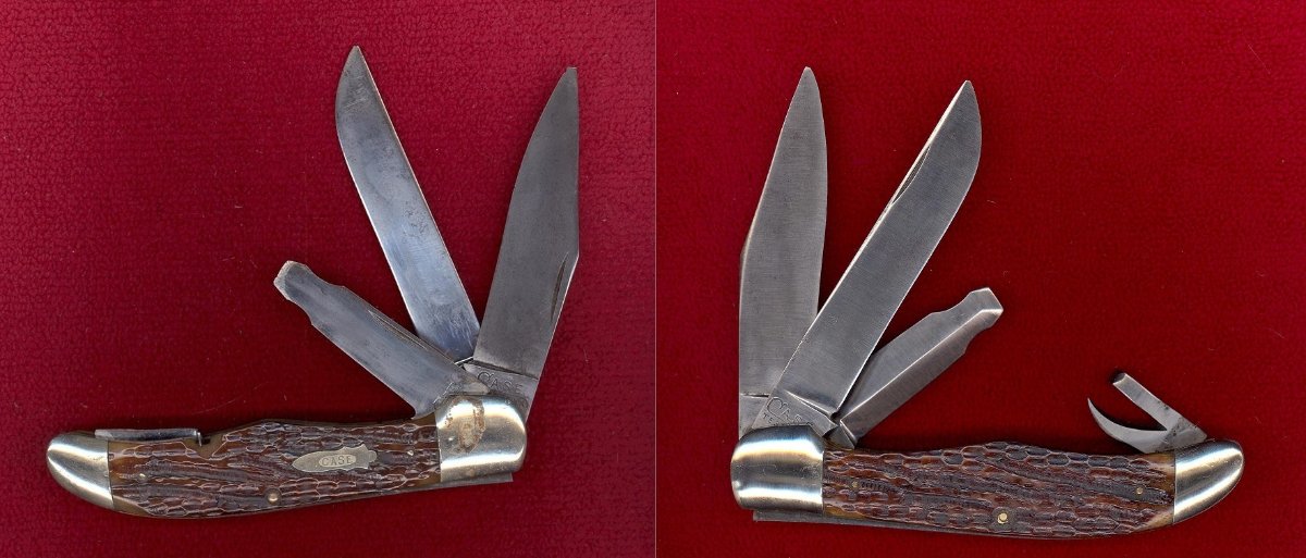

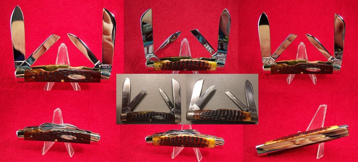

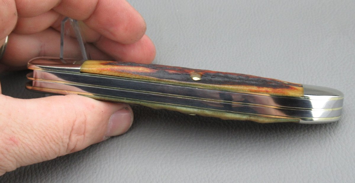

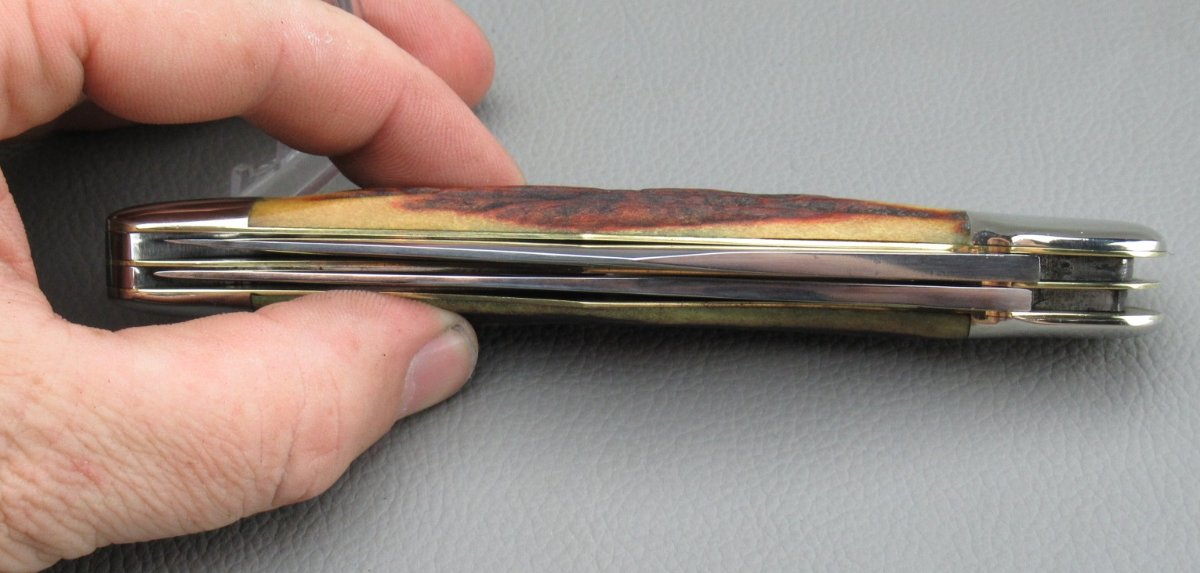

Hey Guys, Here is a different knife I did a year or 2 ago. The reason for a slightly different color of the back handle is merely a "camera issue". I used a different camera back then & unless you have the proper settings on a camera, it changes your colors without you realizing it does. Camera photography is another subject altogether & its quite difficult even with today's technology to capture "correct coloring" of a knife handle without spending a ton of money on camera equipment. I always used a $50-camera until earlier this earlier in which & very nice humble rich knife guy sent me a better $300-camera to use. I feel very blessed sometimes

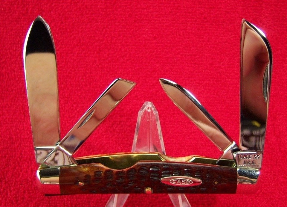

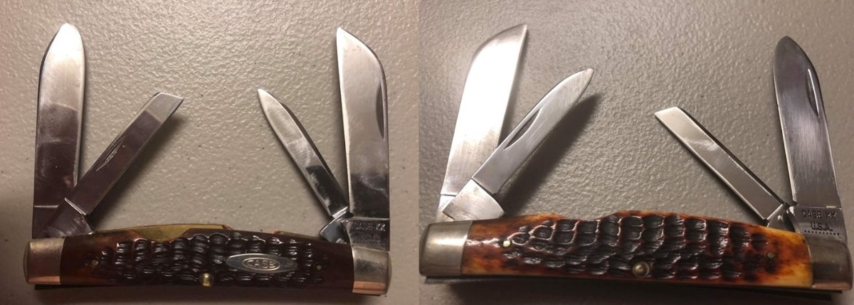

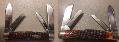

One more to add!

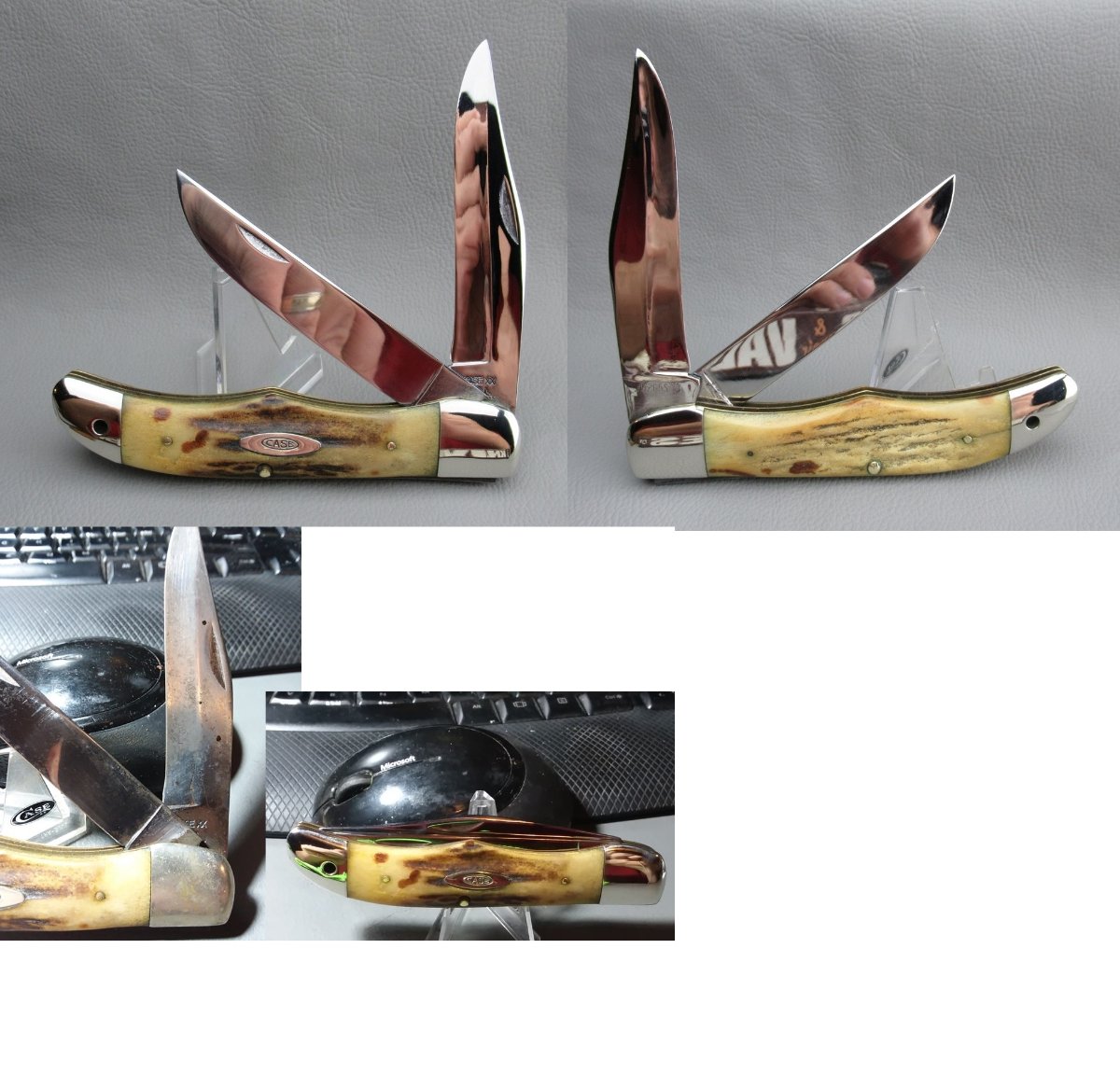

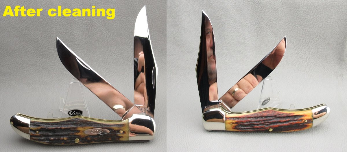

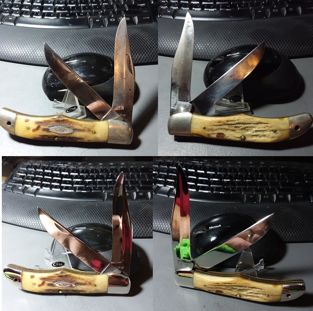

Hey Guys, I Just cleaned this knife a day before yesterday. Took me 16-hours,,,I worked on it all day & all night for the guy who bought it off ebay
https://www.ebay.com/itm/Case-XX-Awesom ... 7675.l2557
If you look really close in the "After Cleaning" backside picture of the knife opened,,,You should be able to see, ME!!!! hahahaha
If you wondering why it took me so long, I had to re-create the "center grind line" on both sides of the master blade. It was previously buffed to the point of that center grind line was not there at all in person. Its been one of the best knives I have done to date & This knife I went to 7,000grit finish so thats why the knife has a "Bling" & Clarity!!!

That 6465 is gorgeous.

Rattlesnake, I'm impressed with your work! Thank you for the tip on Bar Keepers Friend as well. I bought some this morning and used it on an old Camco scout knife that was a rust bucket. It works great! I put it on and used an old toothbrush to scrub out the well and the tang of the knife. The rust just melted off! I rinsed it under running water and put it in my ultrasonic cleaner and more crud bubbles out. I've got it soaking in mineral oil now and can't wait to see how it turns out. Even after the initial cleaning I could tell the snap had been restored!

Hey Byrd, Thank you Sir for the Compliments & your very welcome on the Bar Keepers friend... I was reading on the internet last month about antique rulers & tools & that is where I seen the info & restoration of hatchets etc with the use of this solution. I thought to myself HEY MARK, Try that stuff on a rusty knife, lol. Low & behold the stuff is amazing!!

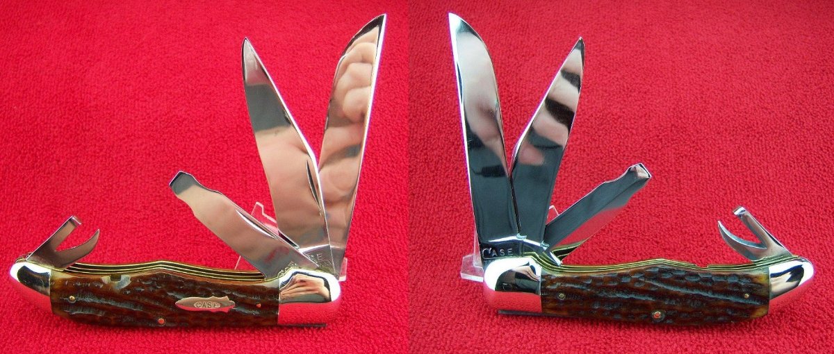

Hey Guys, Just got done cleaning up this 10dot for a good friend of mine. He has owned this knife for over 40yrs & skinned many a deer with it. I took good care of his knife for him & did this restoration as a Gift of friendship. This was what I been working on the last few days! He & I been talking about the "cleanings" that I do...He feels that its more of "custom" work. I tend to agree especially when I have too recreate grindlines & swedges etc cause they are not there anymore. Just food for thought

Amazing work!!!
