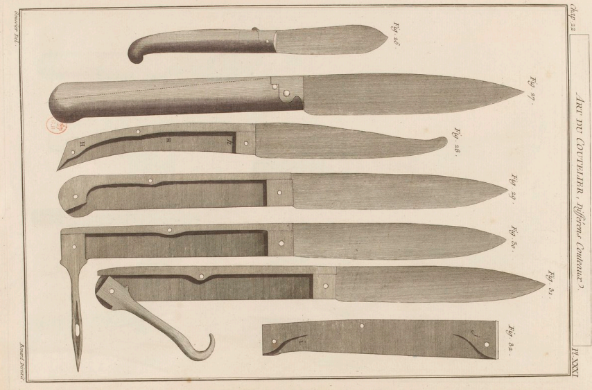

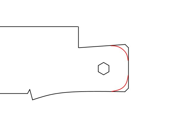

Very interesting topic. Thank you all very much for your opinions and for the link to the article, it is very informative! My friend has now started making slipjoints, I help him a little. We settled on the option with a half-stop, as we think it is safer. The simplest example is a douk-douk, a very good knife with a very powerful spring, if it did not have a half-stop, many people would lose their fingers. With a knife without a half-stop, I myself cut my fingers very badly when closing it, it slammed shut like a mousetrap. It has a strong spring and when you start to close the blade, after the moment of starting it flies straight into the handle
It seems to be a combination of spring force and shank shape. I have 2 old Boker Slimlines. One NOS, the other is very worn, both from the 70s. The used one has worn down corners and now it closes and opens very sluggishly, it can never cut your fingers. The NOS clicks quite loudly and if you don't remove your fingers, they can be cut. I feel something similar is happening on my GEC, when it was new it clicked with a very bright sound, now after 15 years of constant use it has become softer, probably also due to wear. I roughly drew the difference between a new and a worn (red) Boker

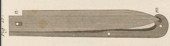

I have another thought, once I was in a Spanish museum and was looking at old navajas. Some had a multifaceted shank, i.e. 6-8-10 positions between opening and closing. Perhaps this was done to create a specific sound effect, or the springs were so powerful that it was necessary to make more than 1 half-stop. Unfortunately, the museum worker did not allow them to be removed from the glass and touched
In Perret's 1771 book, one of the volumes contained variations of folding knives that he made. It is in the public domain and available for download
https://gallica.bnf.fr/ark:/12148/bpt6k10656043
I've highlighted some pages from the book, it looks like in 1771 in Paris, Master Perret favored square shanks. Or are these not complete drawings, so as not to reveal all the secrets? Although I do see a couple of interesting friction folders. I noticed an interesting design - protection against spontaneous opening. To open the knife, you need to pull the blade towards the axis and then open it
