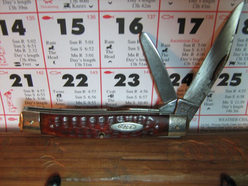

They used spot welding well before 1970 and still do today. Those really are the spot weld marks just as I've seen them made at the factory.

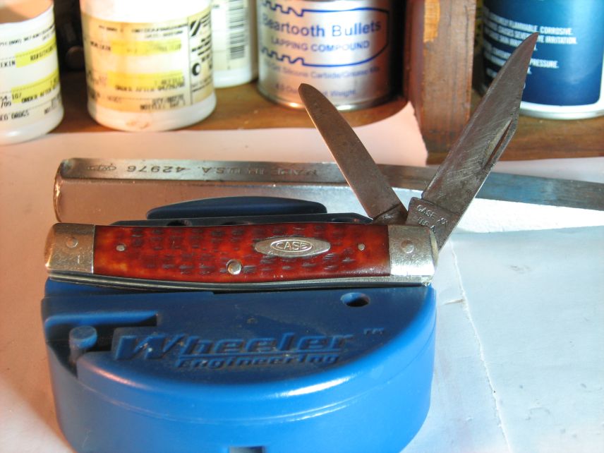

No problems I am stuck at the moment with the Case PJ while I do some practice work on a little Colonial 2 blade Jack. I have cleaned things up good and ready to start peining. I don't really know where to start. I guess I will just put in pins for now and then try to put in spacers at blades. Then do some peining.

I beg to differ sir. On the left is a liner from a case 54 pattern from a 70's era knife On the right is a liner from a case 54 pattern from a modern (late 90's or 2000's era knife). As you can see the older liner has a pinned on bolster, the newer knife has a spot welded bolster. You can see the difference in the marks on the underside of the liners. The spot welded liner just has a small dimple, the pinned liner has a bradded over (but flush) pin showing that was integral to the bolster. Chief's knife clearly exhibits the latter bolster attachment method.Elvis wrote:They used spot welding well before 1970 and still do today. Those really are the spot weld marks just as I've seen them made at the factory.
Not trying to be an ass, I just hate the spread of misinformation. There's too much of it floating around the world already.

Differ if you must, but the round marks near the pin holes in the original pictures are from the bolsters being attached to the liners. As I mentioned before, even the one at the end of the main blade spring has one, and it gets no movement.

Ummmmm.....I agreeElvis wrote:Differ if you must, but the round marks near the pin holes in the original pictures are from the bolsters being attached to the liners. As I mentioned before, even the one at the end of the main blade spring has one, and it gets no movement.

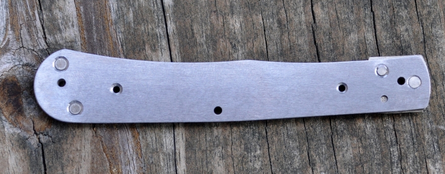

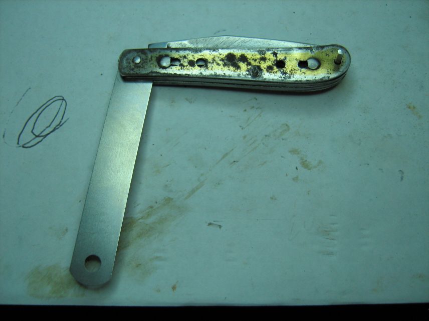

Very interesting again! I thought they looked kinda round and even for a weld, although I never would have thought they'd drill right through the center of the tommy pin either. I'm more accustomed to this type of setup, where the pins are offset from the bolster pin hole:

And I was just trying to point out that the original liners weren't damaged, but the set you have pictured here are a bit different. Who made those? I like the double pin set-up (even though I've considered buying a spot welder).

Bob, that's a modern Canal Street trapper scale. Most of their knives are pierced the same way, although I'm not sure about the cap end of the single blade, that's a pretty small piece, gonna have to check it out tomorrow.

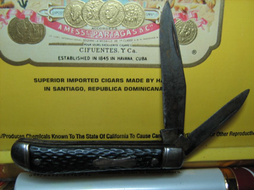

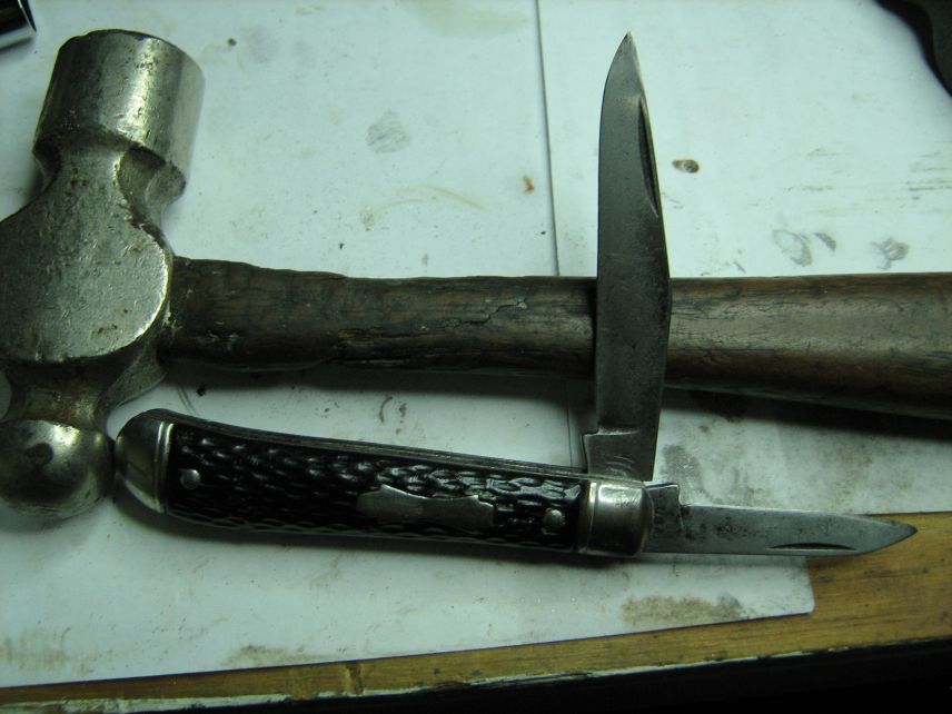

The little Colonial is back together. It tightened up a lot and I will shine it up a bit. I got a lot of peining practice and learned a little about pinning one back together. One day I may put some scales on this one. Maybe some deer antler I make myself. that would make a 2 dollar knife into an heirloom. Man I have a long way to go to get to there. I hope the fire keeps burning.
I forgot I had a before and after. I guess you can tell.

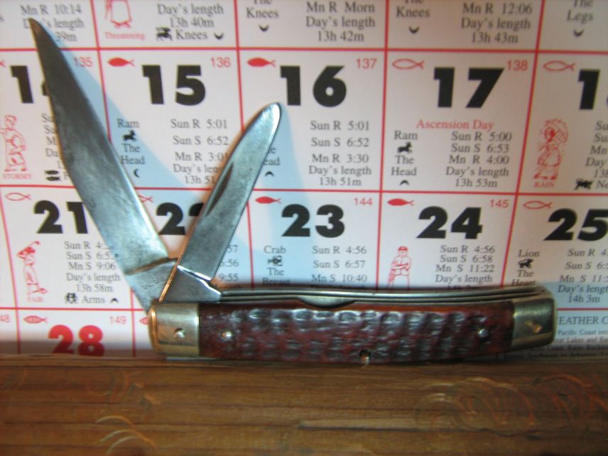

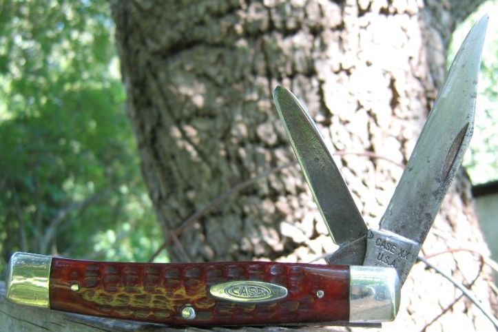

I stuck some pins through the Texas Jack this evening. I will be doing some serious peining tomorrow. Things are looking OK but this bone is very brittle. I have learned a lot and thanks to folks here, I am almost done with this one. I don't know that it will ever be good enough to trade but it will be a good one for me to carry and remember the lessons I have learned. Maybe it will get new handles one day. Who knows?

soak it in lemon oil overnight to rehydrate the bone, it will also make it softer and less prone to cracking. I've heard old time Sheffield cutlers used to do this before taking a knife back apart to minimize the change of scale damage. I practice this also.

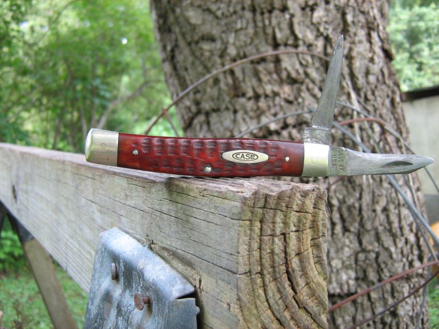

Lemon oil will be on my list. Well here she is. All peined up and ready to spend some time in my pocket. I have lots of finish work to do. I do not have power tools so I will be hafting, if that is even the right term, with lots of elbow grease.
