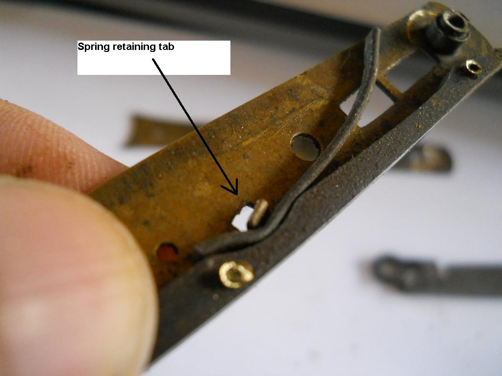

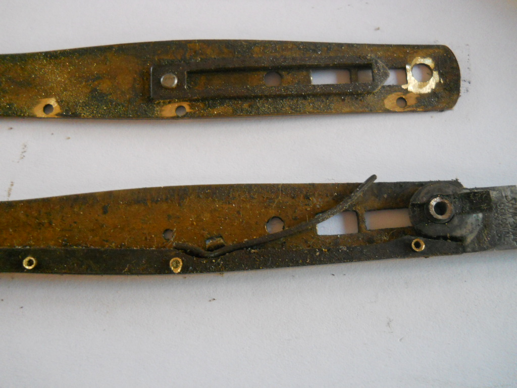

WB, tomorrow I will finish disassembling the frame.
The first thing I'm going to do before dis-assembly is to try to hook a dental pick under the
spring tab and see if I can pull it up enough to free the spring.
I'm REALLY hoping this will work because you won't have to disassemble the whole knife
to replace a broken spring.
I'm going to grind and tap the hollow pins out and replace them with solid ones.
This should really tighten-up the whole knife assembly.
I will trace the radius of the spring when I get it out and take some measurements so we will be
able to make replacement springs for the Shur-Snaps.
The sheer is broken off on the other knife so I have my work cut out to make a new one.
This will involve a lot of filing on a piece of solid stock, but at least it is simple in design
unlike the Imperials contoured sheer design.

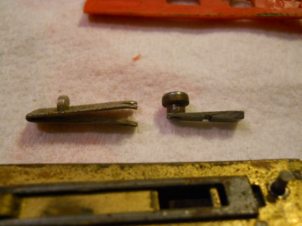

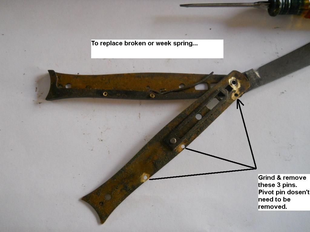

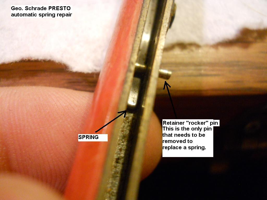

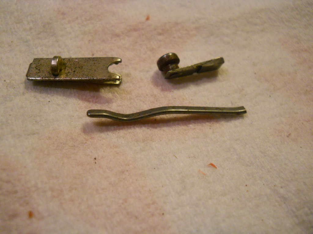

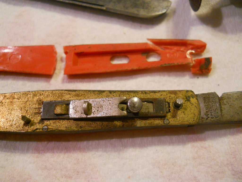

O.K. Here's the spring in the Colonial Shur-Snaps.
DON'T remove the pivot pin if you only intend to replace the spring!!
(It is more like a standoff/bushing than a pin and would be hard to make a new one.)
.... Joe
.... Joe

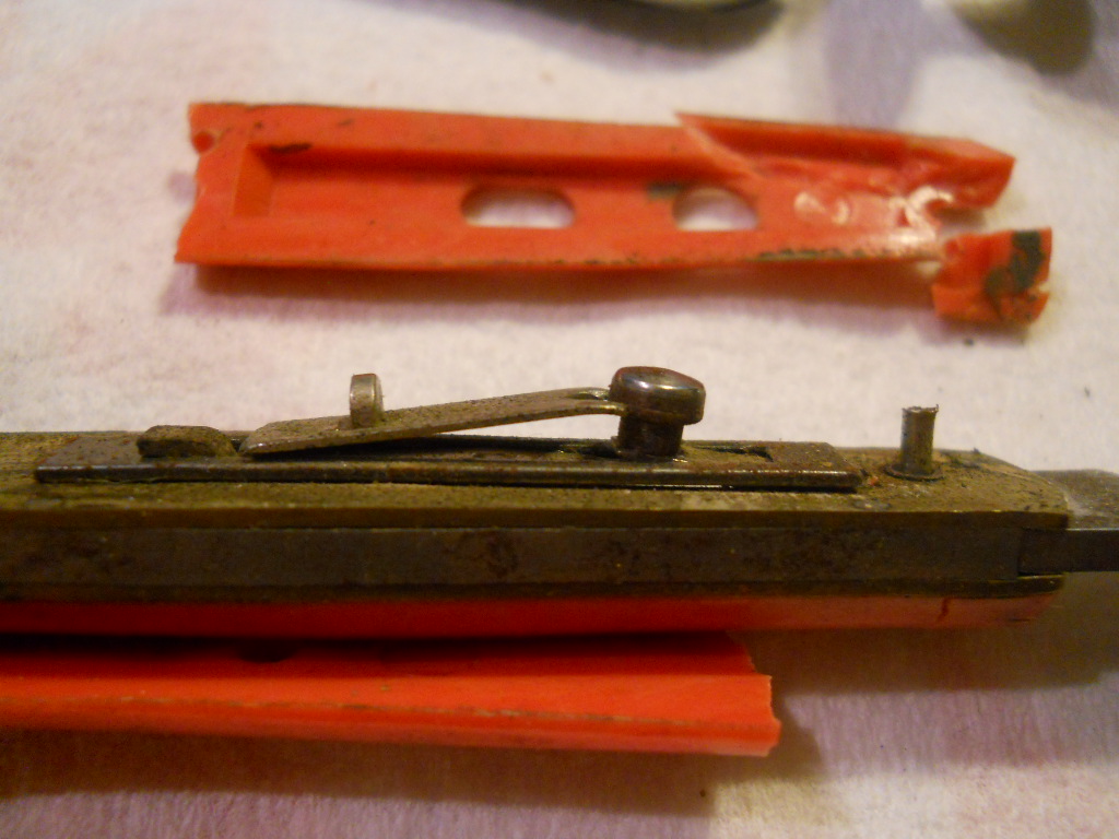

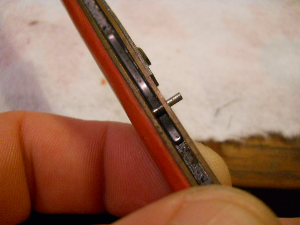

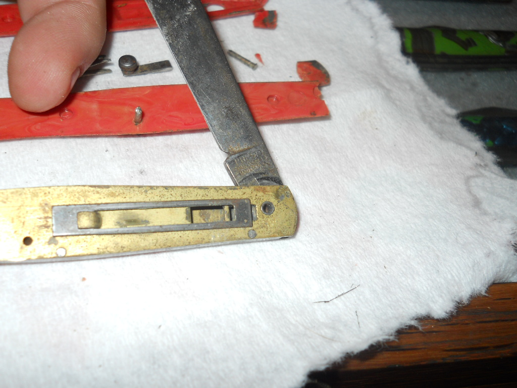

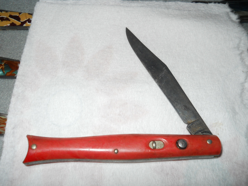

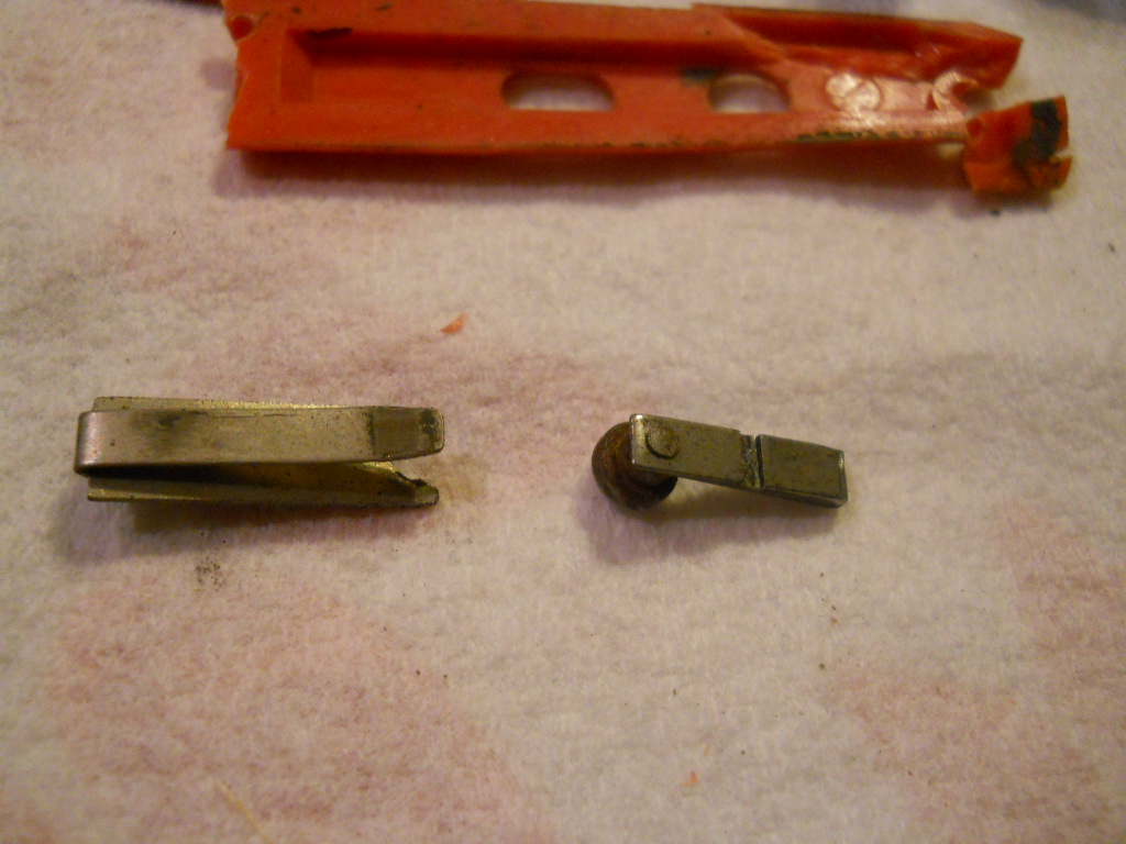

And here's the Presto.
The scales on the Presto are made from some type of VERY crappy composite plastic.
Expect to make new ones.
The scales hold the lock and button in place on all 3 knives.
I will post dimensioned drawings of all the small parts for all 3 knives.
All three are almost the same in design.
******Could one of the moderators please move this topic to Knife Repair and Restoration? Thanks!******
..... Joe
..... Joe

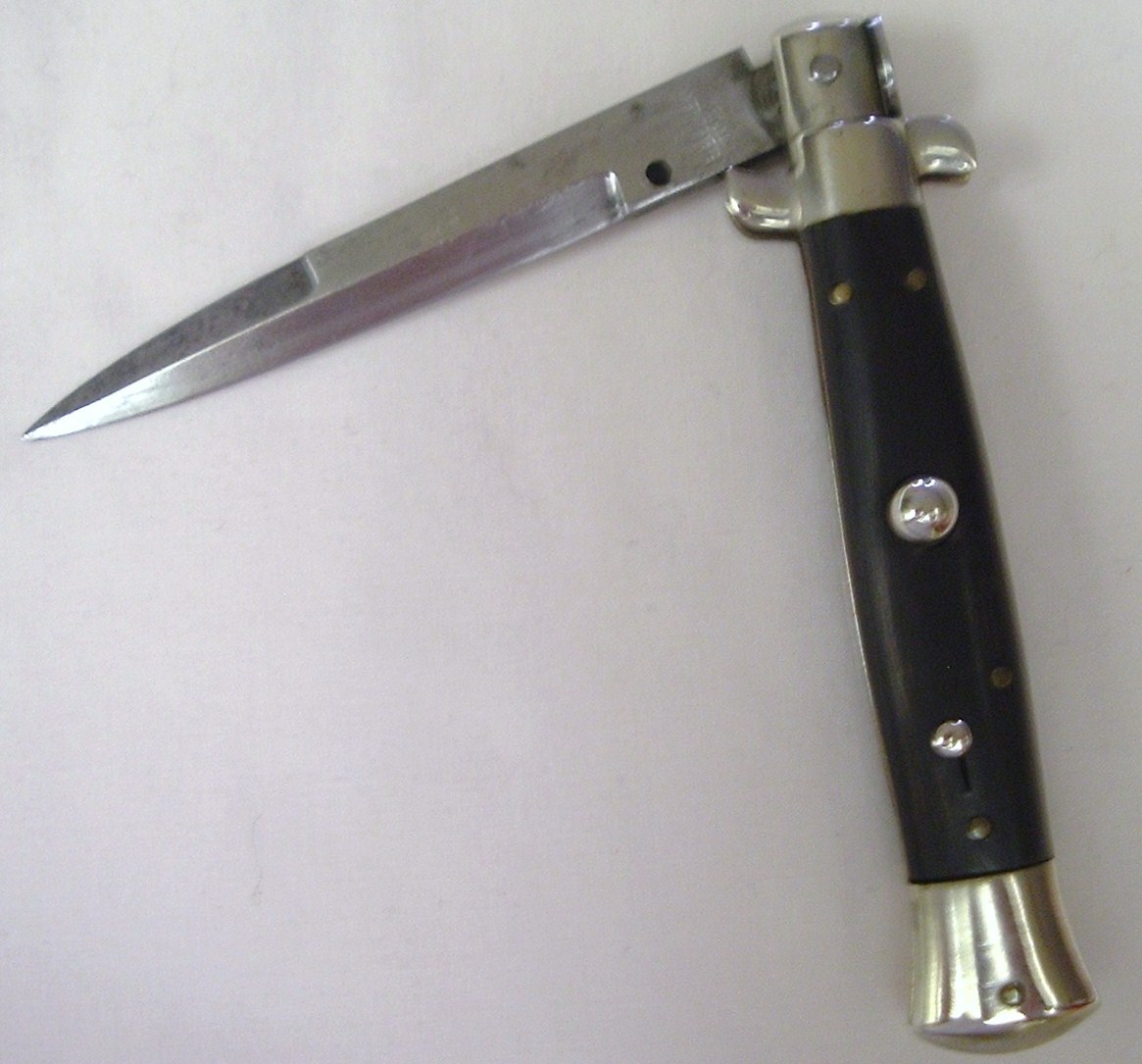

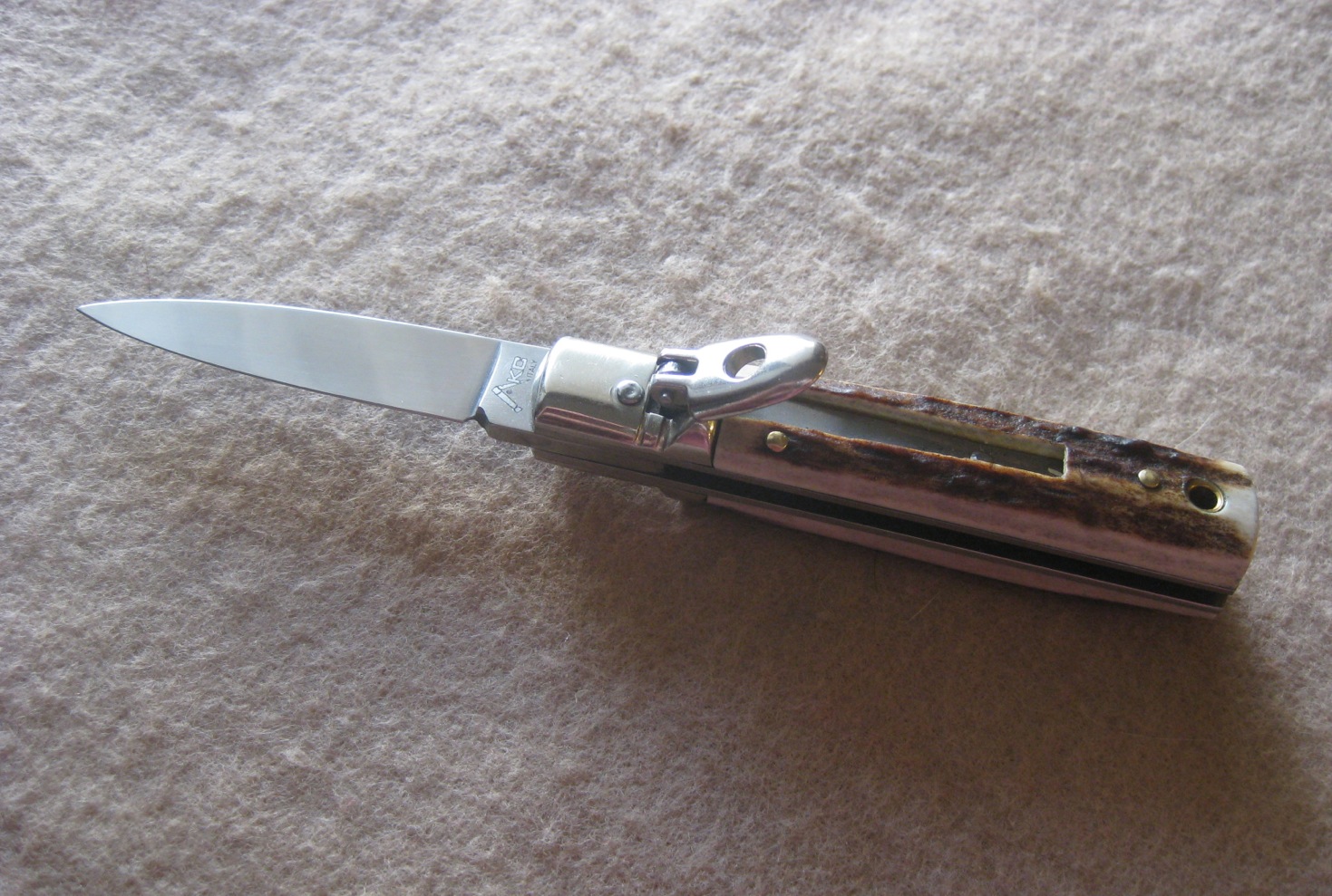

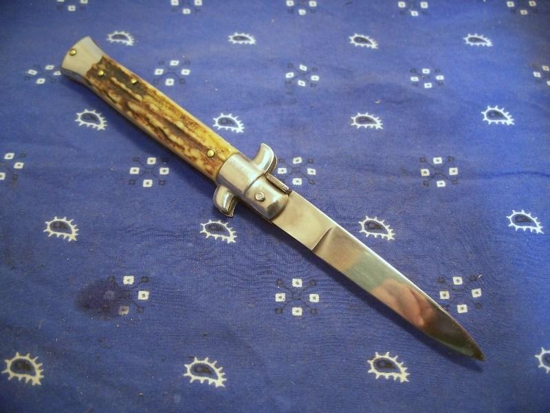

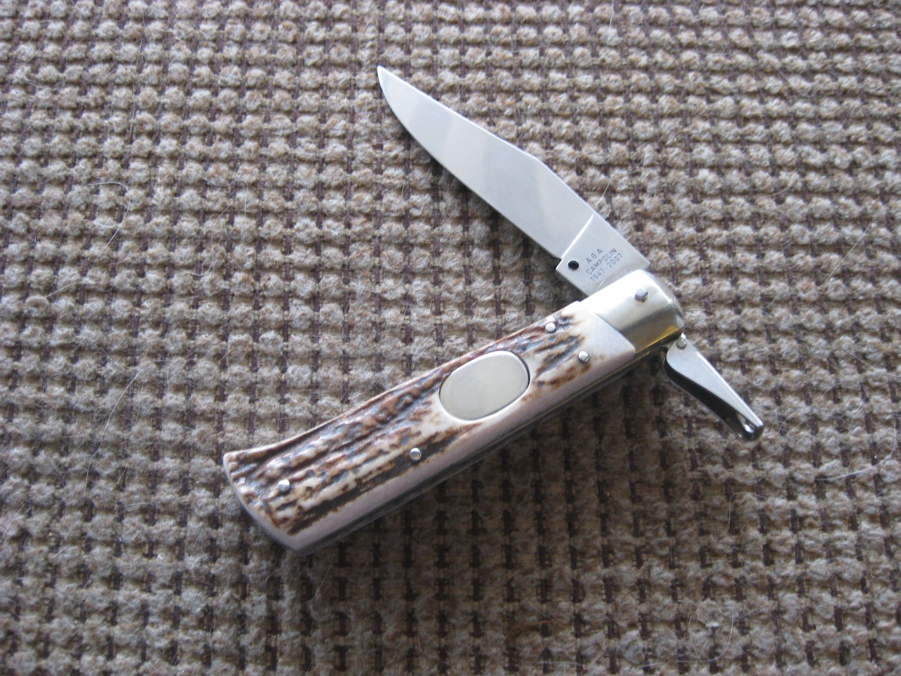

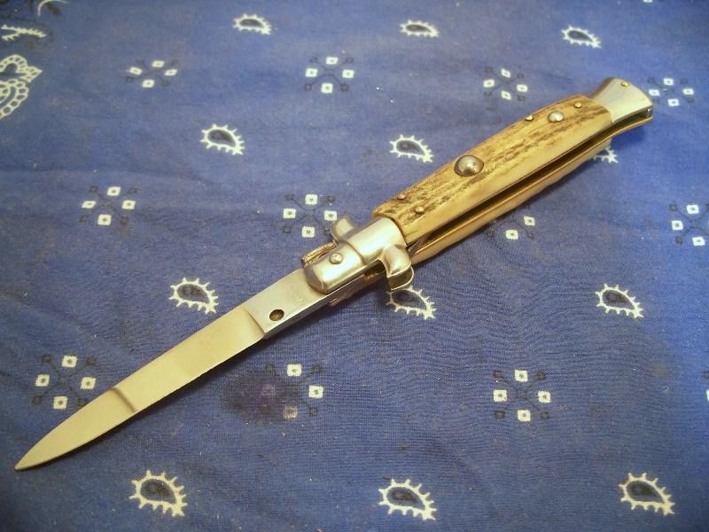

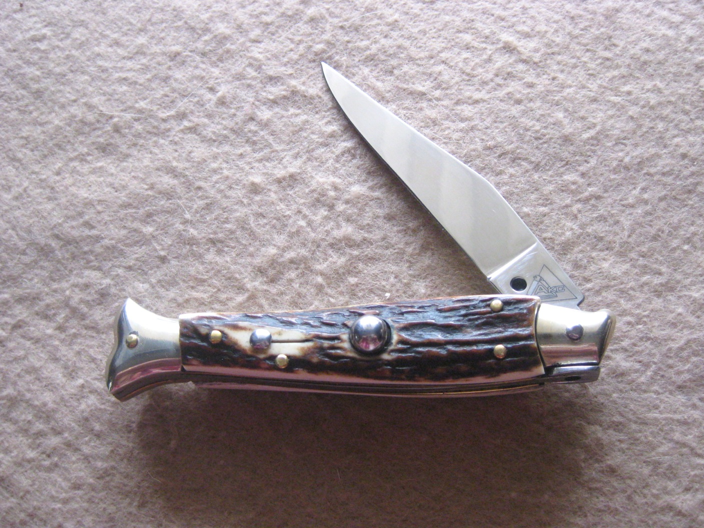

Just snagged this great looking 9" NOS 1960's Italian Stiletto in Stag from MM.
I have scored a few very nice autos in unbelievable condition from MuskratManKnives.
IM
IM
AAPK #6581
- singin46
- Posts: 8126
- Location: MUSIC CITY
Re: Switchblades?
That's funny Trevor, I was about to pull the trigger on that one as well. You have excellent taste!

Ya gotcha a nice one there Trevor! Hard to beat Stag handles.
WB
WB

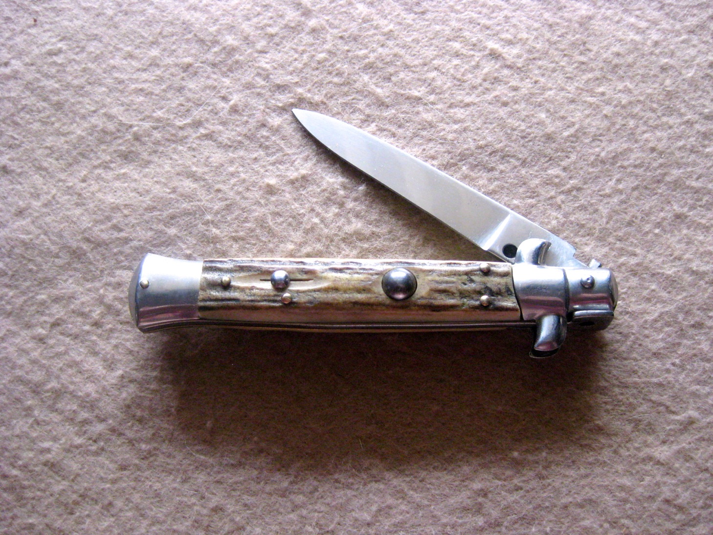

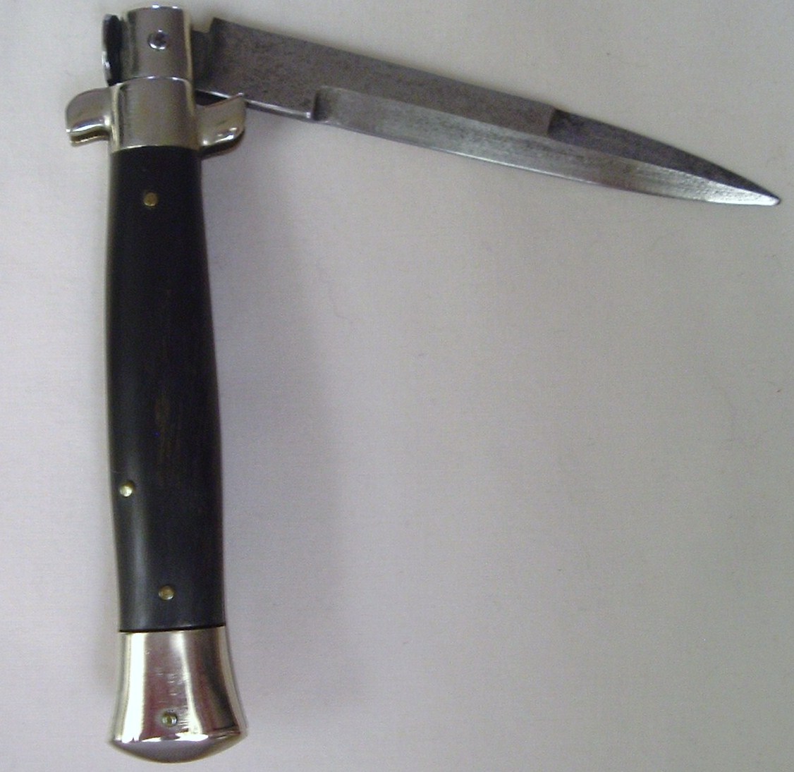

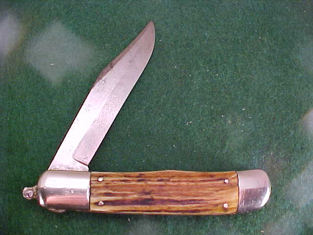

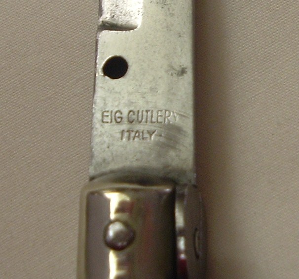

Here's an EIG CUTLERY picklock from the early 50's. It has a full brass liner which I'm told dates it.
Thanks,
wazu013
Thanks,
wazu013

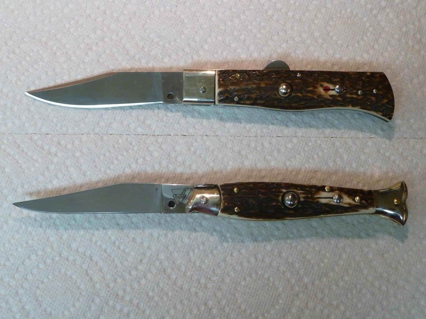

Great knife wazu!!

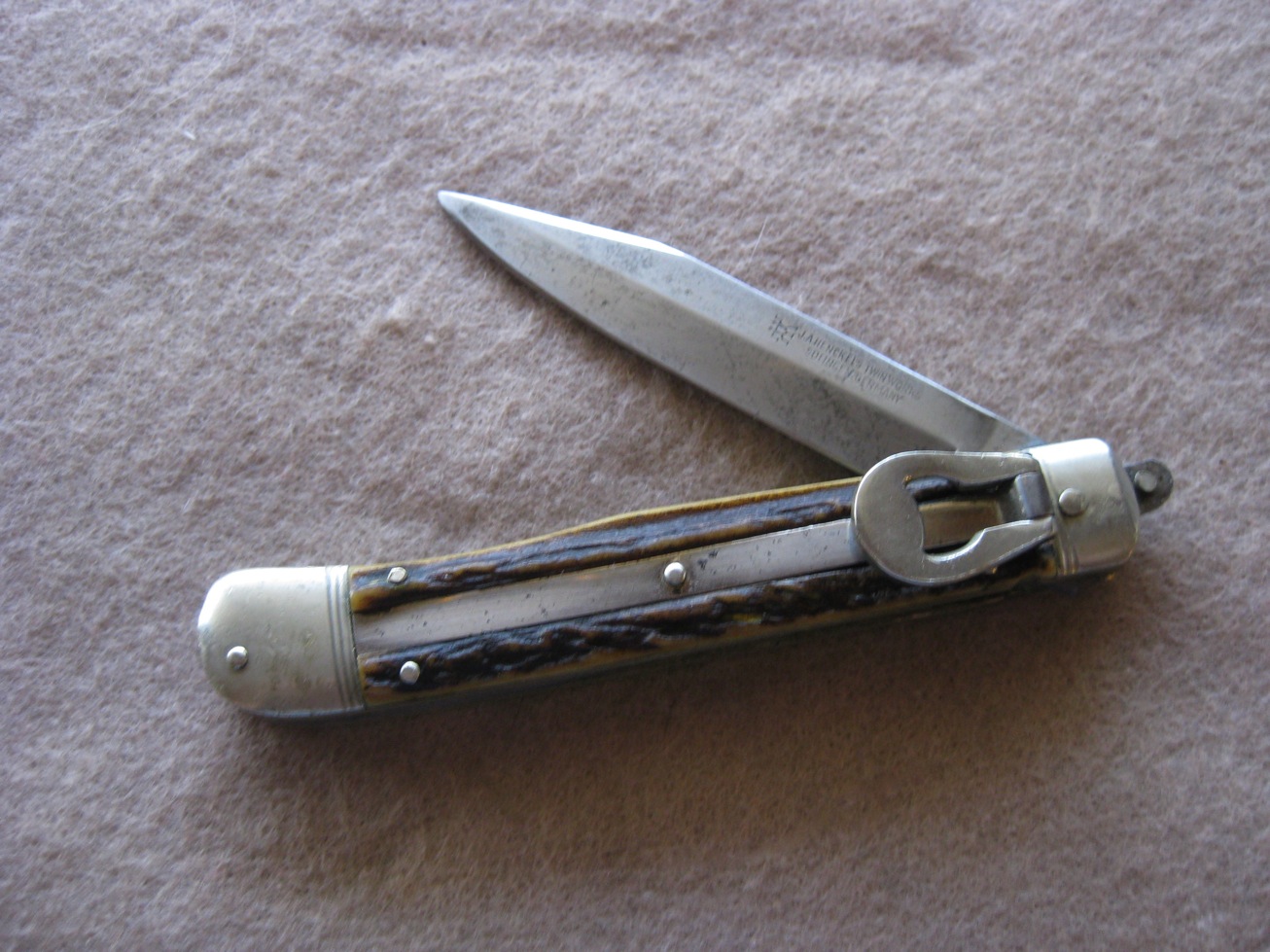

I have an older picklock also........again from MM.
Its shown here with an A.G. Campolin (top knife in pic).
IM
IM

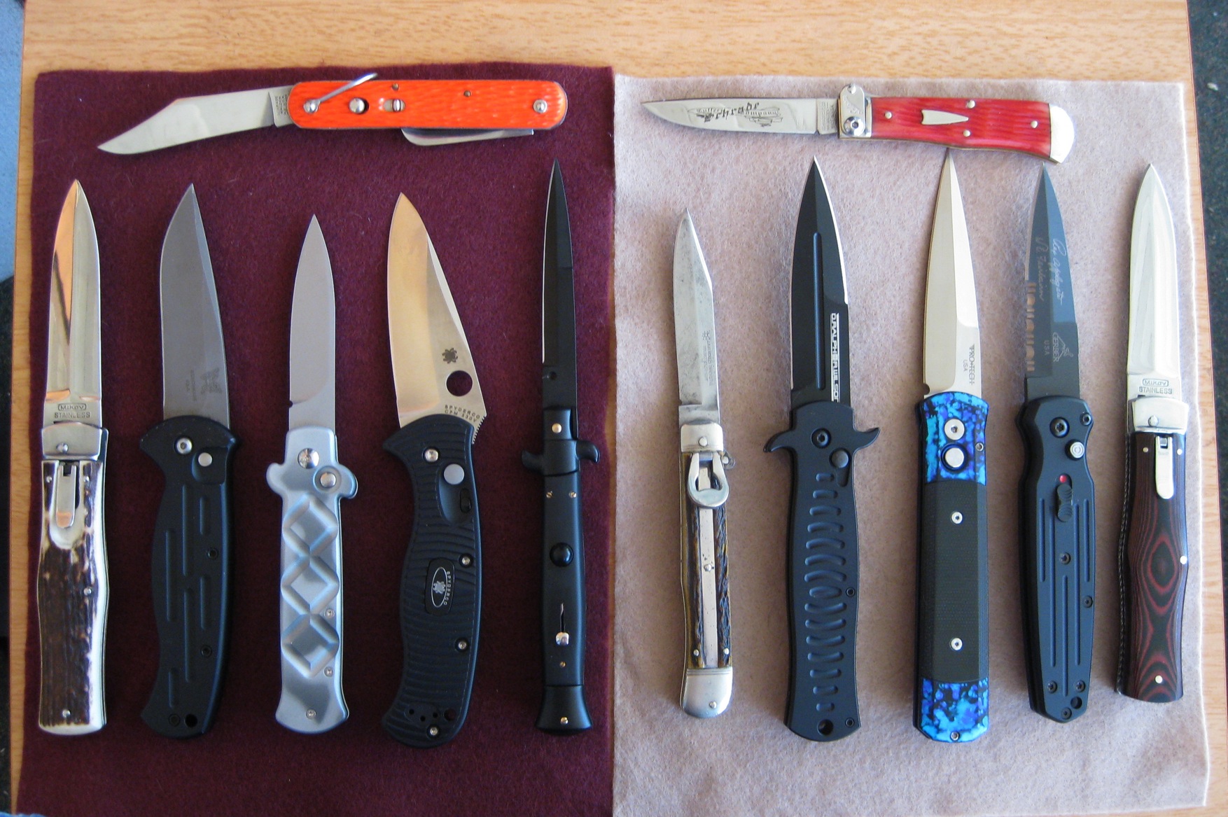

Heres the rest of the auto's that I have...
johnnierotten

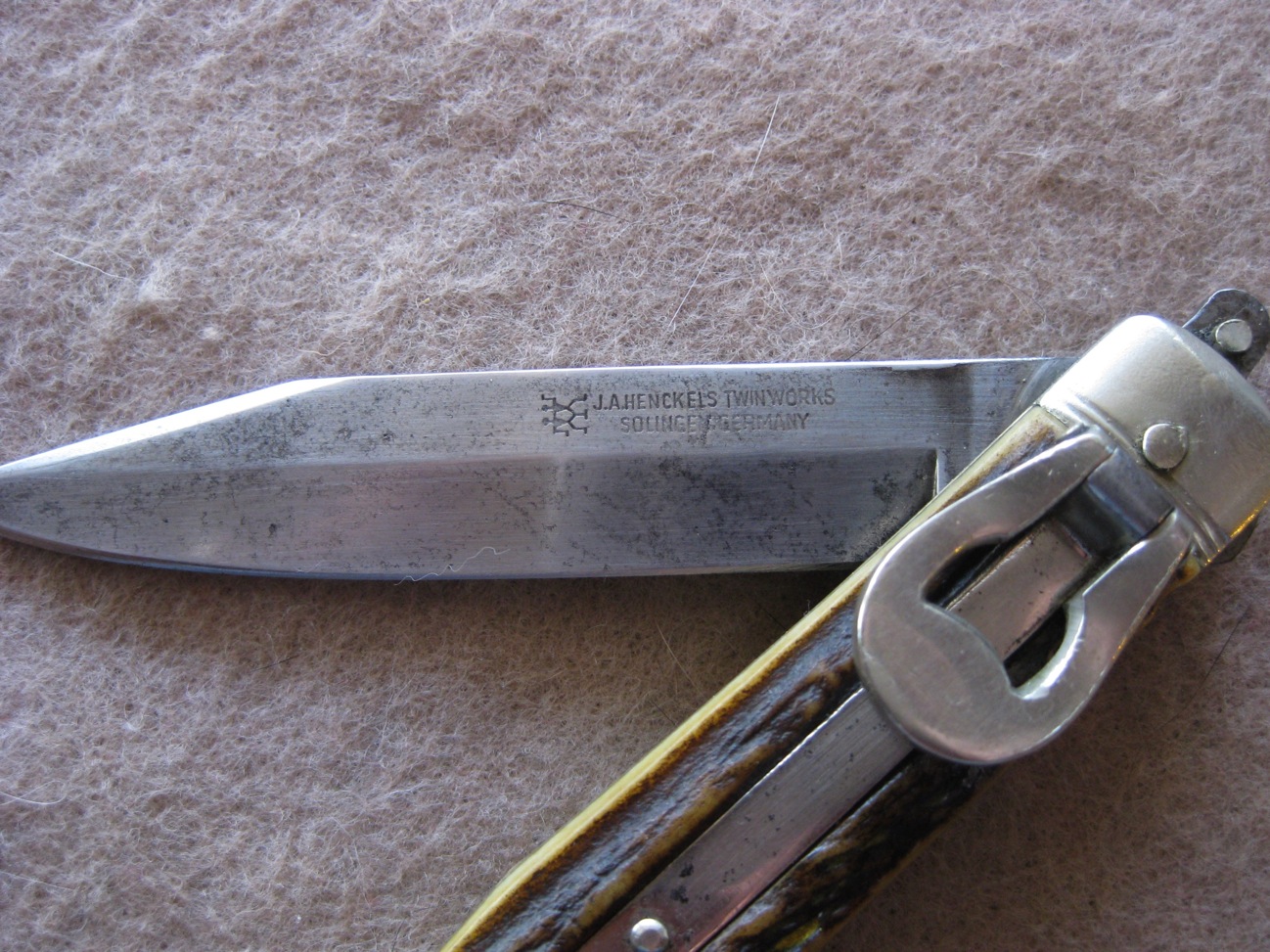

This qualify?

YES...I believe it does.
....that is simply beautiful!!
Looks a bit like my Henckels.
....but in better condition.
johnnierotten

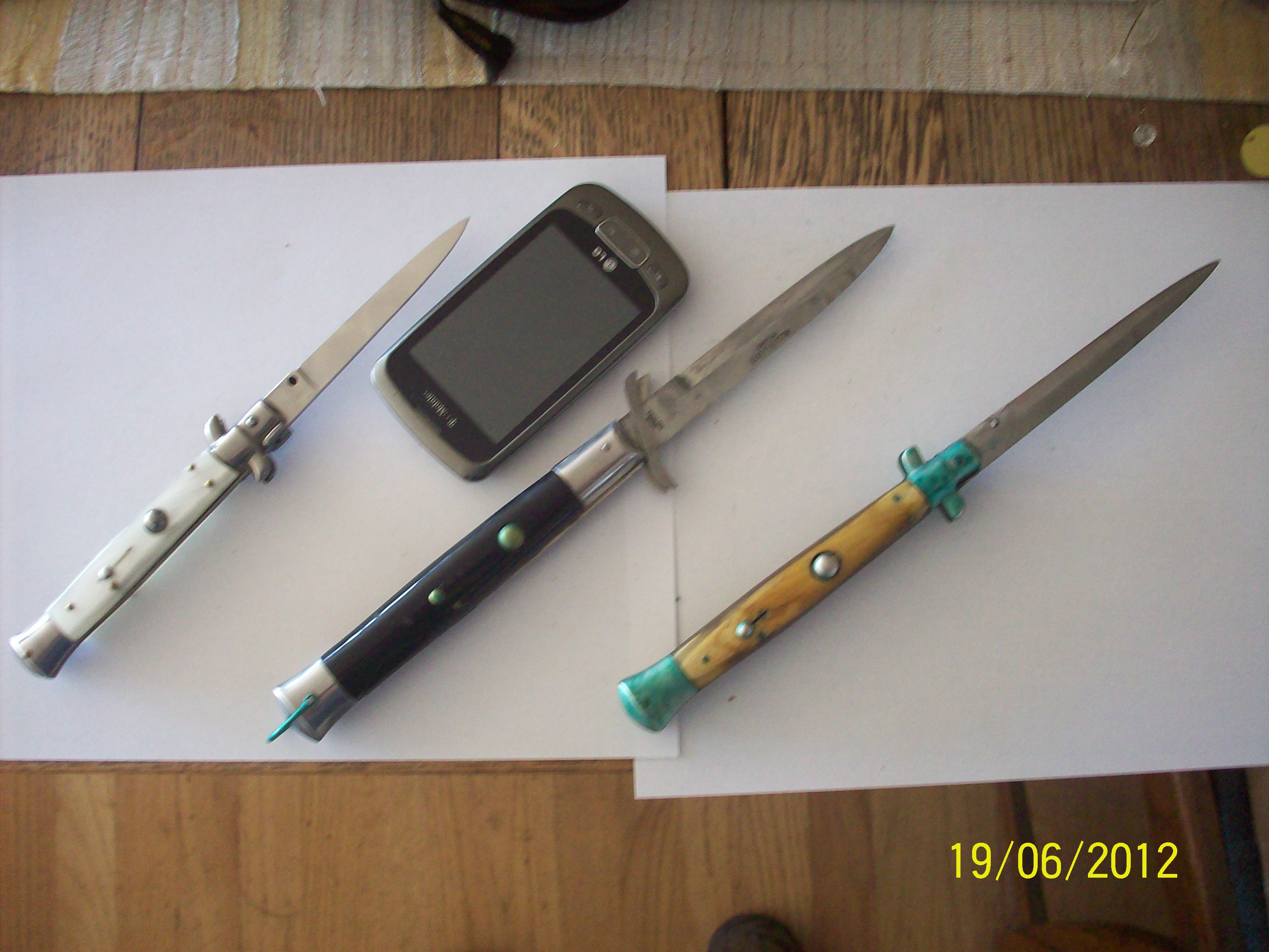

these are a few of mine.any ideas on age or values?

This will give you an idea of value on the Camillus paratroopers....
You will have to tell us what the stamps are on the others.
Tim
http://www.ebay.com/sch/i.html?_nkw=cam ... =1&_ipg=50
Tim
